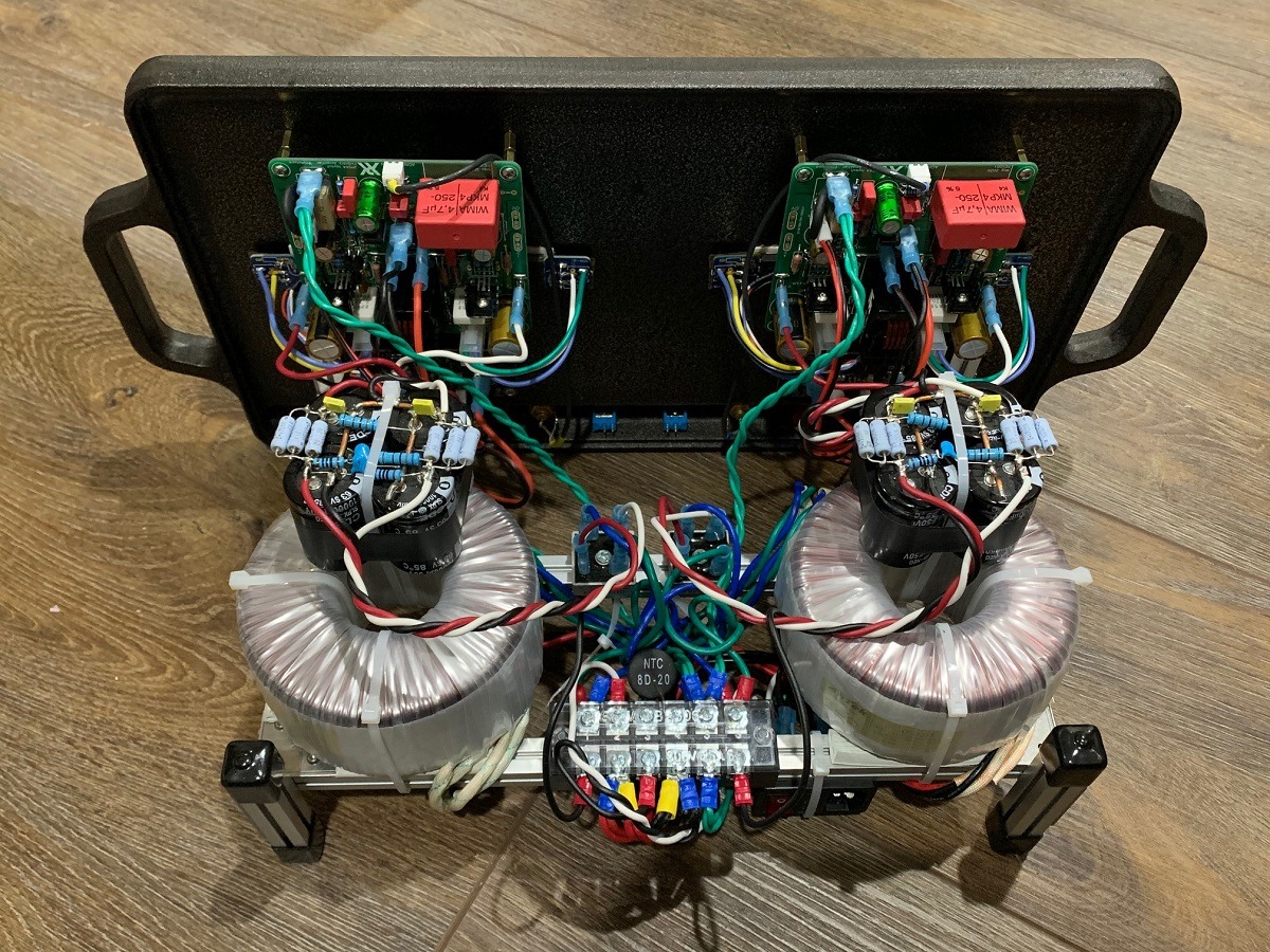

I finally got my garage mostly cleaned this weekend, all that's left is the workbench, maybe this coming weekend. Then I can finally tap some holes and finish up my FH9HVX. Going dual mono with 2x Antek AS-2238's that I've had waiting for quite some time now, an XRK SFP soft start, 2 All-Cee's boards, and a pair of X's SSR speaker protection with the instant off boards. One of the two amp FH9HVX board's is built up sans V123, V131, and V132, I've also built and tested an All-Cee's board. I tentatively plan to offboard them with flying leads and some of X's MOSFET snubber boards (the blue square ones). Would I be moving resistors R131 and R132 to the snubber boards?
I'm really looking forward to listening!
