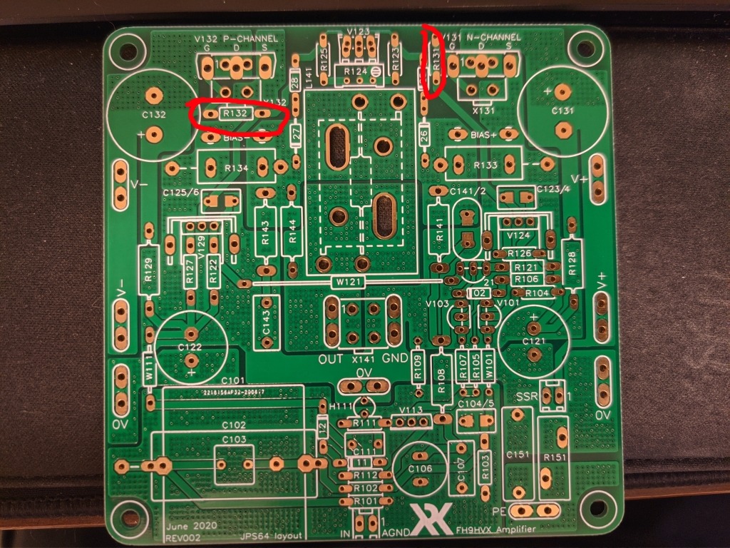

I feel like I must be missing something, probably something obvious. Pardon my ignorance in the following questions.
On the FH9HVX boards, current can't flow from V123 or V129 to V132's gate pin unless R132 is populated. If I move R131 and R132 to the snubber helper boards, do I put a jumper in place on the FH9HVX amp boards? On the blue MOSFET helper boards, pin 3 of the Molex connector has continuity (red line) to the gate pin on the MOSFETs, and I assume the snubber resistor would go where I drew the yellow line. Would the snubber resistor even do anything at this point?
I attached pictures to help visualize what I am thinking. On the picture of the amp boards I circled the two resistors I assume are the snubbers.
Sorry about that, I think you have a good point. The blue snubber board provides points to install an RC snubber between the gate and Drain but the gate stopper resistor needs to go on the main PCB. The snubber boards for the Alpha Nirvana (tombstone shaped) are different and have gate stoppers near the pins.
So just install the 220R gate stopper on the main PCB and connect wires to the snubber board.

No worries! Thanks for the reply. I plan to keep the wires quite short and mostly only using the snubber boards so I have a little breathing room with my hole tapping.
Just make sure it’s a high quality non inductive resistor. Go with a slightly different value if needed. 12ohms or 8.2ohms etc it’s all ok as most of signal goes through the inductor.

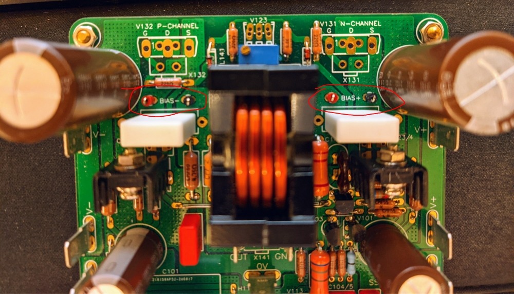

Where on the PCB do the test points (X1031-X1034) go?
The pads for bias.
