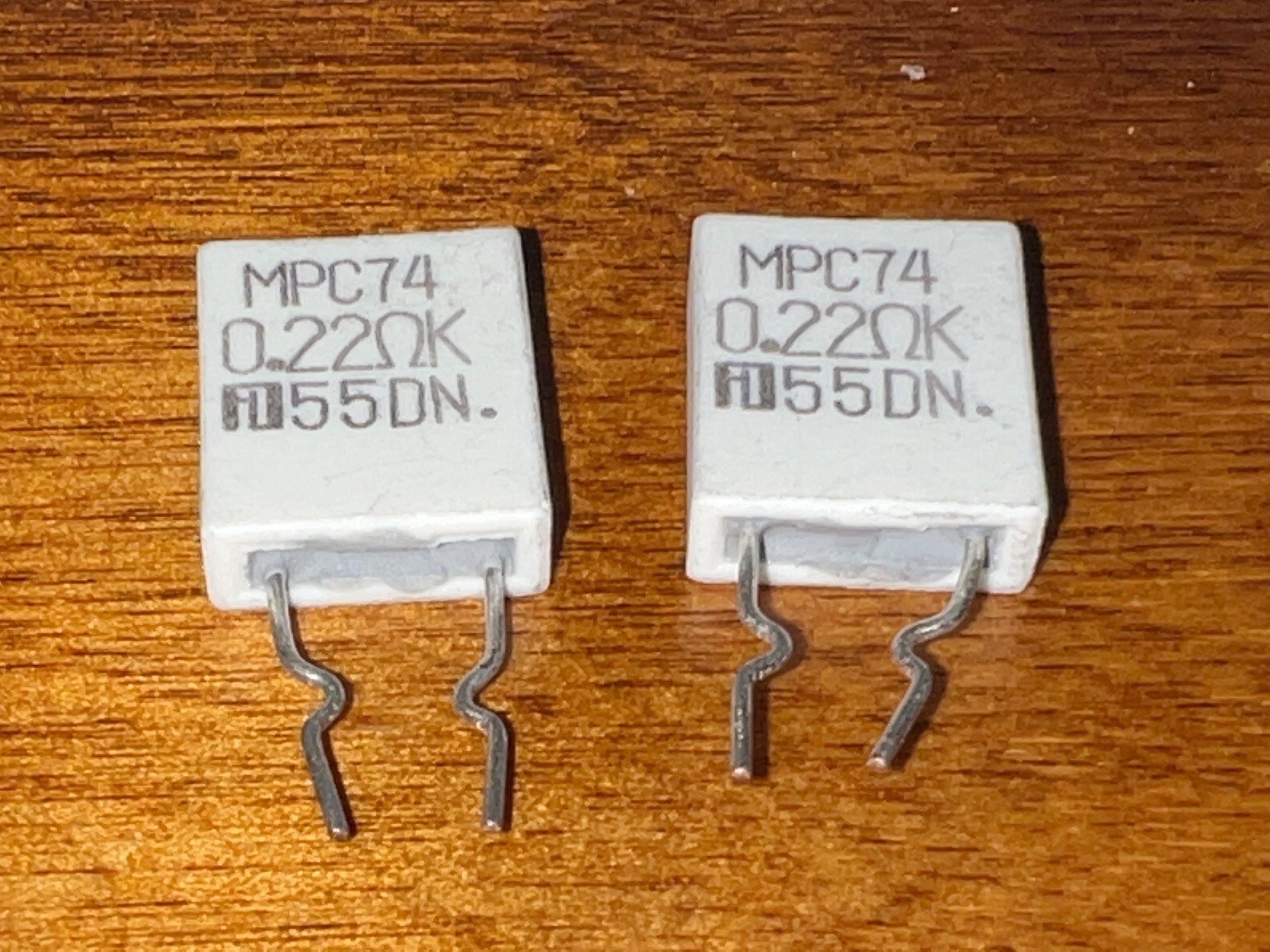

I have most of the components needed for this amp, but finding them in my drawers takes a lot of time.
And after that I try to remember when and where I bought them from ,
very annoying when I question the authenticity of some stuff I don't remember about.
Like the resistors in this picture.

Those look legit to me - the cheap ones from eBay/Aliexpress generally don't have the kink. Those pictured I have only purchased from Mouser or DK.I have most of the components needed for this amp, but finding them in my drawers takes a lot of time.

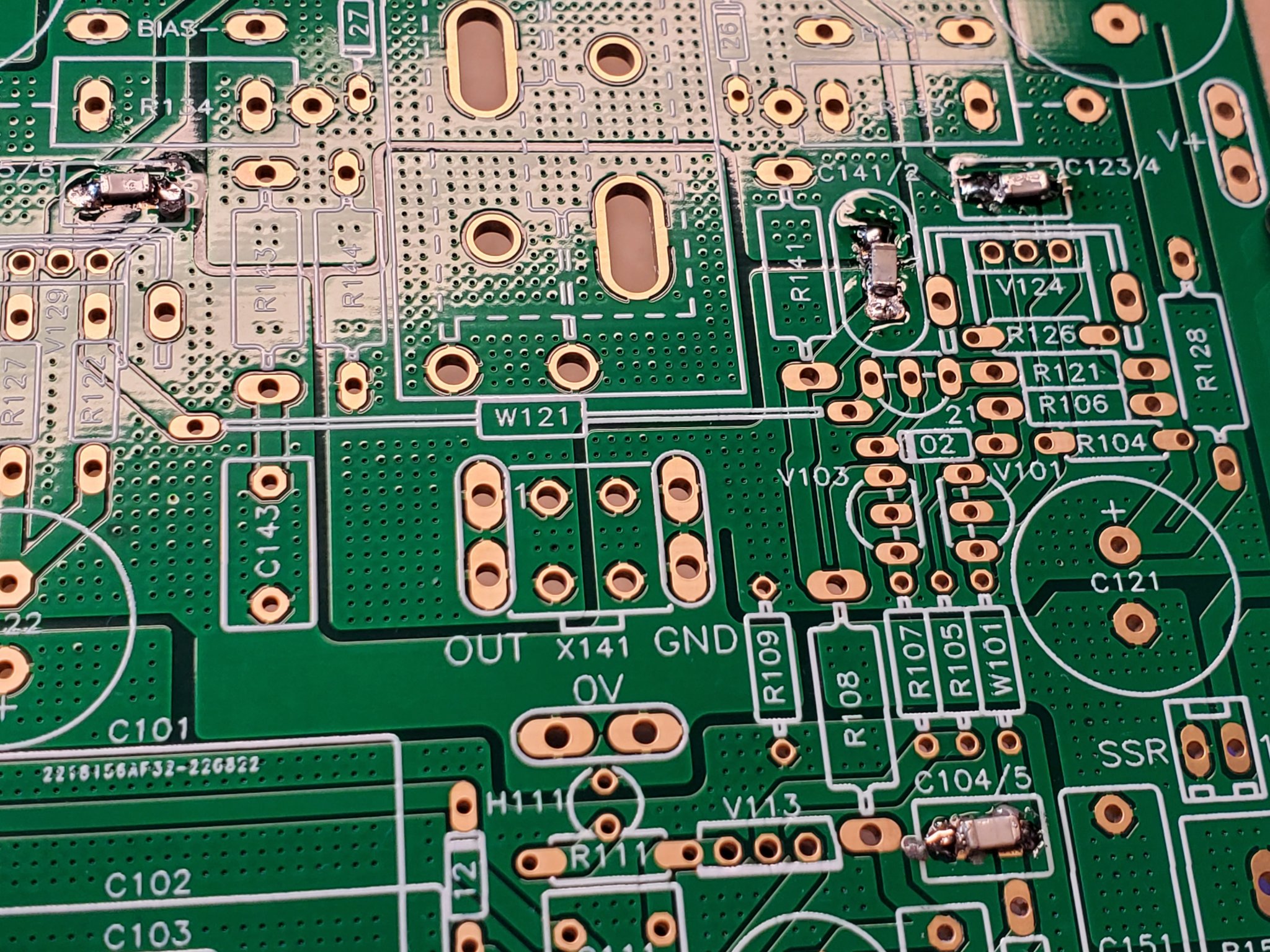

Hey Forum members,
So I started on my FH9HVX project. My first foray into SMD soldering was wildly unsuccessful. As much as it pains me to attach the following picture it's necessary if I'm going to get this right.
I applied solder paste before placing the components. I used a portable heat gun with the temp set to 301C and the airflow at 50%. Unfortunately, what I ended up with were 4 sets of cold solder joints. In a couple cases the components didn't even adhere to the pcb.
Not to be deterred, I warmed up my soldering iron to 350C and attempted to resolder the SMD's by that method. I believe in that case my temp. may have been too high.
I am an older gentleman with aging eyes and some fine motor tremors which certainly didn't help. I think if I am going to continue working with SMD's I may have to devise a home-built reflow oven where everything can be set-up before heat is applied.
Now, for those of you who have hung in there with my lengthy post, my questions; do you think I should just start over with a new pcb? Since only 4 components have been soldered does it pay to try testing my connections for continuity?(I know this is usually a non-starter due to the multiple interconnecting circuits).
Finally, any tips on SMD soldering that have worked for you? Thank you in advance for your knowledge and time.
Dave M.

@UncleMud I usually have better luck cleaning the board, and attach SMD components one at a time. I place a small dollop of water-wash solder paste on the two pads, place the part with tweezers, hold in place with tweezers, and then touch with the solder iron at 325-350 just long enough to melt the solder. i've had pretty good luck with that method. I would use solder braid to remove the solder on those 4 parts, then use solder iron to move the parts off the pads, clean pads with solder braid and start over. If you overheat the part, no problem, use a new part. I usually order a few extra of SMD parts just for that reason, not to mention the ones get dropped and not found.
