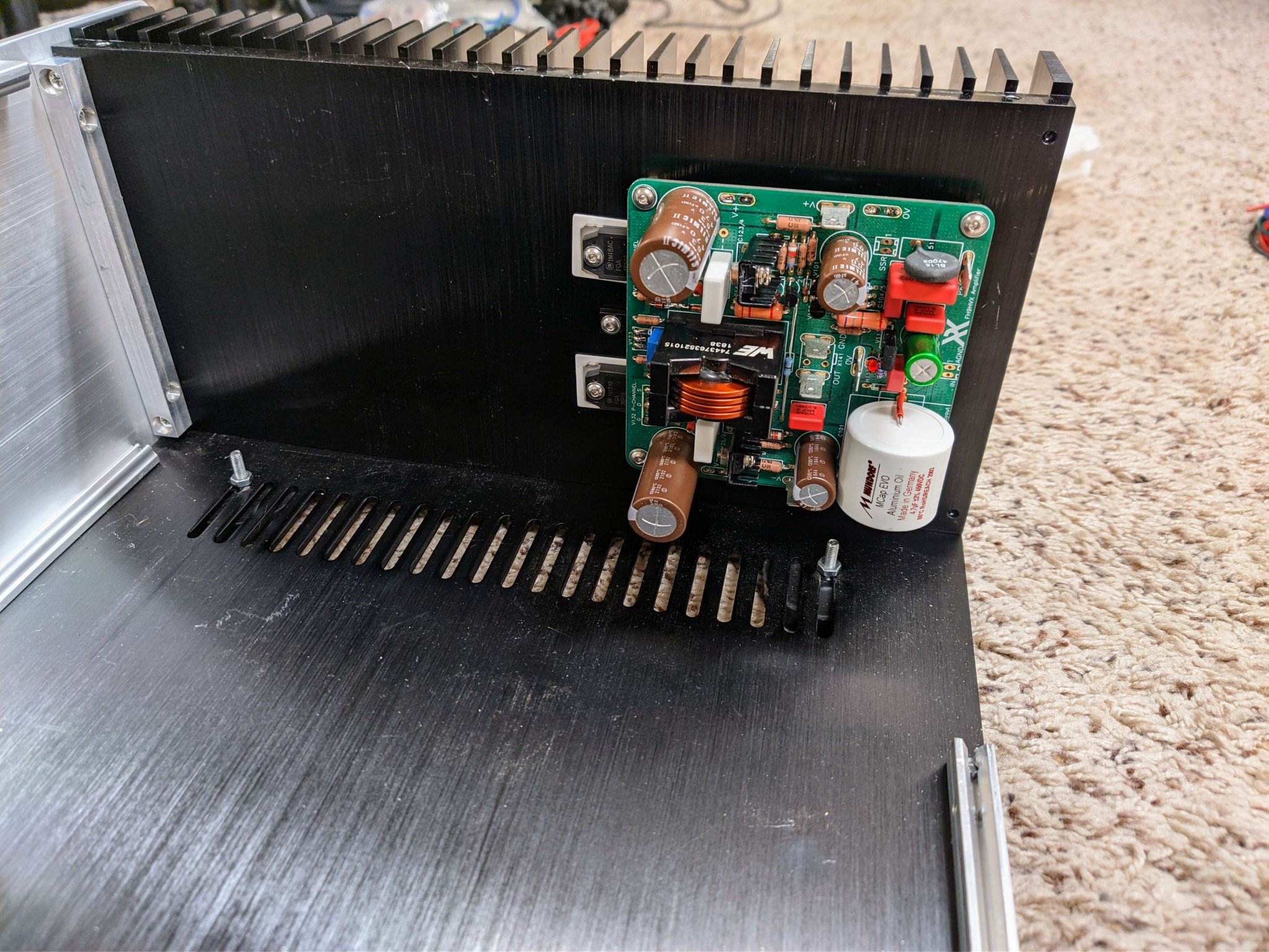

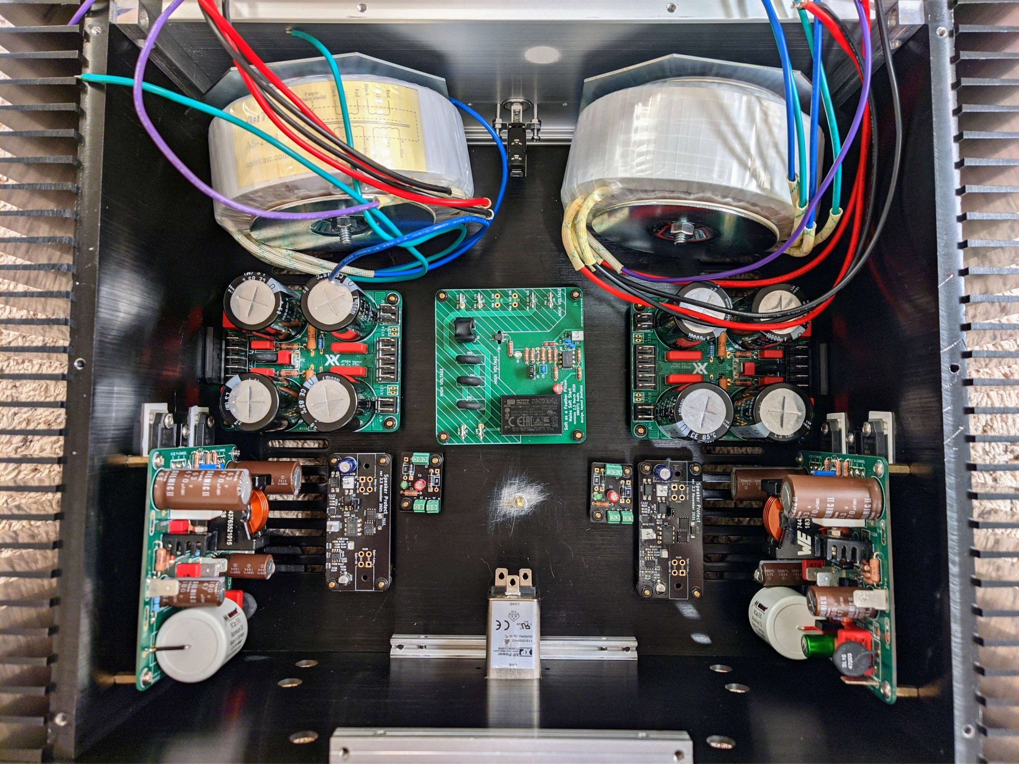

About a year or more ago I tried to tap an M3 hole and failed miserably. Following some guidance from vunce and gary s, I went at it today and who knew that if you do it properly, it's actually kind of easy. I would say the hardest part is cleaning up the tap magic. It's just a dry fit with no thermal paste for now as I have to assemble the other board. Going with dual antek AS-2238's, dual All Cee's, an SFP, a pair of X's SSR speaker protection boards. I've had everything I need down to way too many molex connectors sitting here for a long time now, so it's time I get this bad boy going.

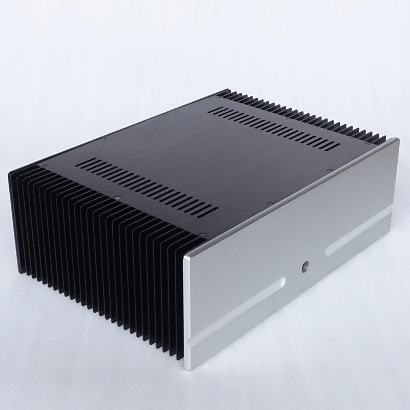

The case is from aliexpress, exterior dimensions are 430*311*150mm, interior 330*300*142mm, heatsinks are 300*145*50mm. Originally the plan was for a similar chassis but only 120mm in height, however after deciding to go dual mono, I just don't see a way to make that happen, I'll use the shorter chassis for something else.
To power the SSR boards I'm going to use a small dedicated transformer, I was thinking an AN-0112 (10VA, dual 12VAC secondary). Will that be enough current for the SSR boards X? Or will I need to bump it up to an AN-0212 (25VA, dual 12VAC secondary)?

Nice work! 12v is not enough as you will need 15v trafo for the SSR as you need 18vdc minimum since the voltage regulator on board needs 3v above 15v. It’s easy to connect the ultra low capacitance PSU board to one of the main rail trafo secondaries vs getting a separate trafo. The chassis looks great.
Good luck!
You are dissipating 14W per channel at idle (116mA x 60v x 2). That’s not an unreasonable value for the size of the heatsinks you have. But if you plan at playing very loud higher powers for extended time, it may get warm. But 55C is a long ways to go from maybe 32C idle. I would use it and spend some time playing music at levels you like and monitor temp. Change to bigger heatsinks only if it’s a problem. Better to leave trafo alone and drop bias current to 80mA. Should still sound very good and reduce idle dissipation to 10W per channel and feel cooler.

Yes, at 55C you can’t touch your hestsinks more than 2 seconds without feeling great discomfort. If you touch the sensitive skin of your inner fore arm, you may even get a burn. It’s best to keep heatsinks below 50C or below but technically they can be as hot as 55C. The mosfet body temp is 85C or lower is a good temp to aim for.

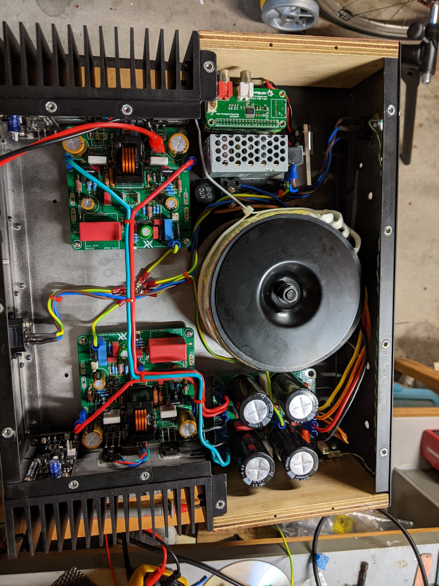

I am slow yes, but chipping away at things. Just finished up getting all the boards mounted, this week I can start the wiring.
Unless I am wrong, I should turn the bias pots all the way counter clockwise, short inputs, test first with a dim bulb tester, if that passes I should be ok to start biasing. I do have a 5A variac, is there a guide I can read somewhere on how I test an amp with that?
Reactions: xrk971 and UncleMud
Very nice mate. What size are those trafo?
