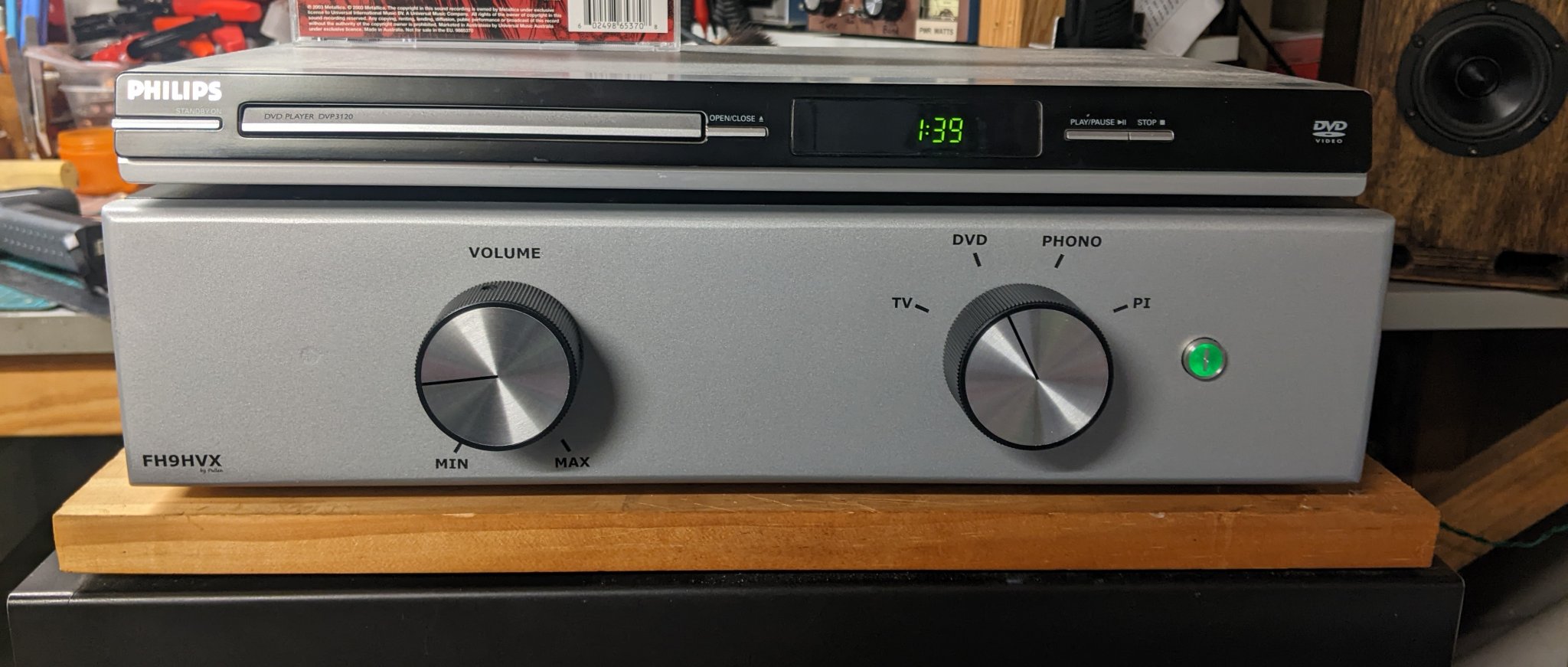

Finished, still on the bench running RS100s, need the paint to harden a bit before moving to the living room an onto the 10f/rs225 Thor's hammers.
Sounding great so far, I can just tell this amp has some punch behind it...
Cheers
Nik.
Very nice work Nik! I see you have volume and input selectors.
What rail voltages and bias current did you end up going at and what is ideal temp of the heatsinks?
Cool.
Cool.

I settled on 23mv/105ma bias and 60v rail, heatsinks sitting at 38'c idle and about 40 playing at low levels. Mind you this is with 28'c ambient, so I'm happy with that. I'll run it a while like this then maybe try 26mv...
The labels are laser printed water slide decals, like those you get with airfix models, I can't remember where I got them but it is just an A4 sheet and I drew them up in Inkscape and printed, cutout with scalpel, soak in water and slide into place, dab dry carefully with q-tip...
X, thanks again for all your efforts in designing this amp and the speakers too, it is really a fantastic combo and I am thoroughly chuffed with my setup now, don't think there is anything I would change.

Nice setup Nik.
The FH9HVX is an amp I could live with and be happy if it was the only one I had.
Remind me which speakers you built? Was it 10F/RS225 FAST TL?
