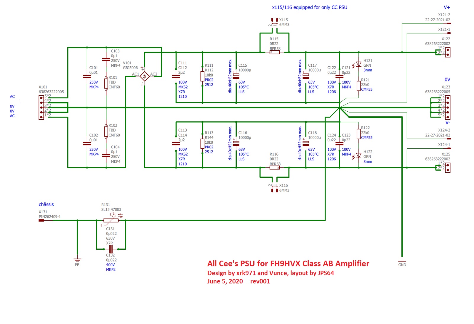

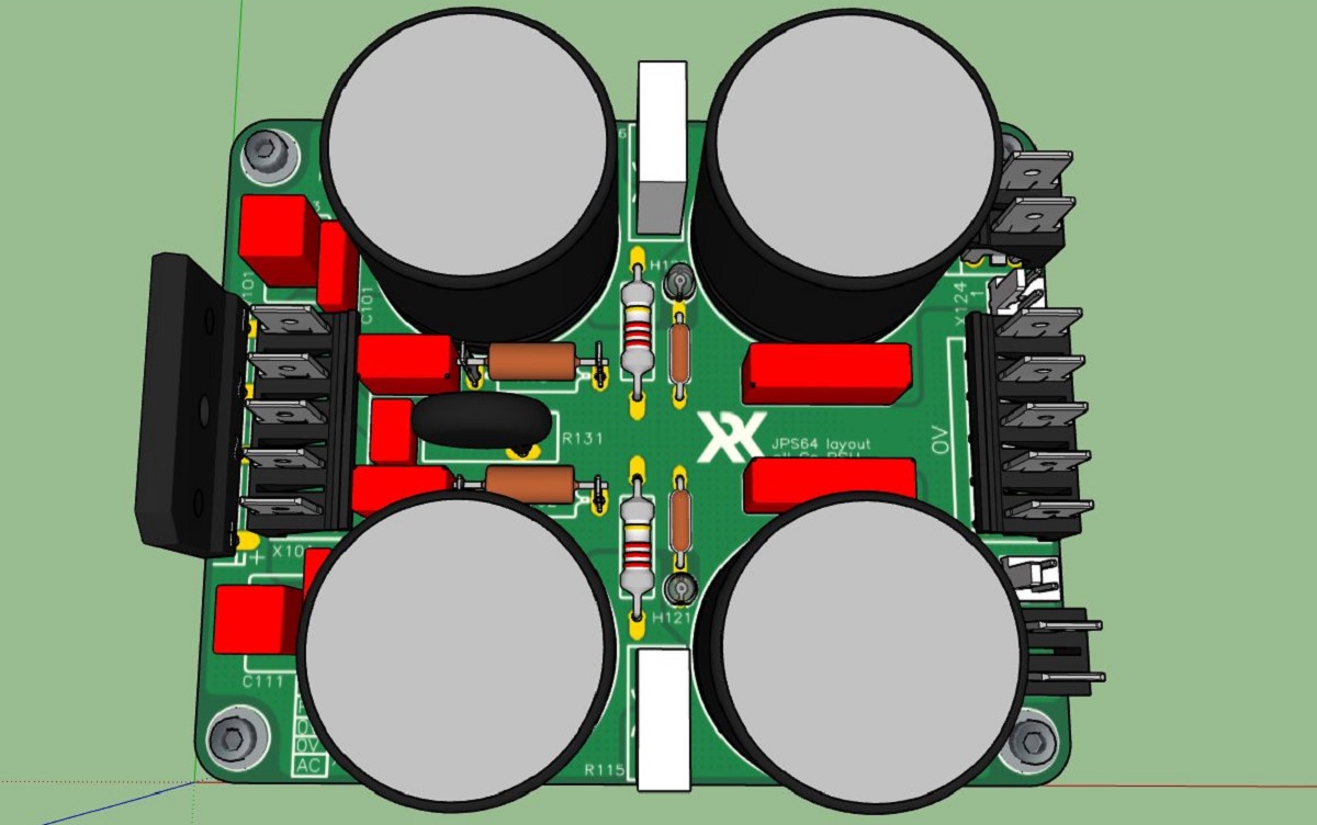

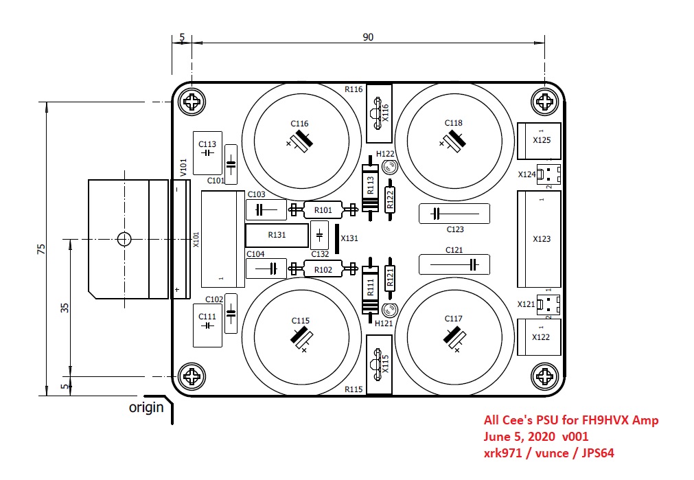

Hi Folks,
Here is the new ultra compact "All Cee's" PSU that JPS64, Vunce and myself have come up with to pair with the FH9HVX (or any other 100w Class AB amp with PSU rails under 63v). I will be offering this as a pre-order on my shop soon. These will be 80mm x 100mm x 1.6mm boards with 2oz copper and ENIG finish. Pricing will be $20 ea - the same as a single FH9HVX as it is about the same size and manufacturing.
attachment.php
The All Cee's PSU features up to 40,000uF of bulk capacitance at up to 63vwdc. You can install a 0.22R to make it a CRC vs a CC PSU if you desire even lower ripple. Tests show that 20,000uF per rail sounds best in the FH9HVX with no hint of audible hum and a huge reserve for bass impact. Other features include provision for a snubber on the trafo input, bleed resistors, film bypass caps, LED charge indicators, and an on-board NTC ground loop breaker for connection to the chassis/protective earth ground. You can use all Faston tabs or the alternative Wurth 0.250in tab arrays which make it easier to install and keep aligned. All of this is a compact 80mm x 100mm package that will be easy install inside your chassis. If you are running your FH9HVX below 50v rails, you have enough room to install 15,000uF caps for even better performance. The caps in the BOM have been selected for the high ripple current to enable continuous higher power operation if needed. For higher power operation, it is advised to mount the bridge underhung and bolted to a metal floor plate for heatsinking.
Attached are schematics, a BOM, and stuffing diagram in the zip file.
attachment.php
attachment.php
This is a great no-nonsense simple PSU for all types of Class AB amps with 63v rails.
Thank you to JPS64 for another superb layout. :cheers:

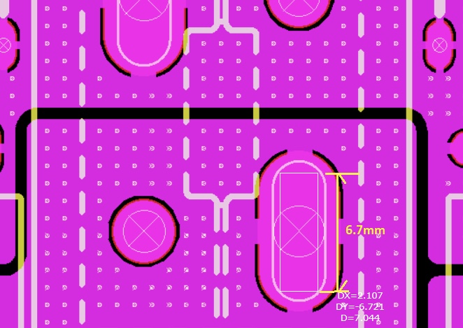

Hi Folks,
An update on PCBs. I went through the actual Gerber files carefully and found a small interference fit on the through hole slots for the inductor. JPS64 is fixing that now but it’s adding a few more days of work. But we will get better boards as a result.
Thanks for your patience.
X
Inductor wire is 2.0mm x7.0mm rectangle and we have 6.7mm long slot.
