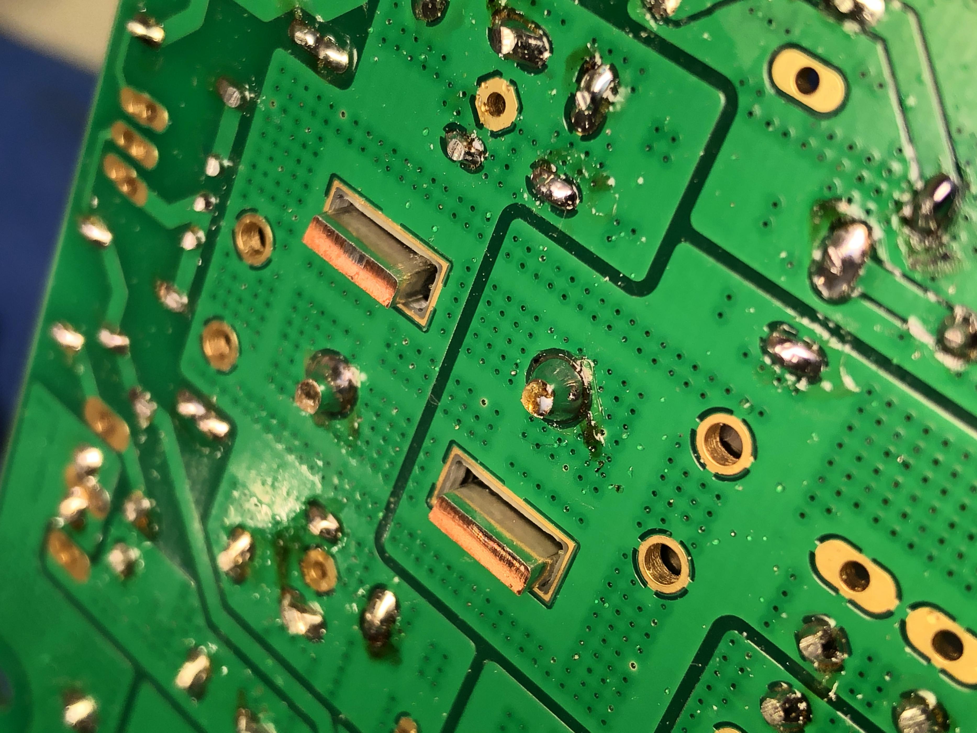

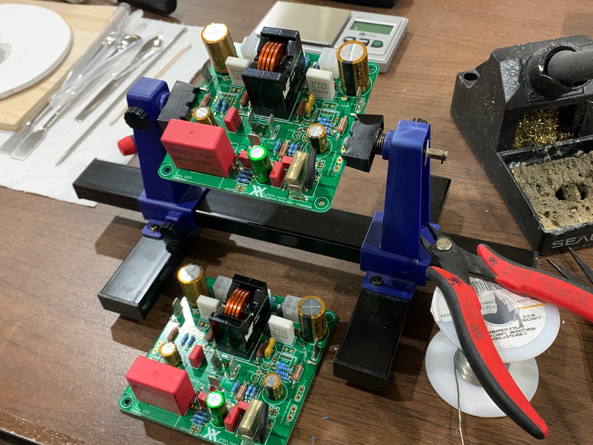

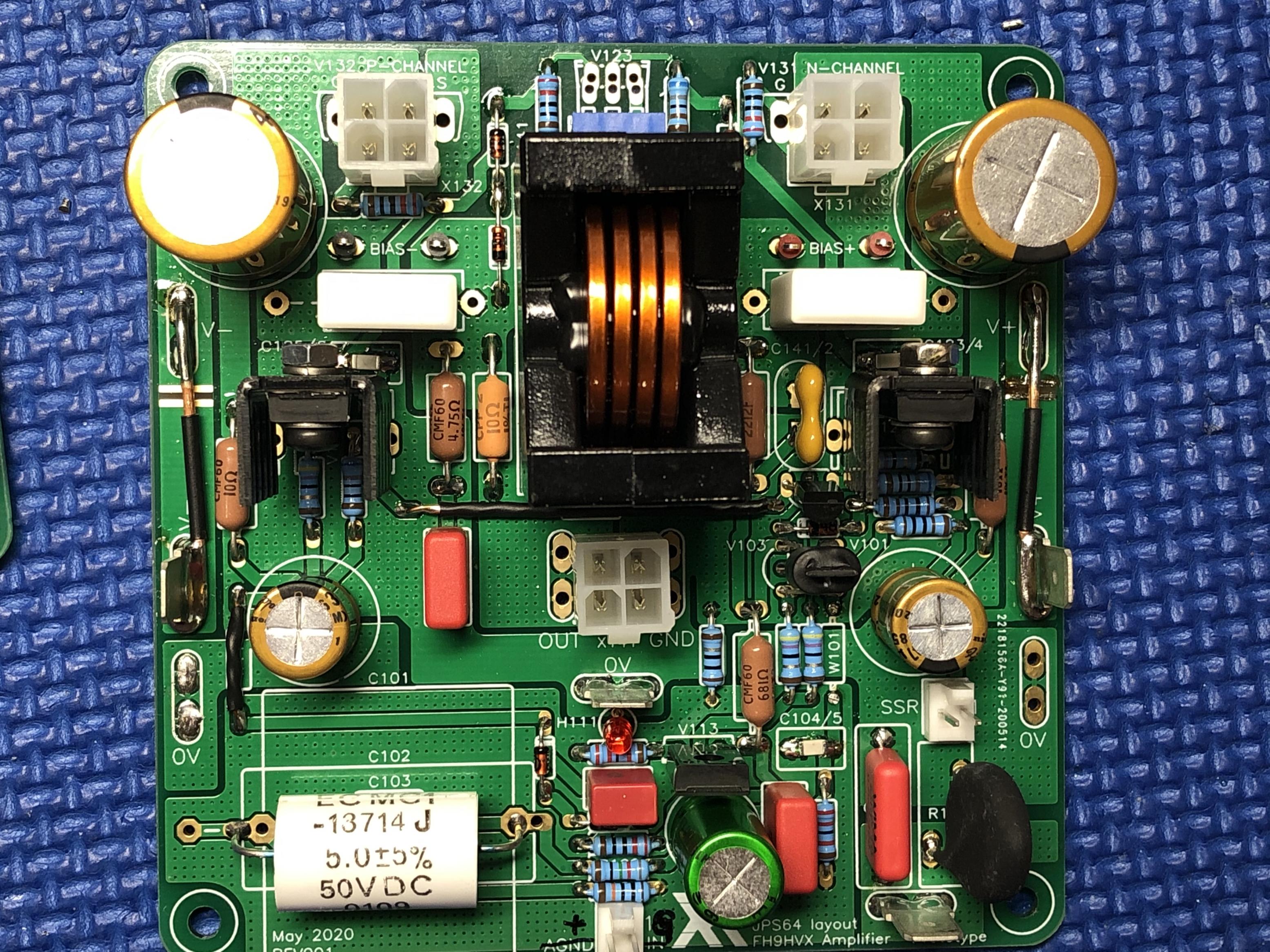

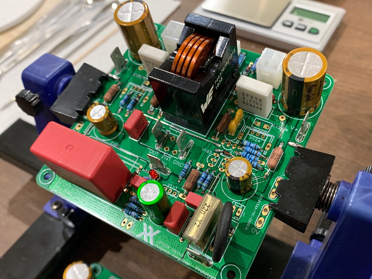

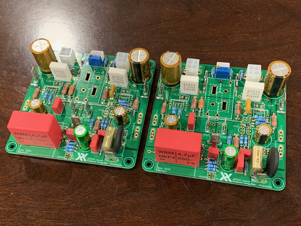

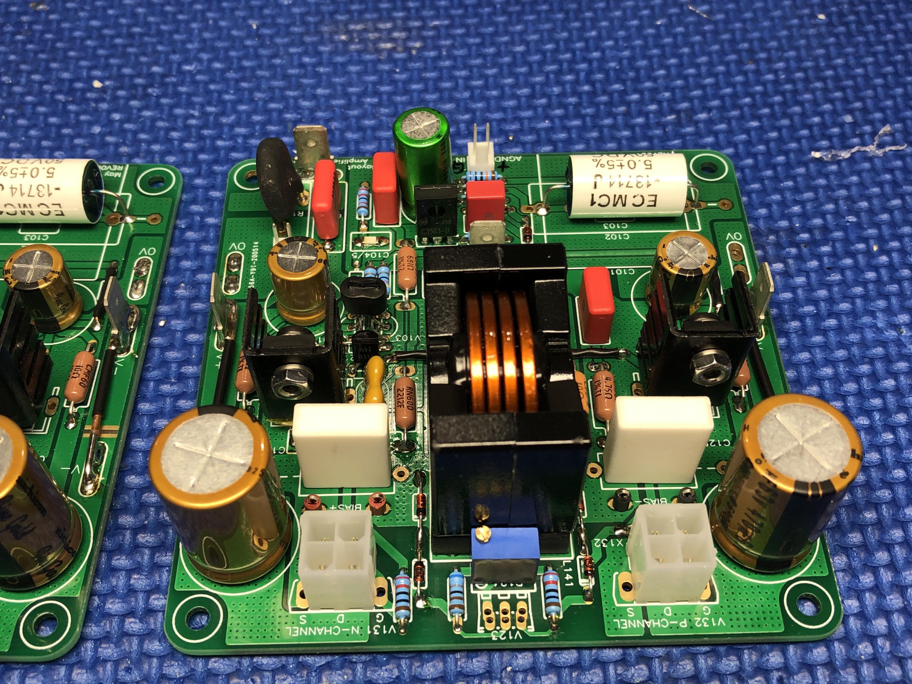

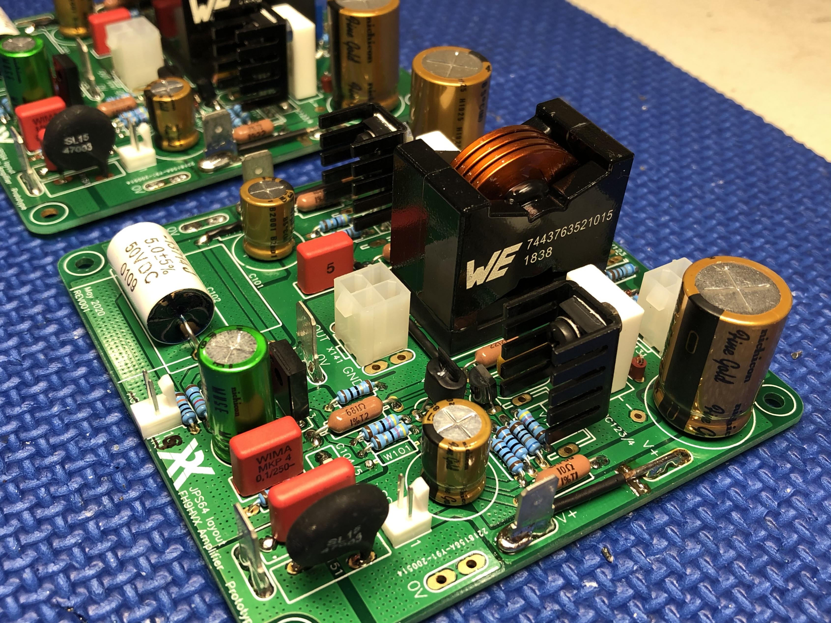

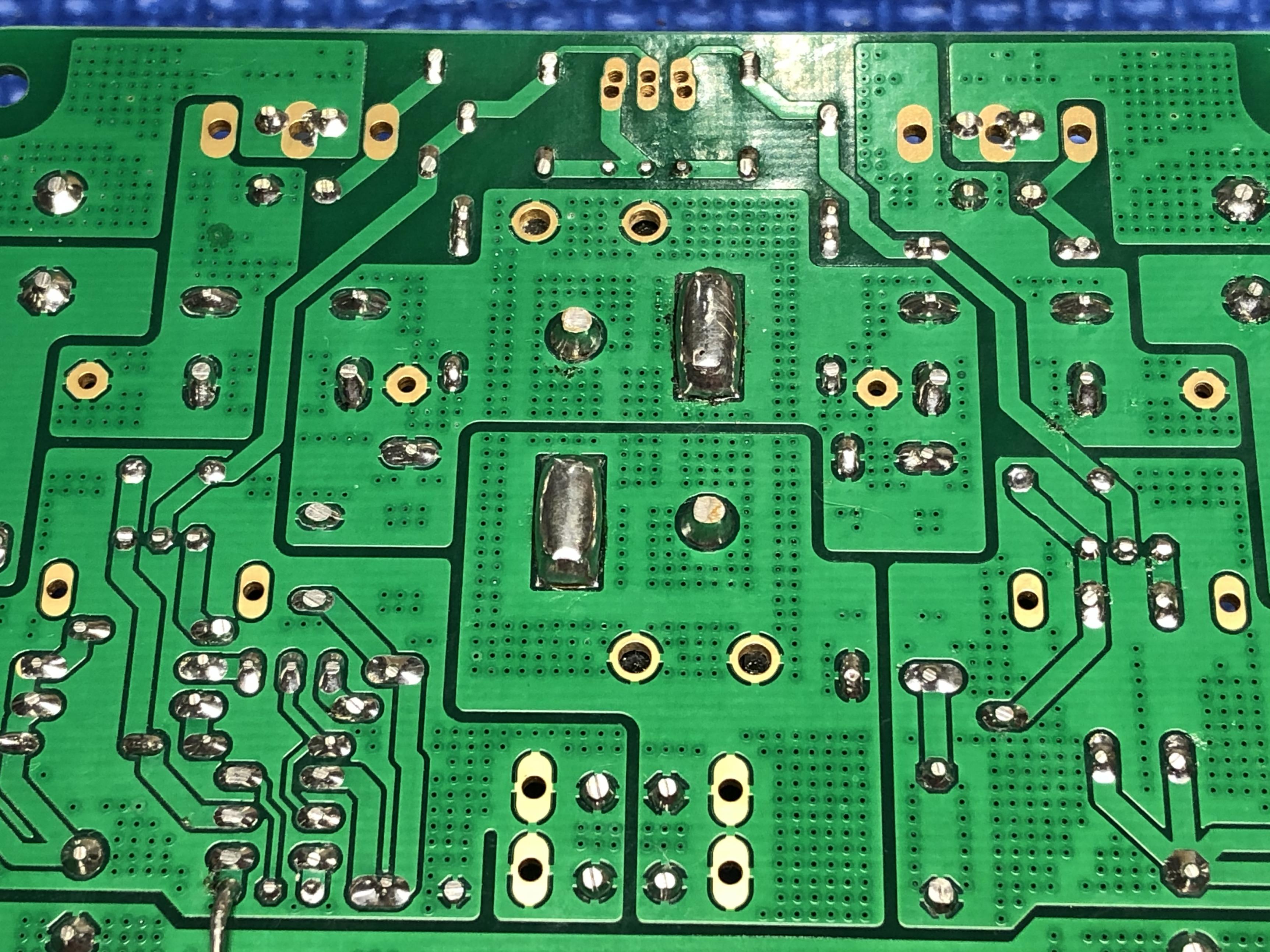

FH9HVX boards are completed! Soldering those Würth inductors was not for the faint of heart. The massive rectangular conductor required my iron and hot air pencil for SMD work at the same time to get enough heat for the solder to flow nicely. I’d recommend winding your own inductor if you don’t have the heating capability.
The step is making the flying lead Mosfet harnesses and powering up 🙂
Very nice work, Vunce! Thanks for warning us about the heating requirements to flow solder on 2 gauge rectangular copper wire! 🙂

How about one of those small kitchen blowtorches? The flame can be adjusted to a fine point....
Sorry if this has already been discussed - if the flying lead MOSFET connections are chosen, shouldn't the gate stop resistors be soldered directly to the gate terminals to avoid oscillation?
Good idea!
I would have tried that if I had one.
We will find out if moving/adding parts directly to the remote mounted Mosfets is needed when we power up.

Could not resist some glamor shots with the big Wurth! I have a new desk level workbench with lots of space now - much nicer to work on. Also in same room as my 10F/RS225 TL's.

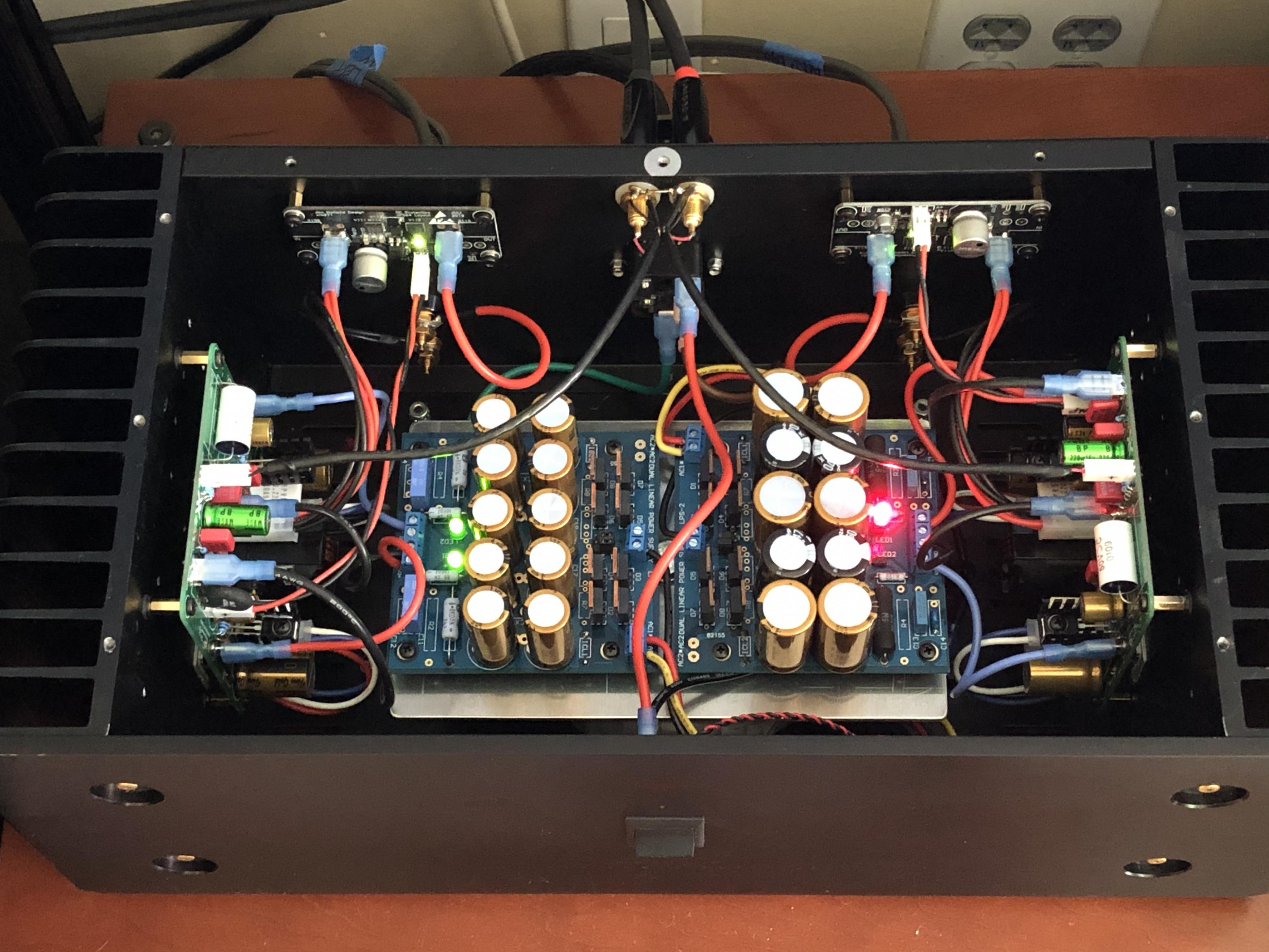

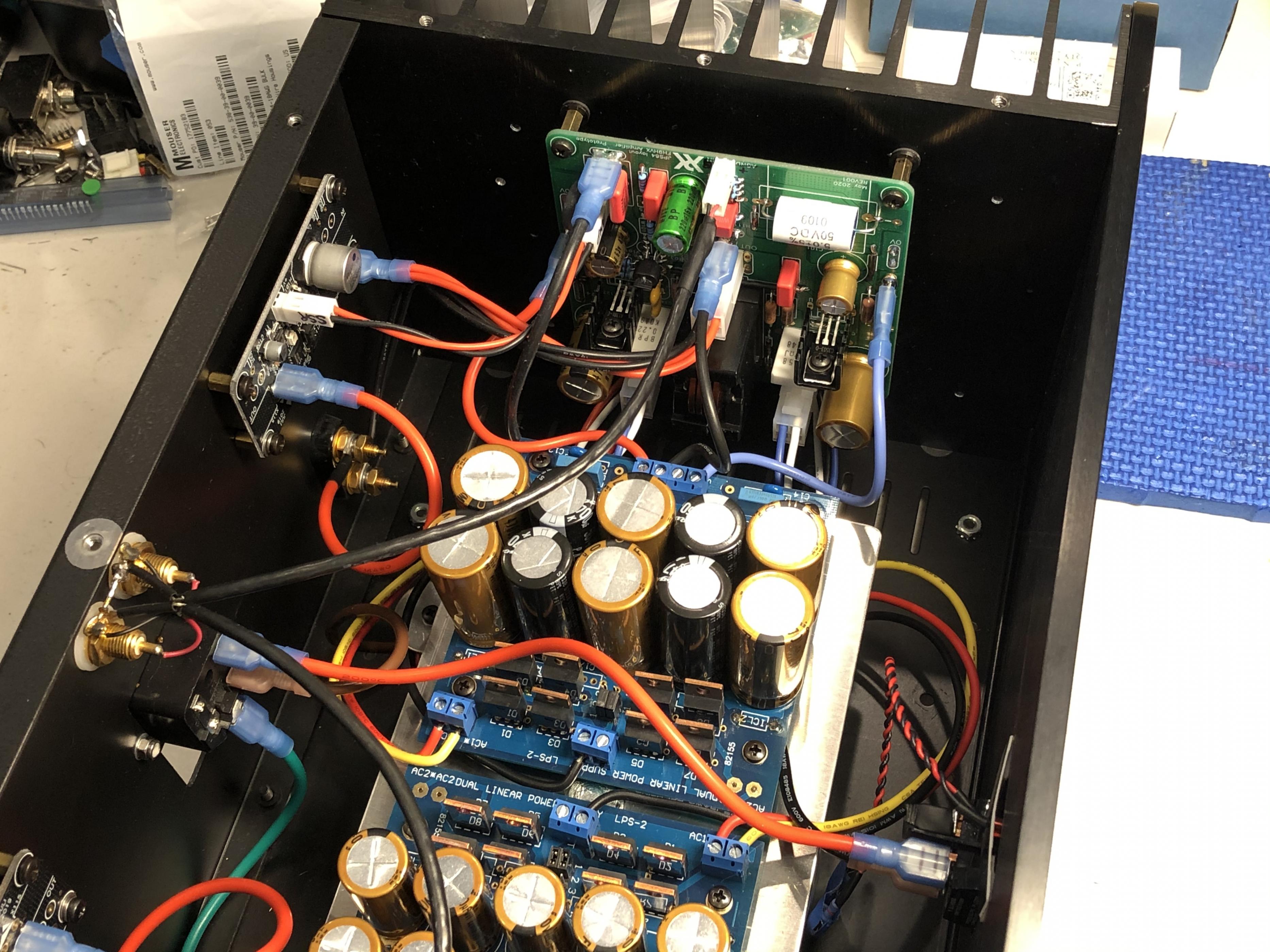

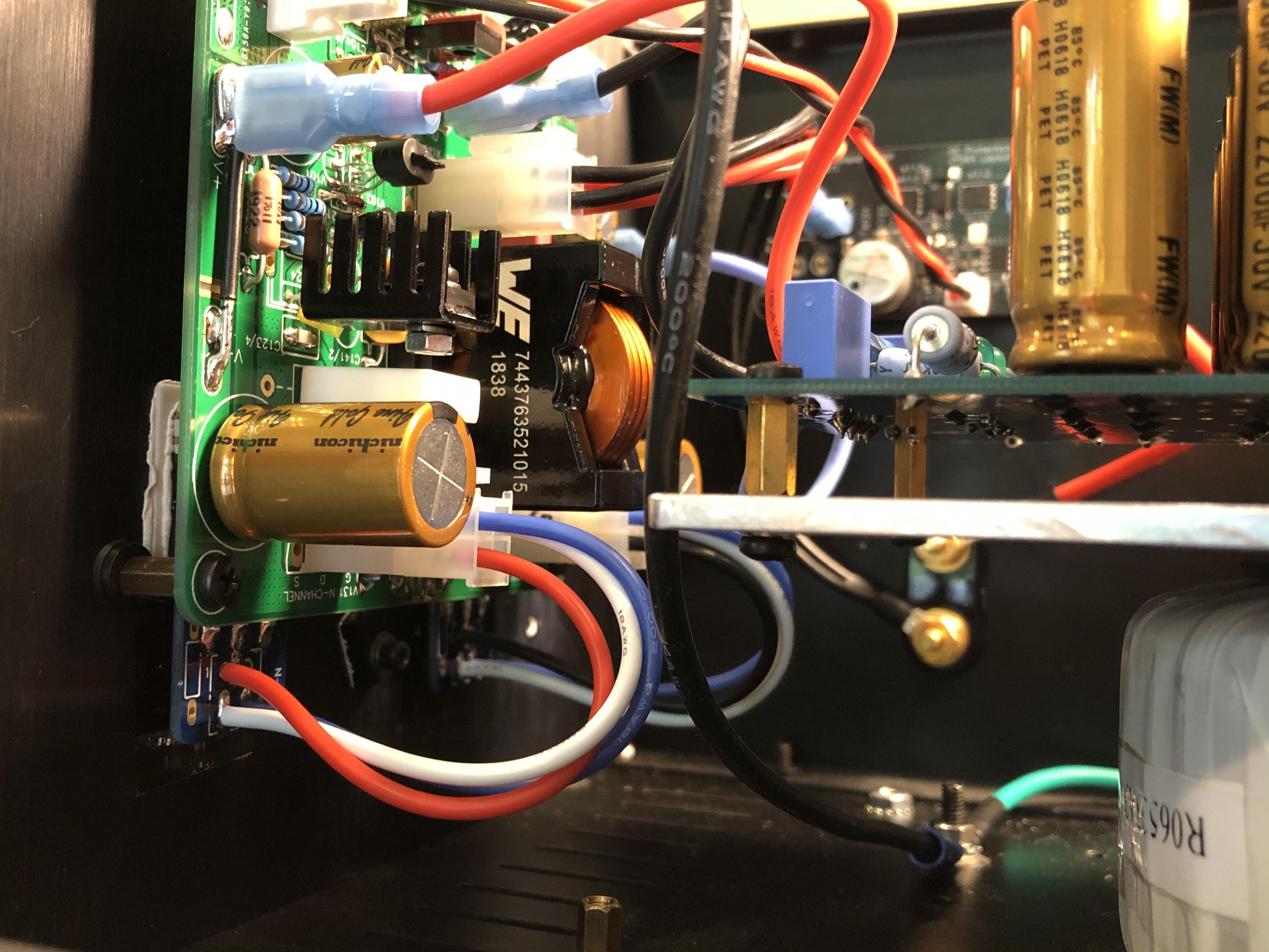

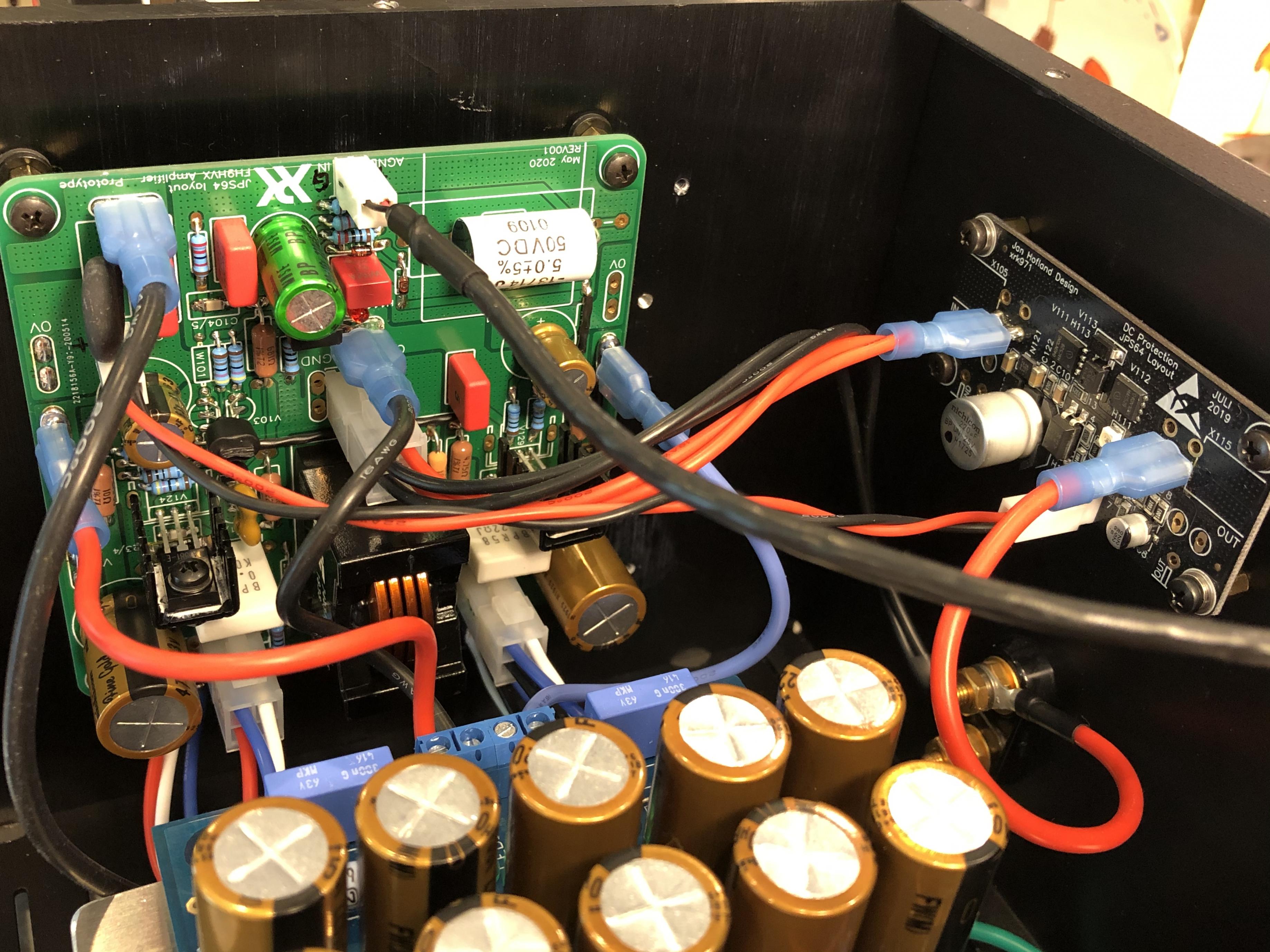

More FH9HVX progress!
Boards were successfully powered up without any puffs of the dreaded black smoke 😀
I used the same chassis I had the FH9 development boards in so the install went smoothly. Just needed to drill/tap 12 holes and reconfigure some wiring.
Biased at 150mA and dc offset is a minuscule 0mV - 4mV for both channels.
The amplifier behaves very nicely so far, just want to check with the Oscope for any behind the scene “nasties”.
Thanks for revisiting this project XRK971! And the fantastic layout work JPS64!!
Nice work, Vunce! Very tidy and neat. Glad that there was no smoke. I am about to power mine up for the first time.
