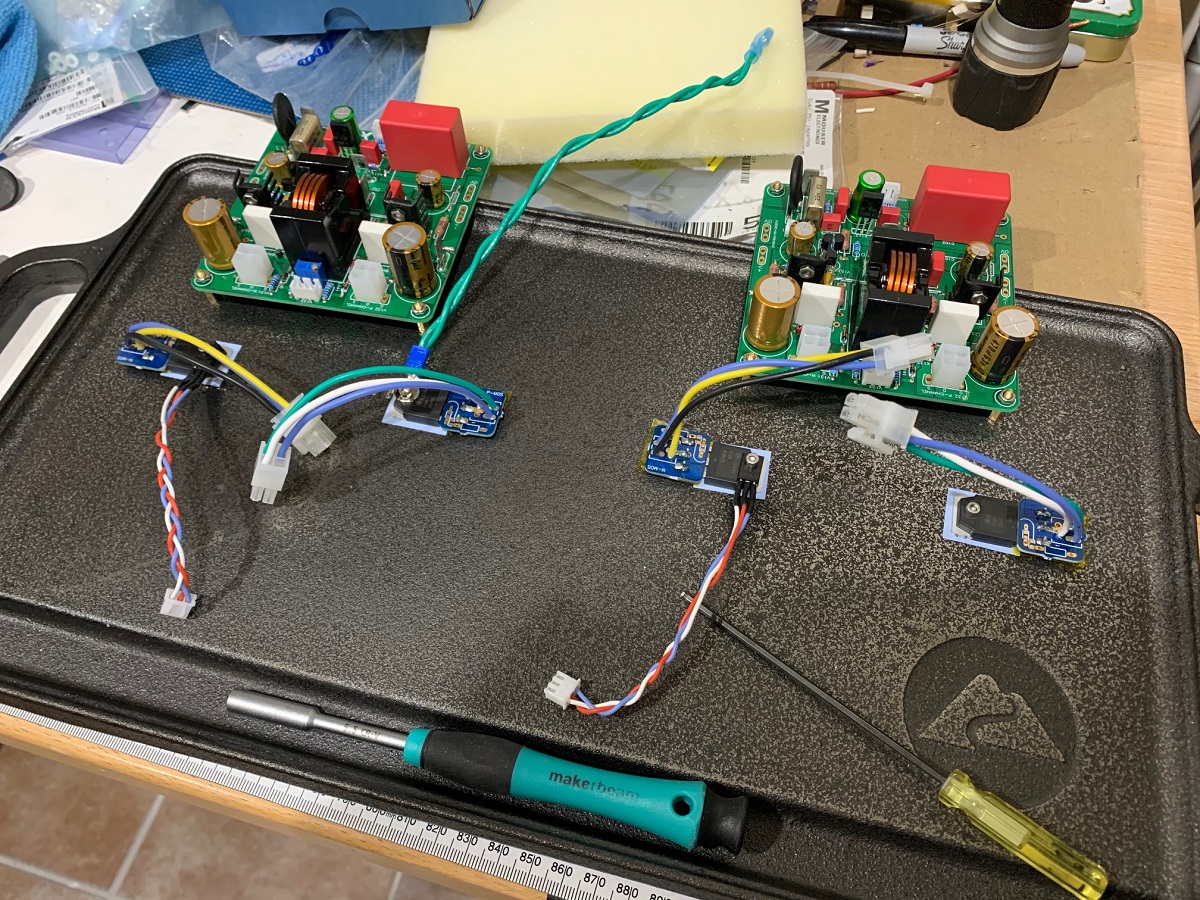

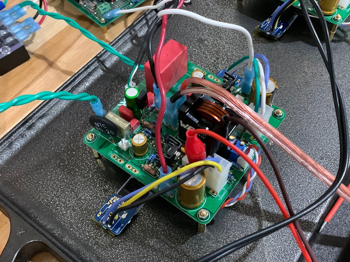

The debut of the Griddle Amp is with the FH9HVX, and it is appropriate as this is a budget build. This is a $10 cast iron griddle from Walmart and it works like a champ.

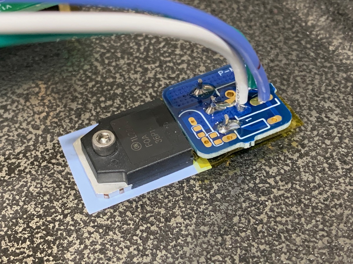

Here I am installing the MOSFETs:

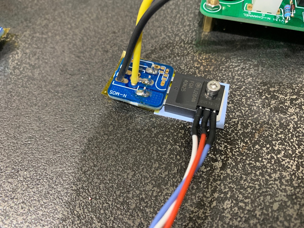

Closeup of the N-channel with the BD139 Vbe multiplier temp sensor:
Closeup of the P-channel:
Notice that the installation of the MOSFETs is a separate and much easier operation all by itself rather than having to drill holes exactly with PCB mounted underhung MOSFETS.

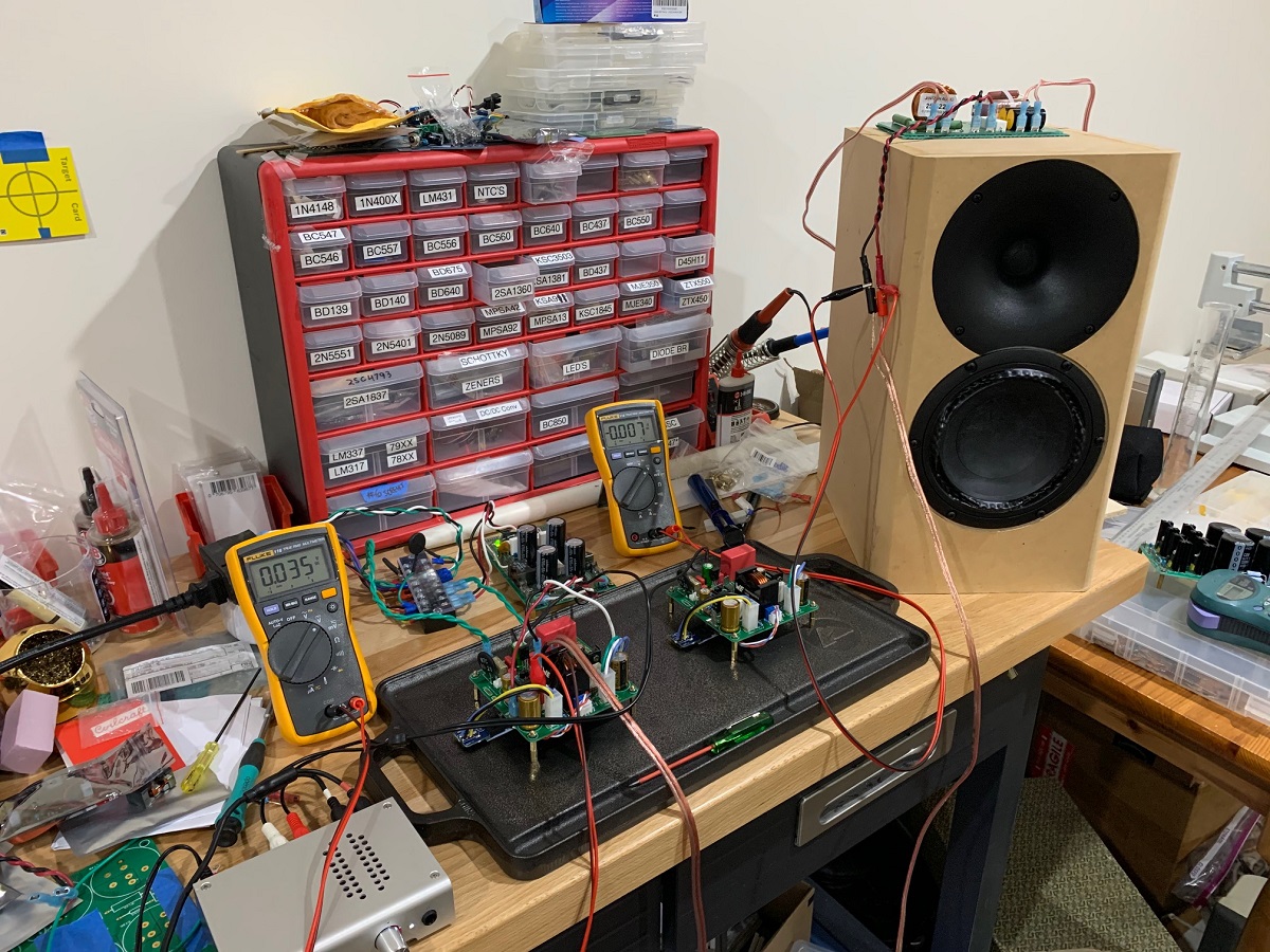

Here is a photo of the FH9HVX Griddle Amp on the bench being tested. I am using my new PTT6.5 and RS28F in WG300 waveguide speaker as the inaugaral test speaker:

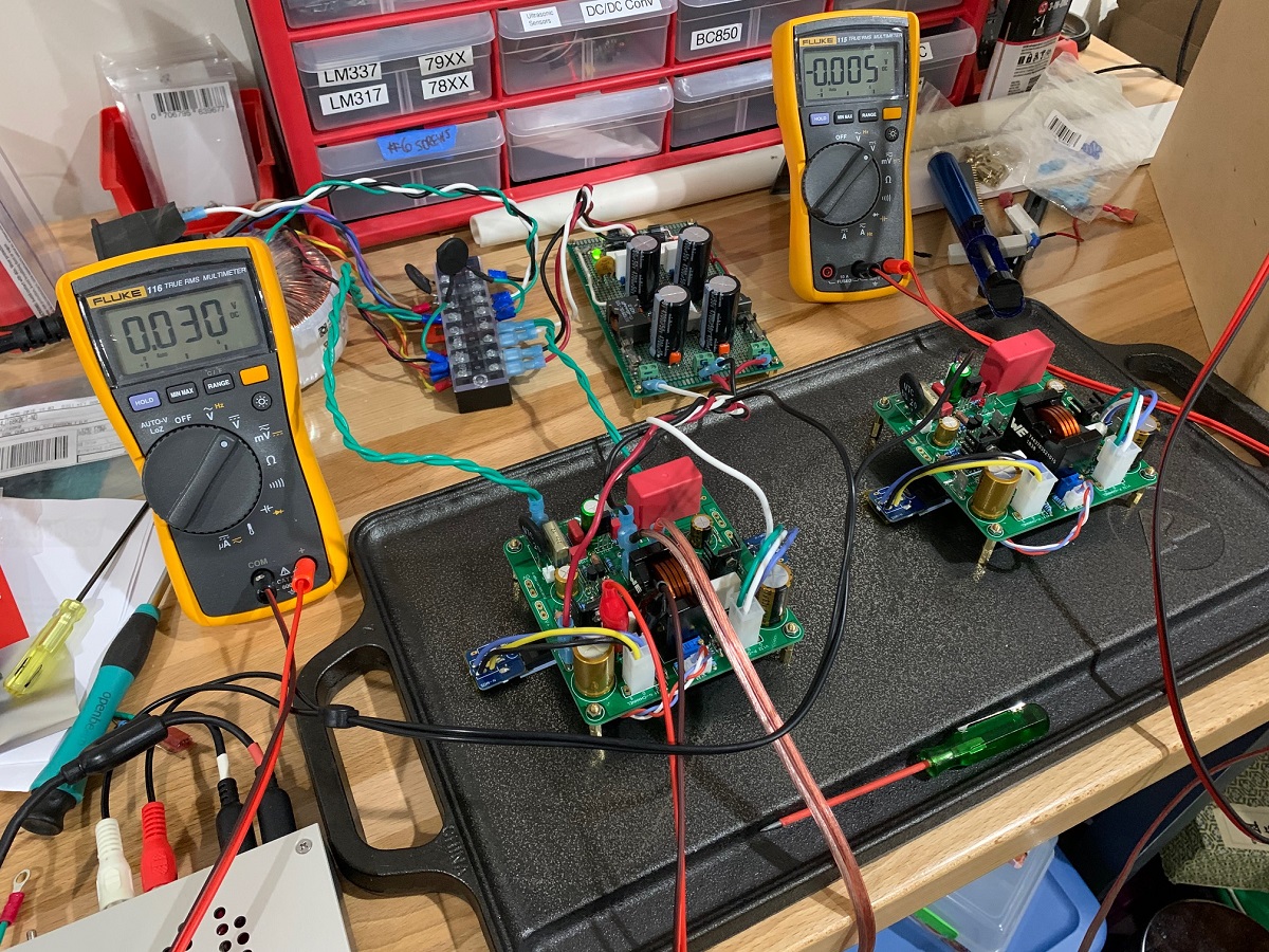

Here is a closer look at the single amp at a time test using a +/-35v CRC PSU (the very first one I made 6 years ago). I am running about 150mA bias current and the DC offset has been a stable 7mV since I powered it up, has not moved, The bias currrent is stable. Playing music at normal volume, the heatsink is 39C near the MOSFET and barely warm 5 inches away. The cast iron is not as conductive as aluminum so there seems to be more temp variations along the griddle. The MOSFET body temp is 52C:
Here is a closeup of the amp under test:
How does it sound? Super - nothing to fault. With a 4x 4700uF CRC PSU, I do not hear any hum with my ear pressed to the speaker cone. It is hard to tell it is even turned on. The amp is very quiet. There is no hiss or sound at all from the dome tweeter either. Great bass, smooth clean sound and can play very loud without strain. I will test with 45V PSU later after I build up my "All C's" PSU using 8x 4700uF per amp with a 32v dual mono trafo. You guys will really enjoy this amp. Very muscular and very clean. Nice detail.
Both Vunce and I have no verified the amp and it is an easy amp to build and simple to startup.
I used a 10ohm 10W series resistor between the PSU and the amp for both rails on the intitial startup. This was a good thing because I detected a large DC offset and immediately turned it off to investigate and found that I forgot to install a single 1N4148 diode V112. For Class AB amps, I do suggest the use of either a light bulb tester, a variac, or a pair of 10ohm power resistors. Once the amp starts up correctly (no crazy offset or high bias currents), you can remove the series resistor. At the mid 500R position on the pot, I was getting close to 0mA bias current. Adjusting a few turns brought it up to 33mV across 0.22ohms or 150mA. If I had not forgotten the the diode, the startup would have been uneventful.

My FH9HVX's are finally running in stereo - they sound great! The griddle amp rocks!
Listening on my 10F/RS225 TL's - sounds very good. This amp is very quiet. No noise or hum.

Finally can crank the amp up loud with the 10F/RS225 TL's. Wow - what a sound! The bass is endless and impresive as are the smooth mids and highs. There is some big power reserves and the amp just never sounds strained. Very impressive and beautiful sounding amp. You guys are in for a treat!
