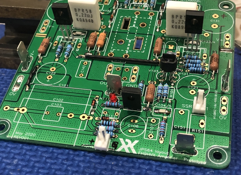

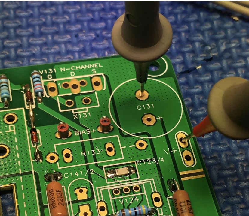

Status update on the vero builds. As usual, Vunce is way faster than me and almost finished. Along the way, he discovered some silk screen typos. A major one on C131 what would have caused an explosion of the worst kind - reversed polarity on a major 63v rail cap. 🤯
He also a has some other very good observations that will make the final board better and easier to use.
He is so busy building (and doing home improvement DIY) that I am posting his progress photos for him.
Thanks, Vunce!
Thanks, Vunce!
