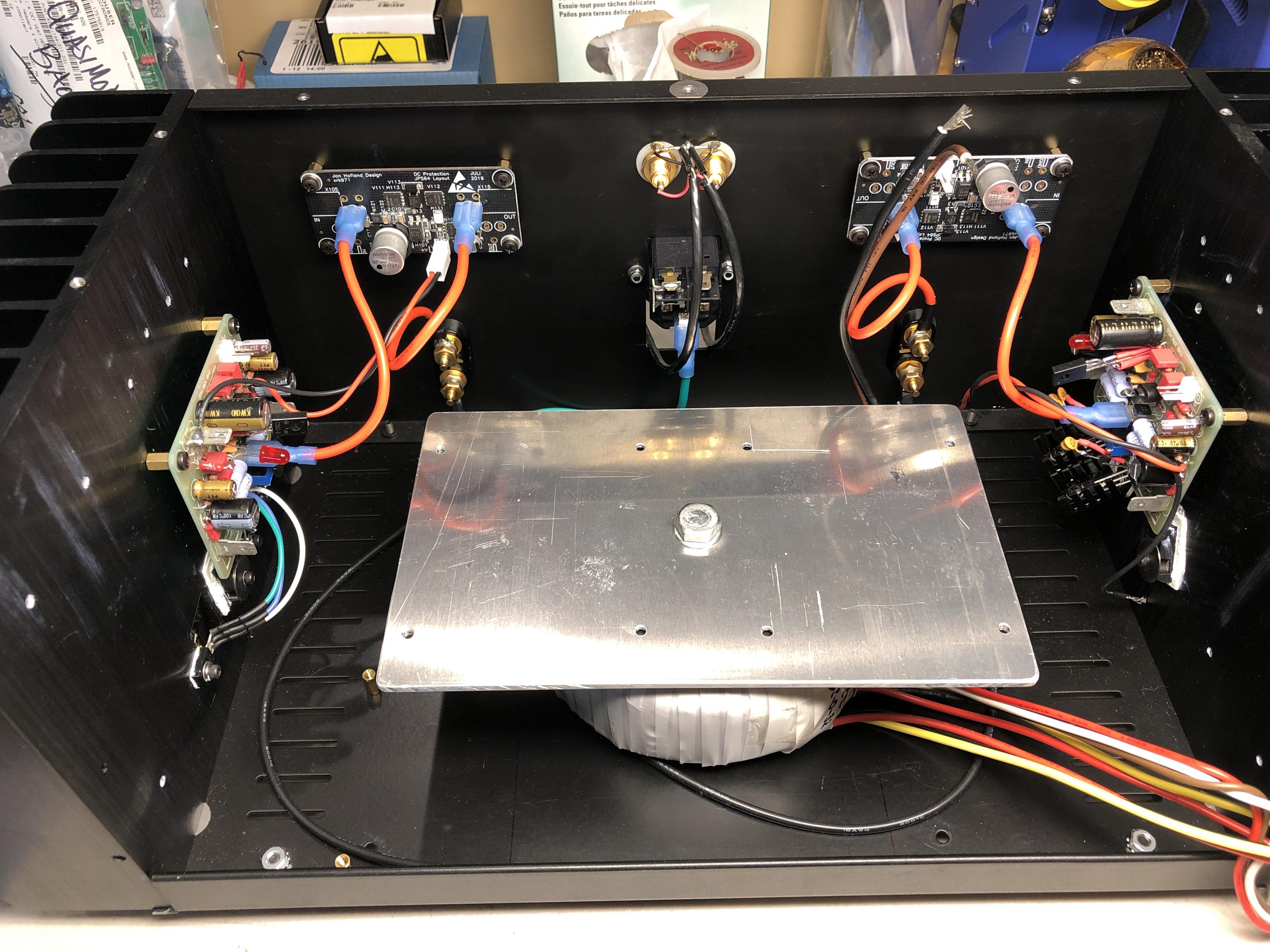

Vunce has found that even a simple PSU with C’s only and no CRC still works very well - here with 11,000uF per channel and no hum or noise of any kind with ears pressed to speaker cone. This is a special trafo with dual centertap secondaries for dual monoblock worh single trafo at +/-43.5v. Good for about 97w.

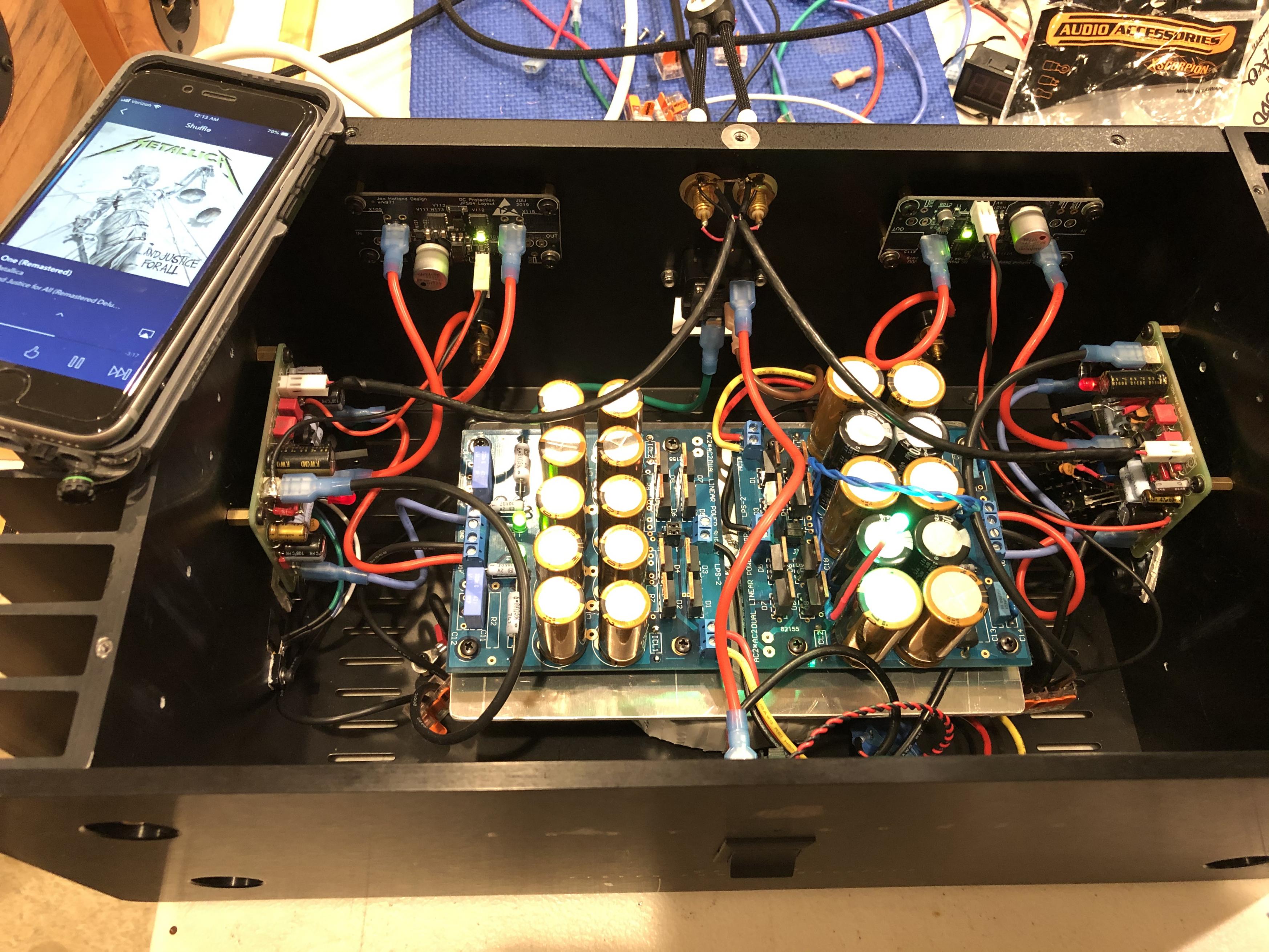

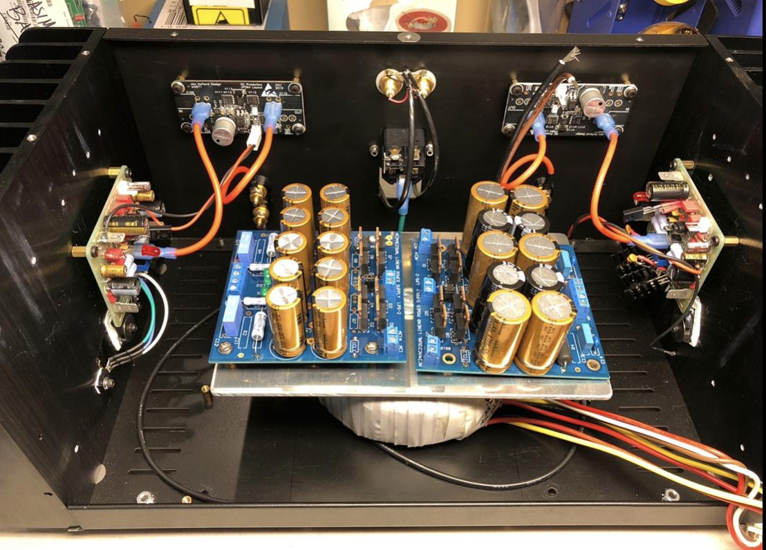

Just got a set of plain Jane PSU’s fired up. The left unit has 11,000µF, the right unit has 23,500µF of capacitance. The transformer has a pair of center tapped secondaries, so I’ve got essentially a poor mans dual monoblock setup. Sounds nice so far, there is very faint hum if I put my ear right in front of the woofer on the 11,000µF channel. Given this is not a CRC filter, the capacitance is probably on the light side. But, I am surprised how quiet it is overall.
I’m going to keep playing around and eventually I’ll list the combo’s I’ve tried out.

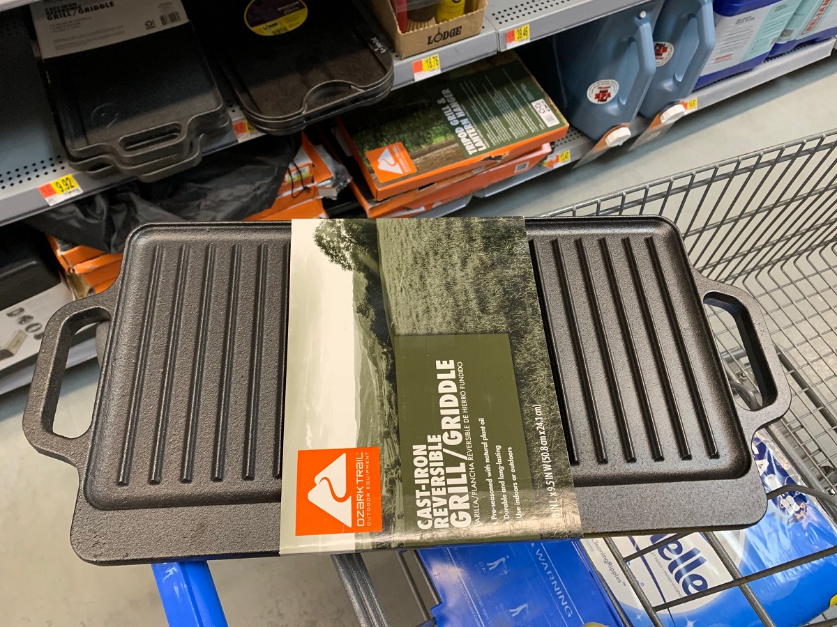

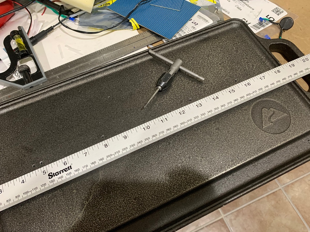

So you guys thought I was kidding about the Griddle Amp?! How little faith you all have in me! 🙂

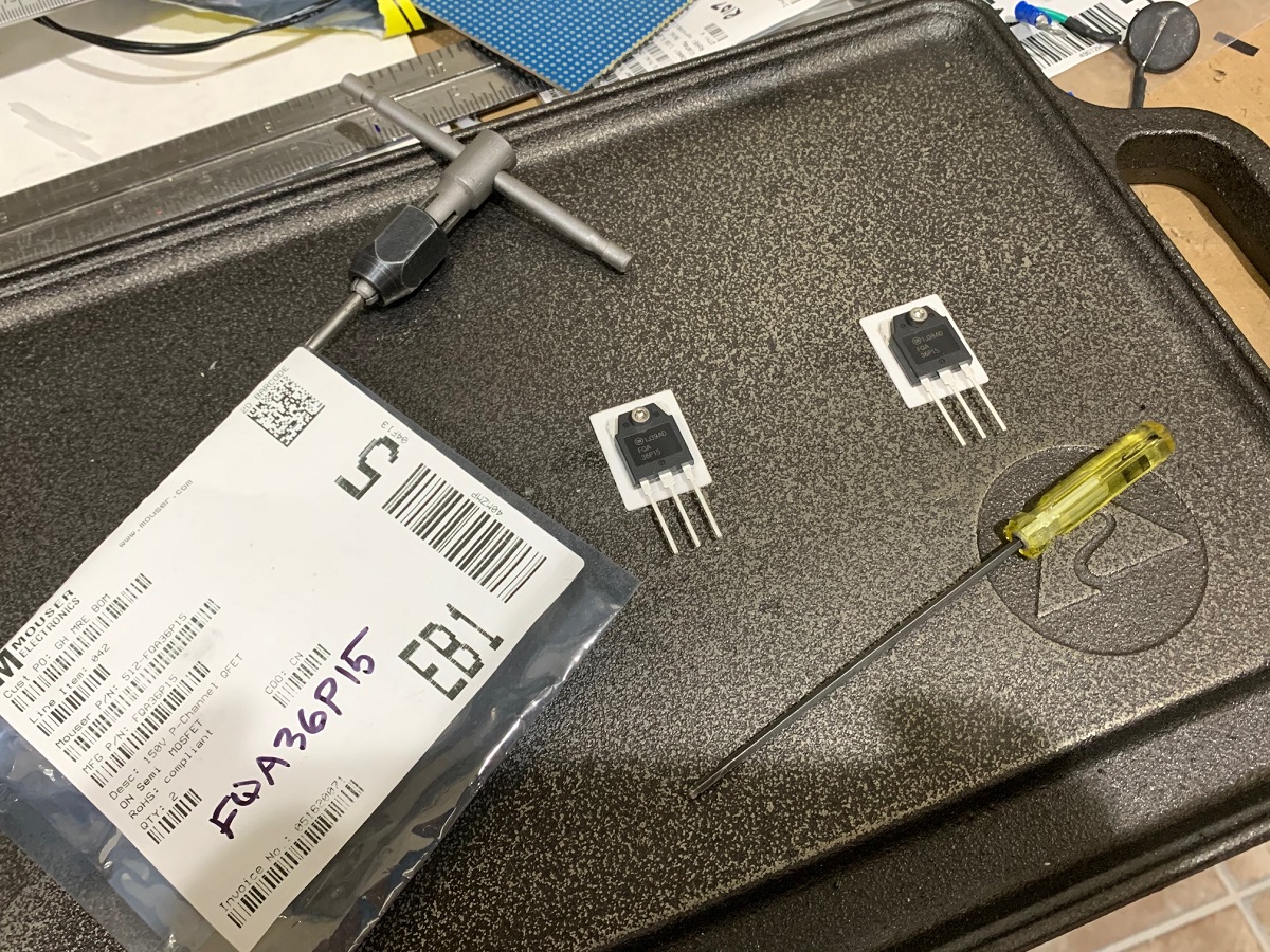

I present to you the $9.92 cast iron Griddle Amp heatsink. It has a grille surface of 16in x 8in (not including the rim and handles or grease well). Weighs about 8lbs and can probably handle 100w of dissipation, no problem. It took a little sanding ith 320 grit and a power sander to get semi smooth. The drill and tap was a breeze - smooth, like buttah.
Picking it up at store:
After sanding and drill and tap operation:

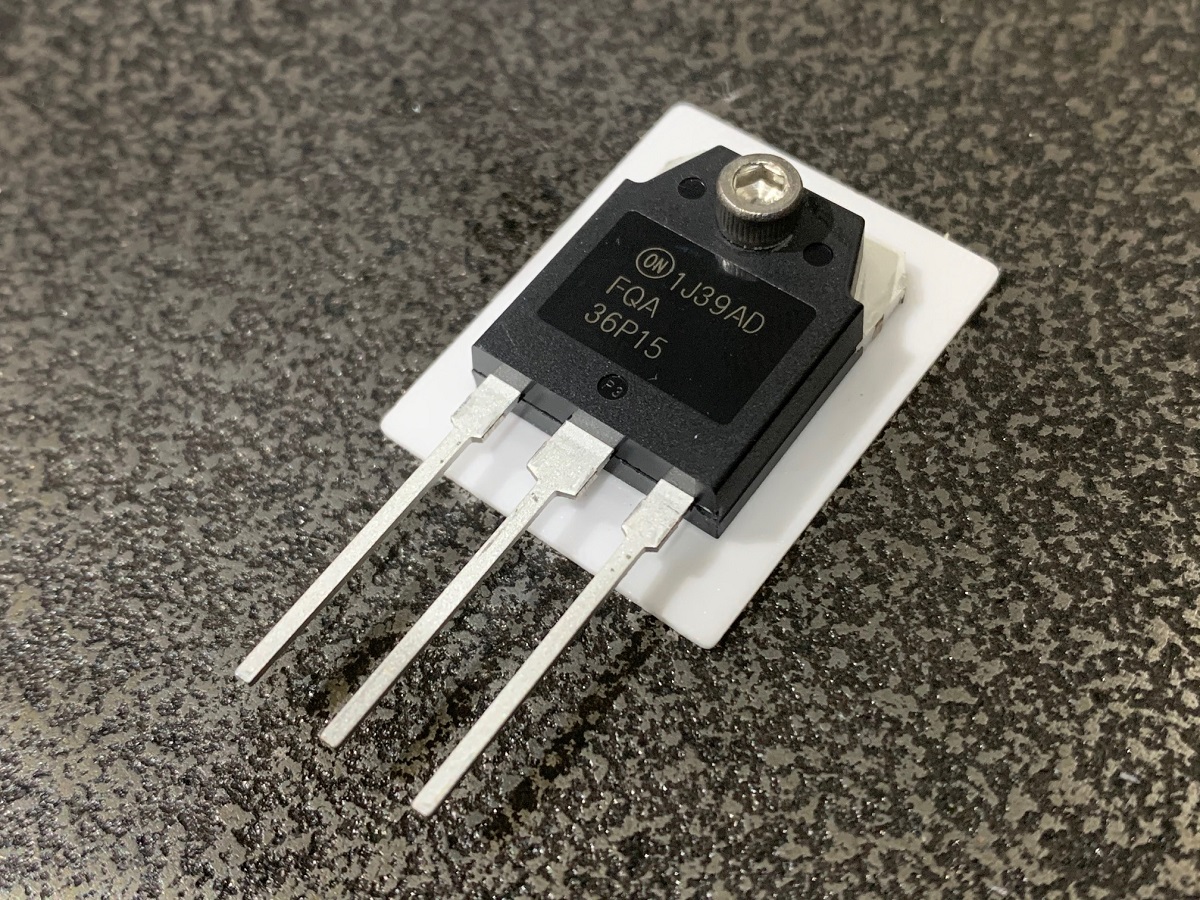

Installing test MOSFETs to check fit:
The ceramic thermal spacers and heat sink compound will be critical to fill in all those voids:
The grease well at the bottom provides a nice flat bulkhead for installing RCA inputs as well as banana plug binding posts for speaker outputs. The width is actually compatible with 17in EIA rack standard. I just need to install a rear frame for the trafo and main PCBs. Or I might mount PCBs to griddle as the holes are almost trivial to tap.

Should play heavy metal very well. 😱So you guys thought I was kidding about the Griddle Amp?
You've got another thing comin'...
