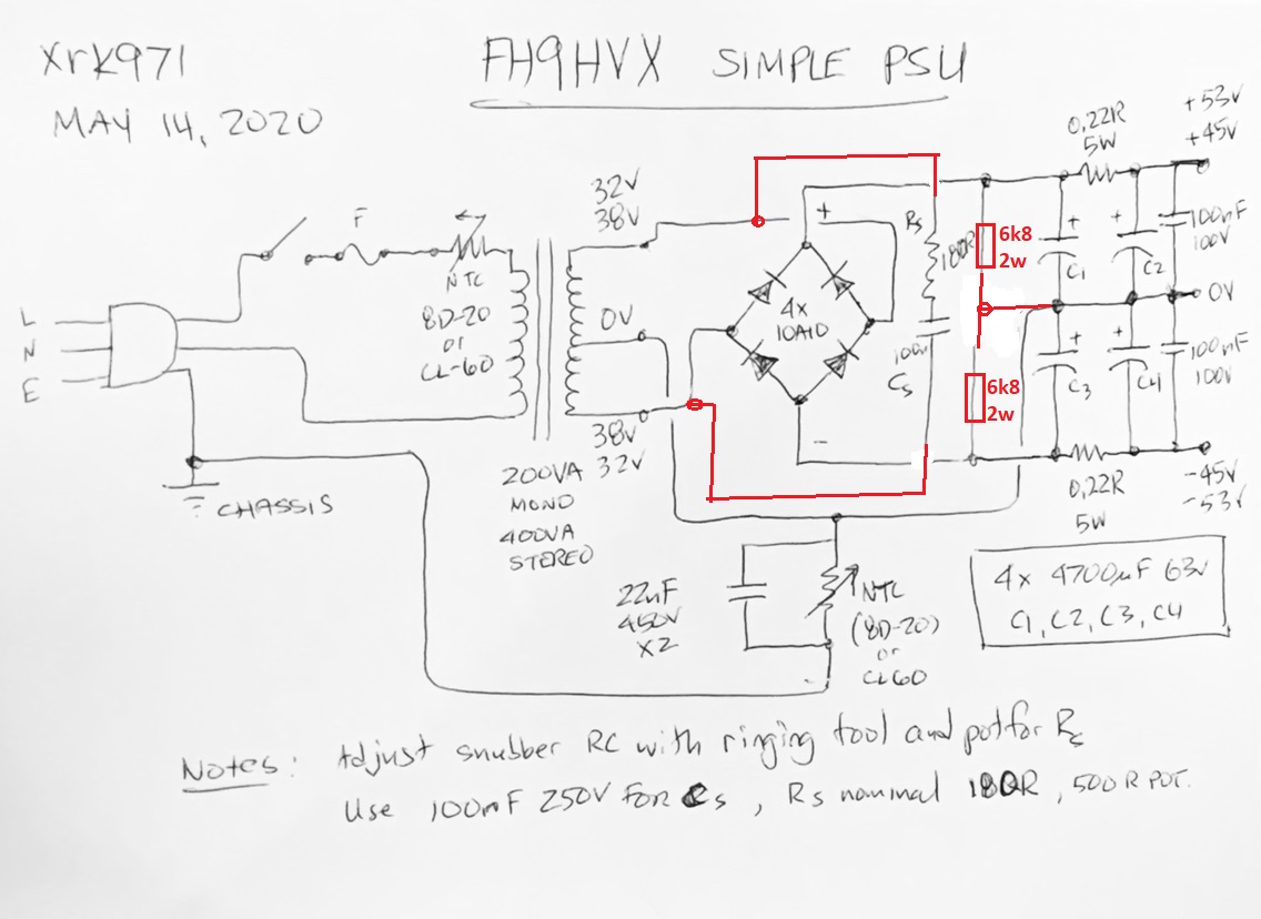

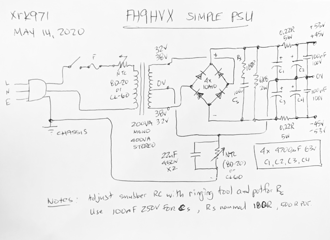

I think Prasi CRC is great if you have it already. It’s overkill for the FH9HVX.
I was thinking more along the lines of something lower cost and simple like four 10A10 diodes with windings set up as common center tap. Four 4700uF 63v caps and 0.22R 5W resistors. A 6k8 2W bleeder resistor. 100nF 250v MKP output bypass cap. An RC snubber setup and tuned to your particular trafo (optional). Use 100nF film and 180R as baseline for snubber.
Do all of this as P2P.
Schematic for a single channel monoblock:
For a stereo supply use 9600uF caps and 0.1R resistors.
Edit: for single 6k8 bleed red between +/- rails, use 3w. Or two 2W connected between +ve and -ve rails and ground.
Hi Folks,
I have a couple of errors on the above schematic. The snubber needs to be on the secondaries AC side. The 6k8 2w bleeder needs to be from each rail to 0v in order to keep the dissipation low enough. Also, if using one PSU for stereo, make the bulk caps 9600uF ea and use 0.1R 5W resistors. Here is the corrected schematic.
Looks good, 10,000uF is great but not necessary to be that big. The ground should have NTC to isolate clean vs dirty chassis/earth ground.
