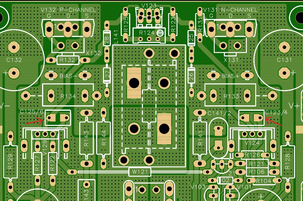

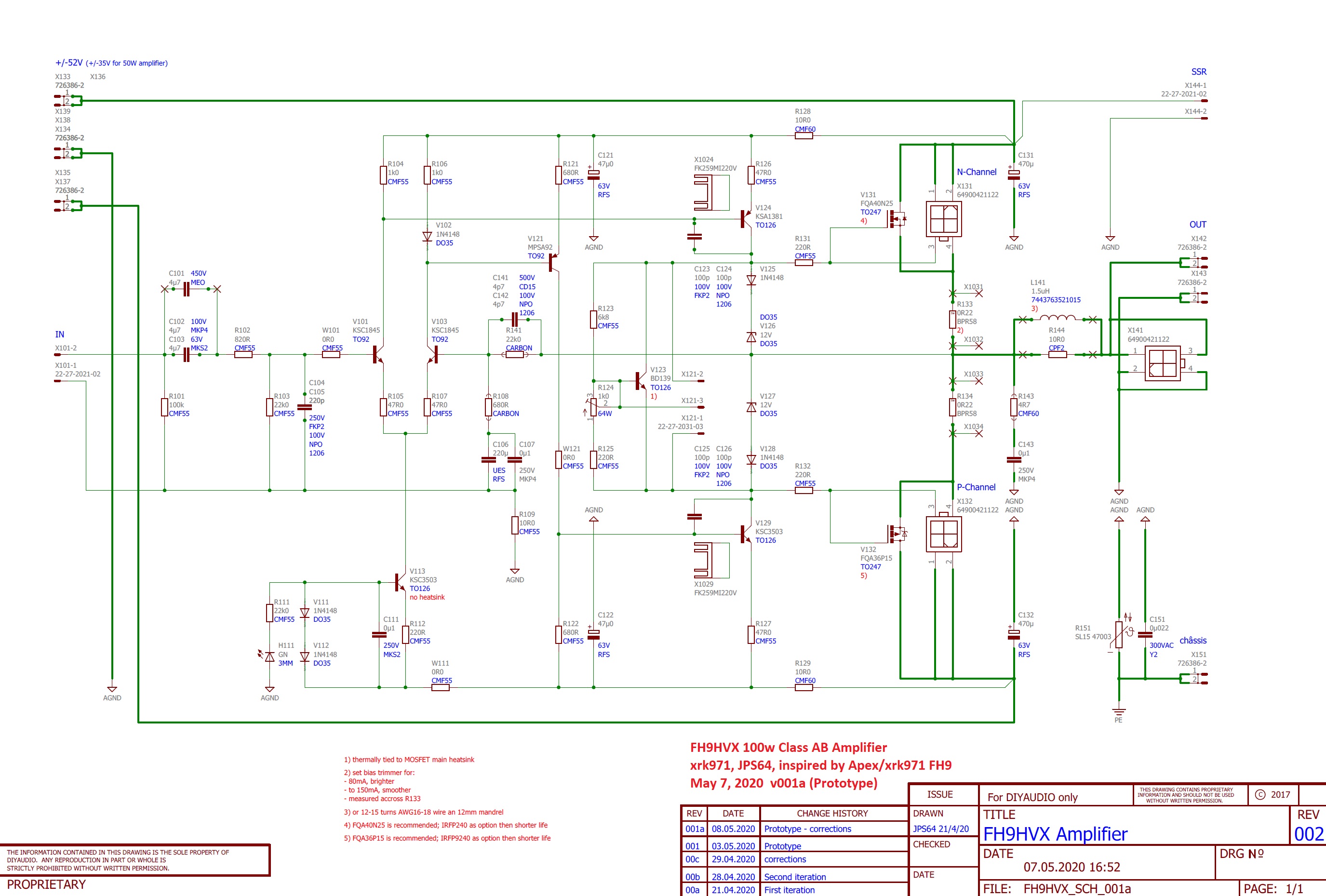

Hi Folks,
Here is the updated schematic and BOM, now with the optional caps on the drivers. Nominally, I would leave these unpopulated and only use them if you experience oscillation. You can start as low as 15pF and work your way up, using only as much as needed. The BOM has a 100pF value and part selected. JPS64 did a great job in putting optionally the use of either 5mm through hole Wima FKP 100pF 100v box cap or a 1206 size 100pF 100v NP0/C0G SMT cap.
Here is the revised schematic (attached as PDF) and BOM (attached as zipped XLSX file).
Here is a closeup of the cap location on the layout:

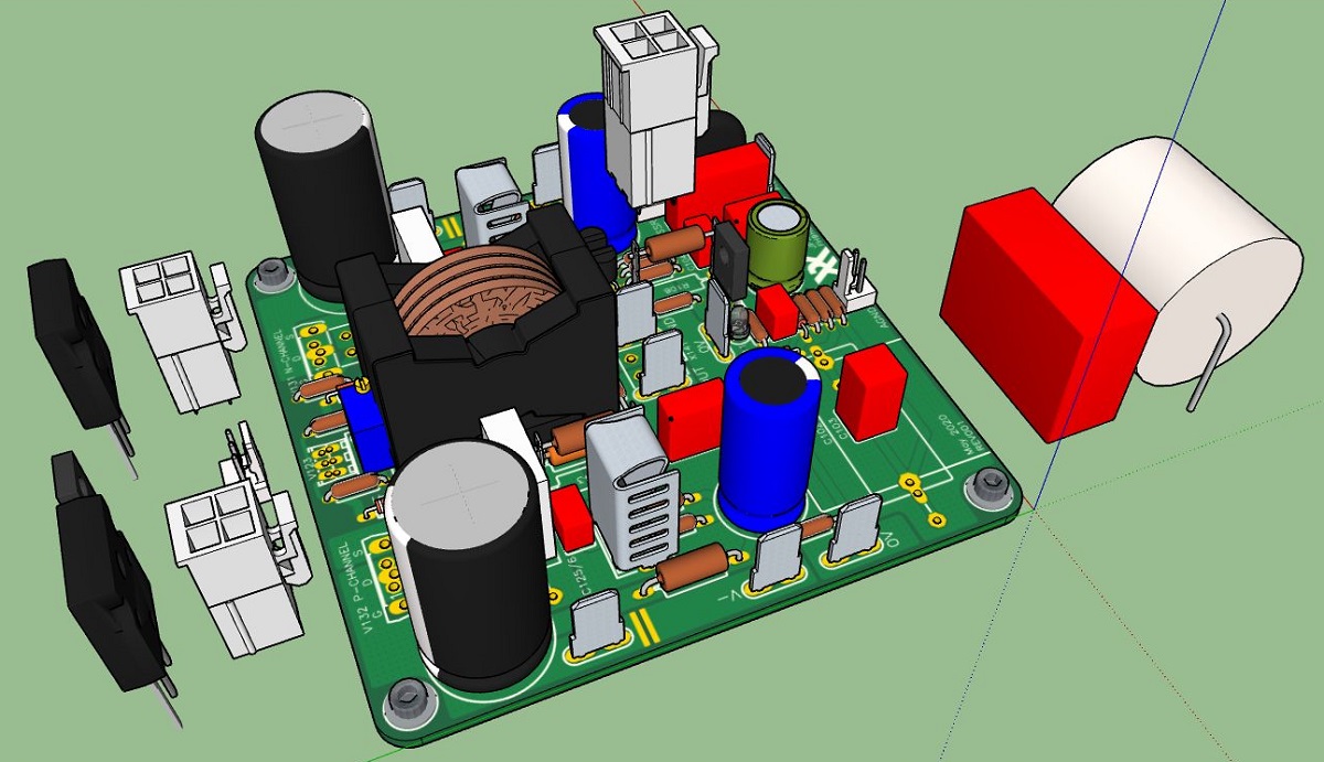

3d Rendered View:

....JPS64 did a great job in putting optionally the use of either 5mm through hole Wima FKP 100pF 100v box cap or a 1206 size 100pF 100v NP0/C0G SMT cap.
Here is the revised schematic (attached as PDF) and BOM (attached as zipped XLSX.
Wonderful! Thanks X and especially JPS64 for the xtra work in offering a through hole option.
Yes, just basic transistor tester and match Hfe as close as possible. That will help keep DC offset to a minimum. There is no DC offset adjust on this amp simply by picking similar Hfe input BJTs.
