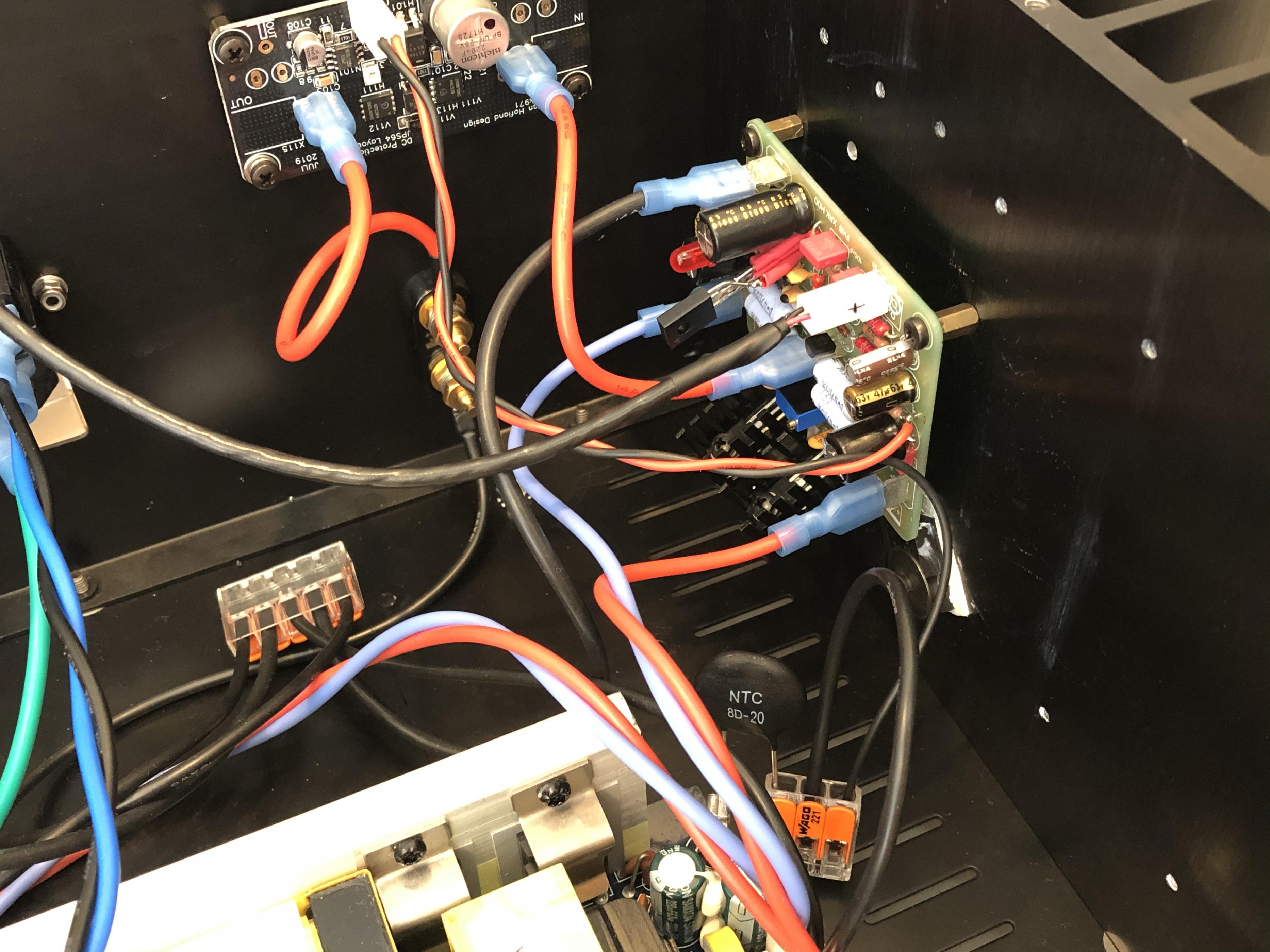

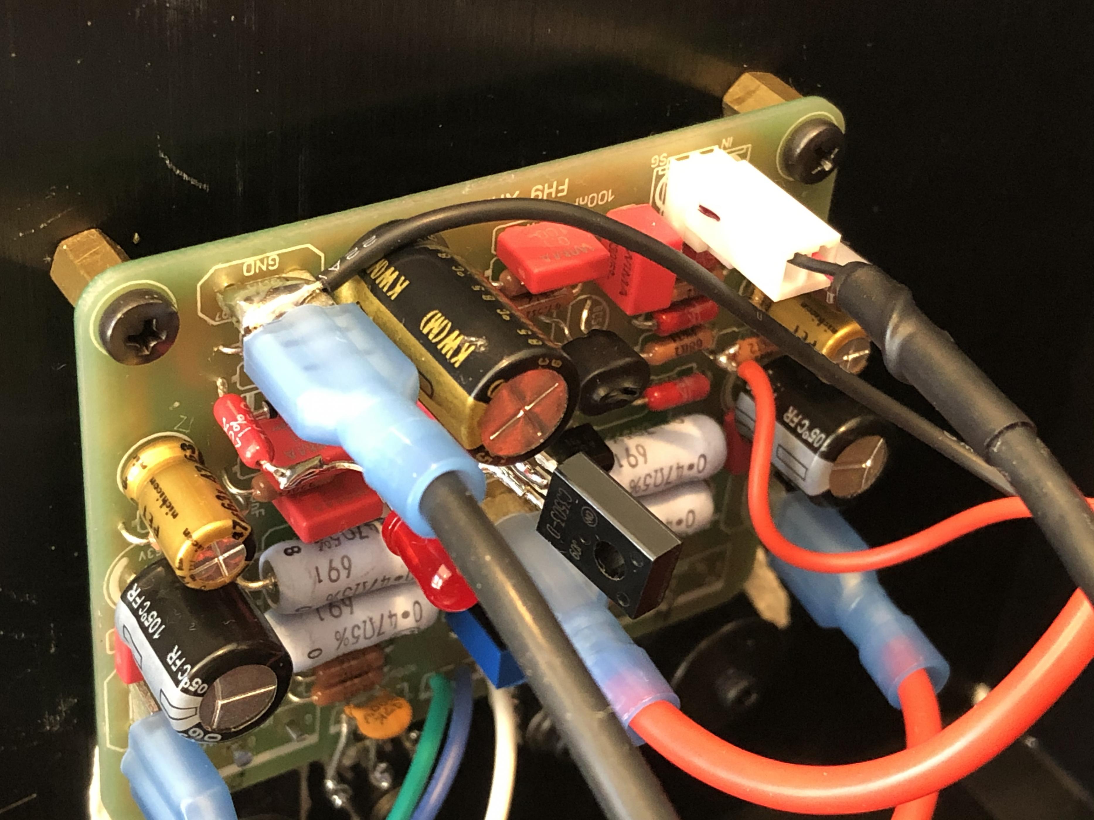

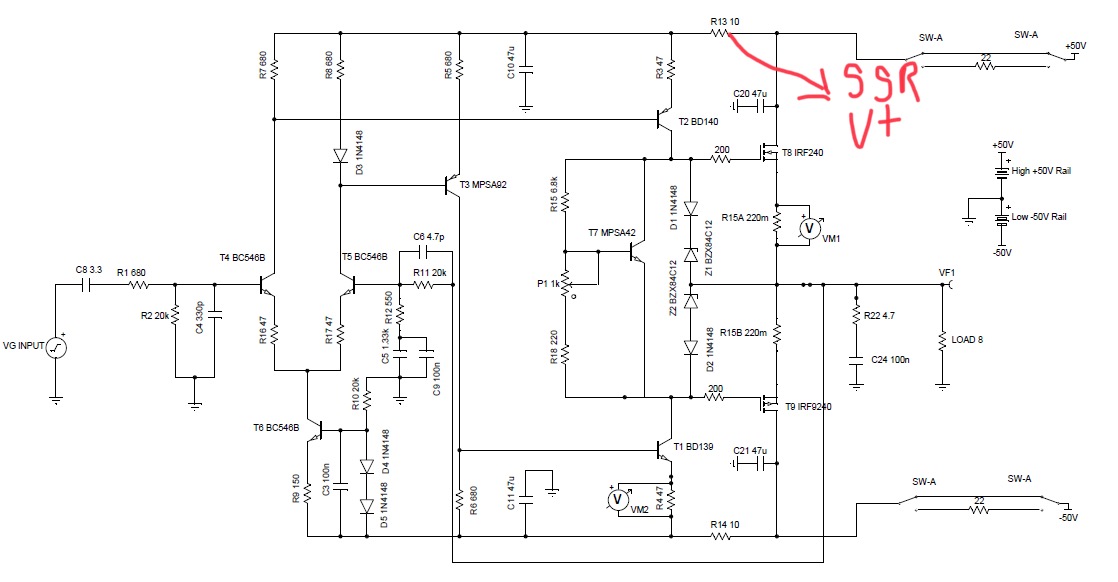

You seem to power the SSR from the amp board itself. Taking the + from near the resistor close to the positive power pin and the ground from the psu ground. Not visible from the dark pictures properly, can you please post some well lit pics and also let us know how did you power the SSR boards.
thanks
That's exactly how the SSR is powered - it just needs access to +ve rail voltage anywhere you can get it. Here, it is right at the 10R resistor. On the FH9HVX PCB, I will have a Molex KK 2pin connector dedicated for powering thge SSR, same as on the Alpha Nirvana. It just makes it a lot easier to connect the SSR.

I apologize for the dim pictures, I was trying to capture the lit LED’s.
You have good eyes! Yes, I tapped V+ off the 10R resistor leg, it was the easiest location without removing the board from the heatsink. The GND is picked up from the GND faston on one board and at the psu GND for the other board.
Like X said, adding the Molex 2-pin header will make this connection a simple plug’n’play 🙂

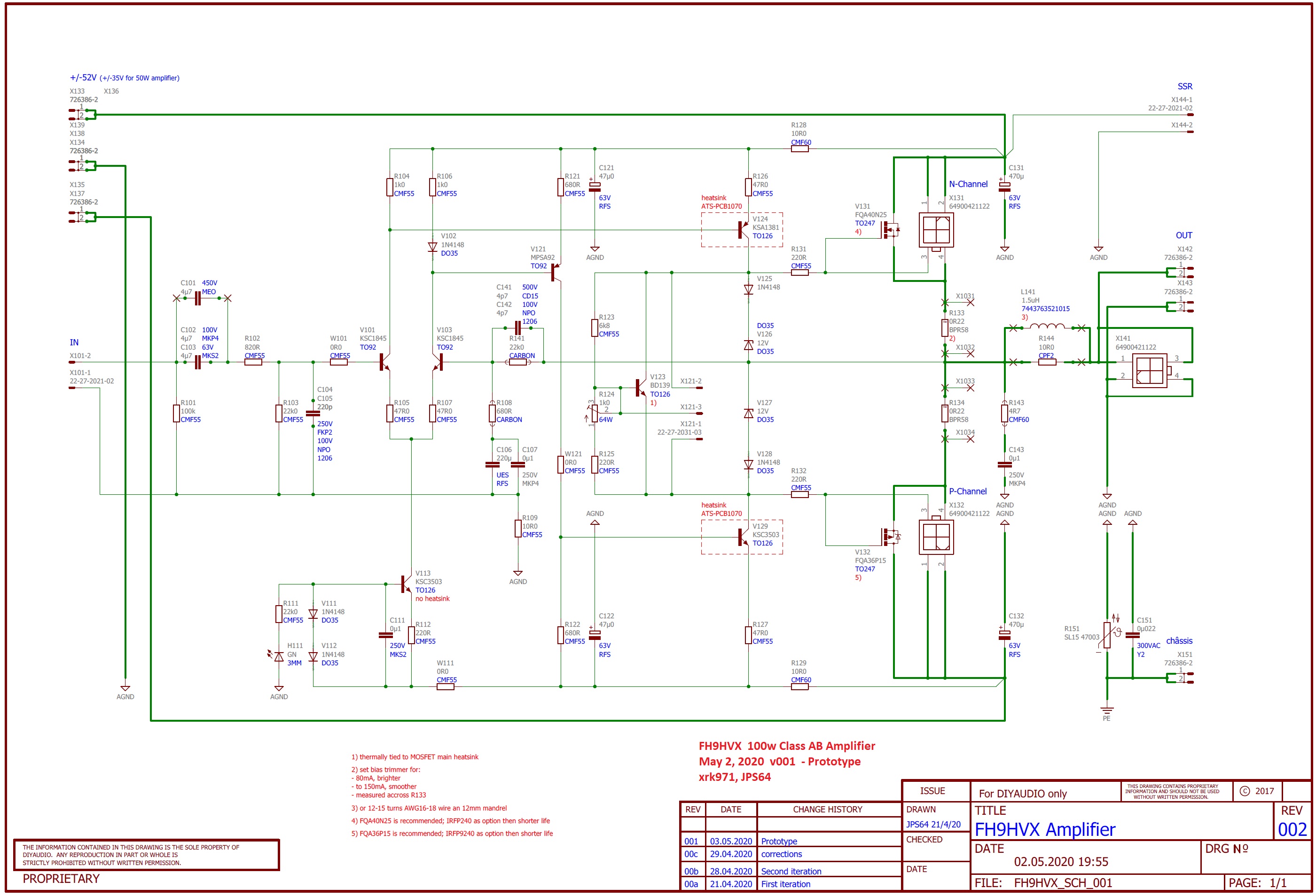

The current schematic looks more like this. The CCS was changed to KSC3503, an LED was added as an indicator at the base of the CCS. Some resistor values are still being tweaked but it seems Vunce is having pretty good luck with 1k and 220R above and below the LTP. There may be a few other changes before we get the manufacturing ready schematic (like power supply 2 pin Molex KK for the SSR) and PSU Fastons on either side of the board selectable via solder jumper.

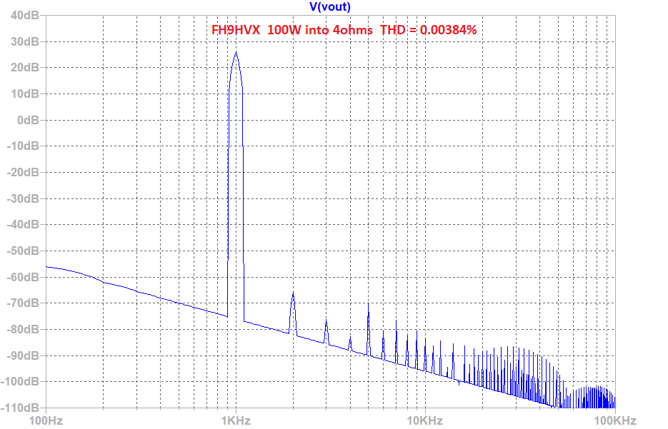

I just ran some more LTspice sims of the FH9HVX with a 4ohm load as Vunce says he wants to bring it to his brother's house to test out on some big Polk LSi15's.
Well at 100w into 4ohms (150mA quiescent bias), we get very nice performance of THD at 0.0038%. So looks like this amp has no problem driving 4ohm speakers.
Harmonic profile still looks excellent, in fact H2 dominant and H3 less than H2 and descending higher orders, with 5th a bit higher than 4th and descending from there.

Harmonic Frequency Fourier Normalized Phase Normalized
Number [Hz] Component Component [degree] Phase [deg]
1 1.000e+03 2.825e+01 1.000e+00 -1.40° 0.00°
2 2.000e+03 7.293e-04 2.582e-05 128.23° 129.63°
3 3.000e+03 2.203e-04 7.799e-06 -141.95° -140.55°
4 4.000e+03 1.030e-04 3.648e-06 170.91° 172.31°
5 5.000e+03 4.479e-04 1.586e-05 -112.40° -111.00°
6 6.000e+03 1.336e-04 4.729e-06 167.76° 169.16°
7 7.000e+03 2.154e-04 7.626e-06 -119.66° -118.26°
8 8.000e+03 1.084e-04 3.838e-06 164.17° 165.57°
9 9.000e+03 1.339e-04 4.740e-06 -125.16° -123.76°
10 1.000e+04 9.661e-05 3.420e-06 160.33° 161.73°
11 1.100e+04 6.880e-05 2.436e-06 -133.55° -132.16°
12 1.200e+04 8.557e-05 3.029e-06 156.43° 157.82°
13 1.300e+04 2.655e-05 9.398e-07 -152.27° -150.88°
14 1.400e+04 7.627e-05 2.700e-06 152.59° 153.98°
15 1.500e+04 1.227e-05 4.344e-07 99.70° 101.10°
Total Harmonic Distortion: 0.003384%(0.008700%)

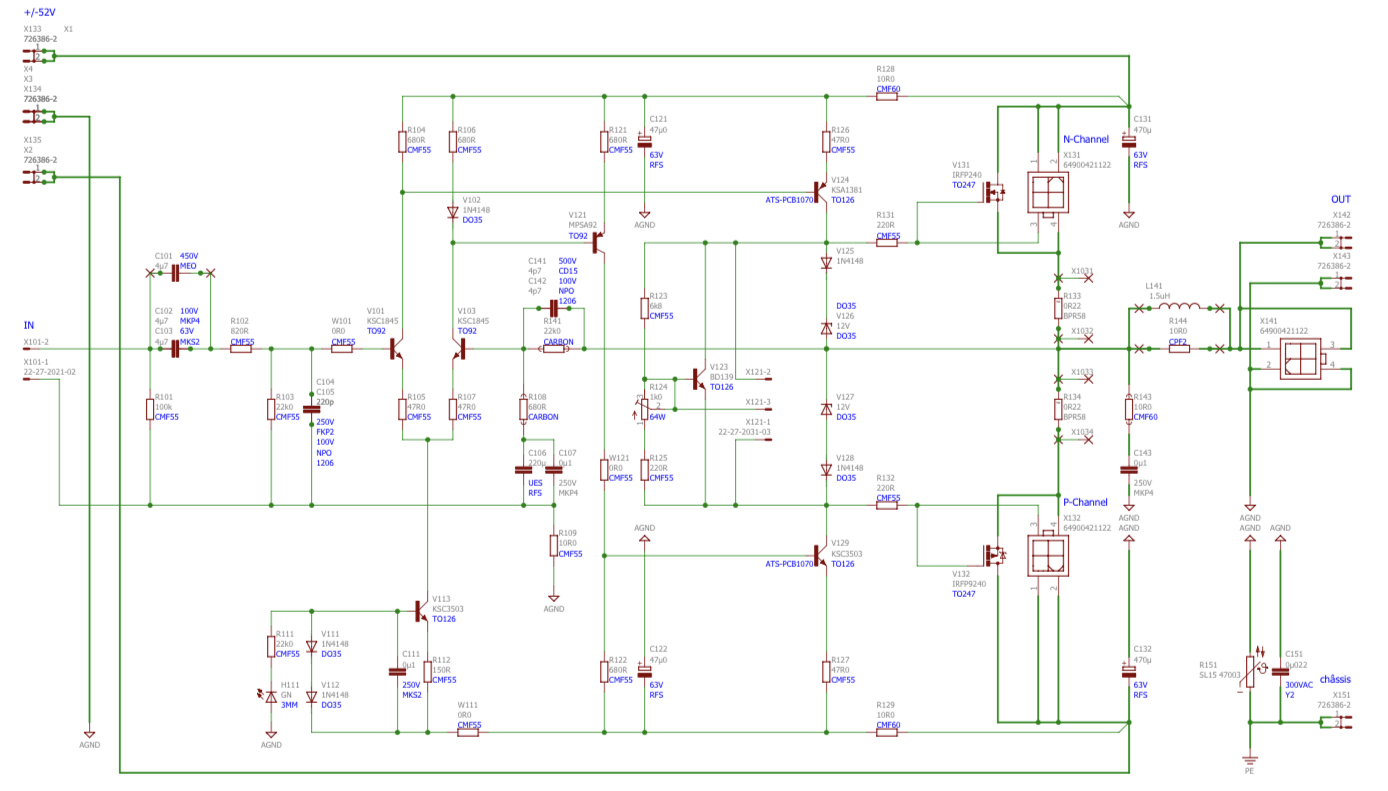

I just got the finalized manufacturing data files from JPS64. Here is how the amp looks, plus schematic, BOM, and stuffing diagram.

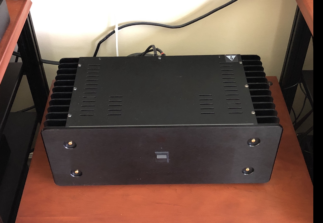

Vunce just shared with me a photo of his new baby all buttoned up. 🙂
Nice build Vunce!
https://www.diyaudio.com/forums/gro...s-100w-class-ab-lean-times-5.html#post6188402
That case does look nice. The amp inside is only a pre-prototype based on original FH9 layout. The new layout and component choices should make it even better.

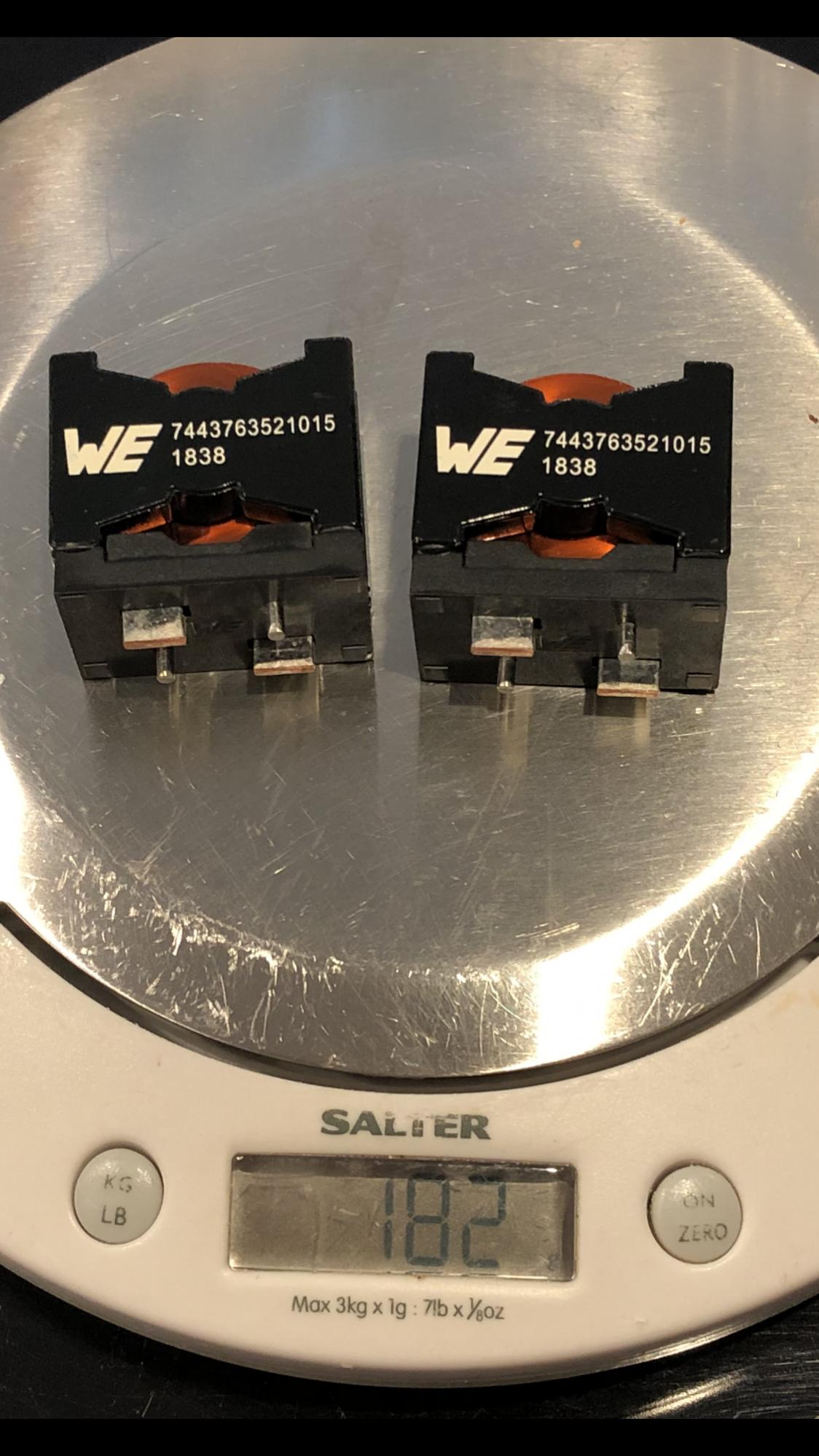

Can I ask where does one buy the inductor - L141?

Those are standard items from Mouser. There are similar ones in SMT which I have used before. They are very nice inductors with negligible DCR.
