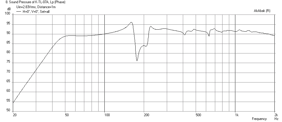

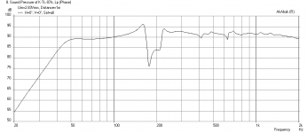

A simulation can't predict if the 220 is better than the 1772 - there is stuff in the freq response that is so dependent on driver design like cone breakup and dips and peaks - but in terms of efficiency and bass extension they look about the same. With the 220 coating less - it may be more attractive. The problem has been that there are so few builds with the ps220 that the word of mouth endorsement required to overcome any reluctance hasn't really happened yet. There is the one thread going on now with the 220 in a MLTL so that may help get things going.
