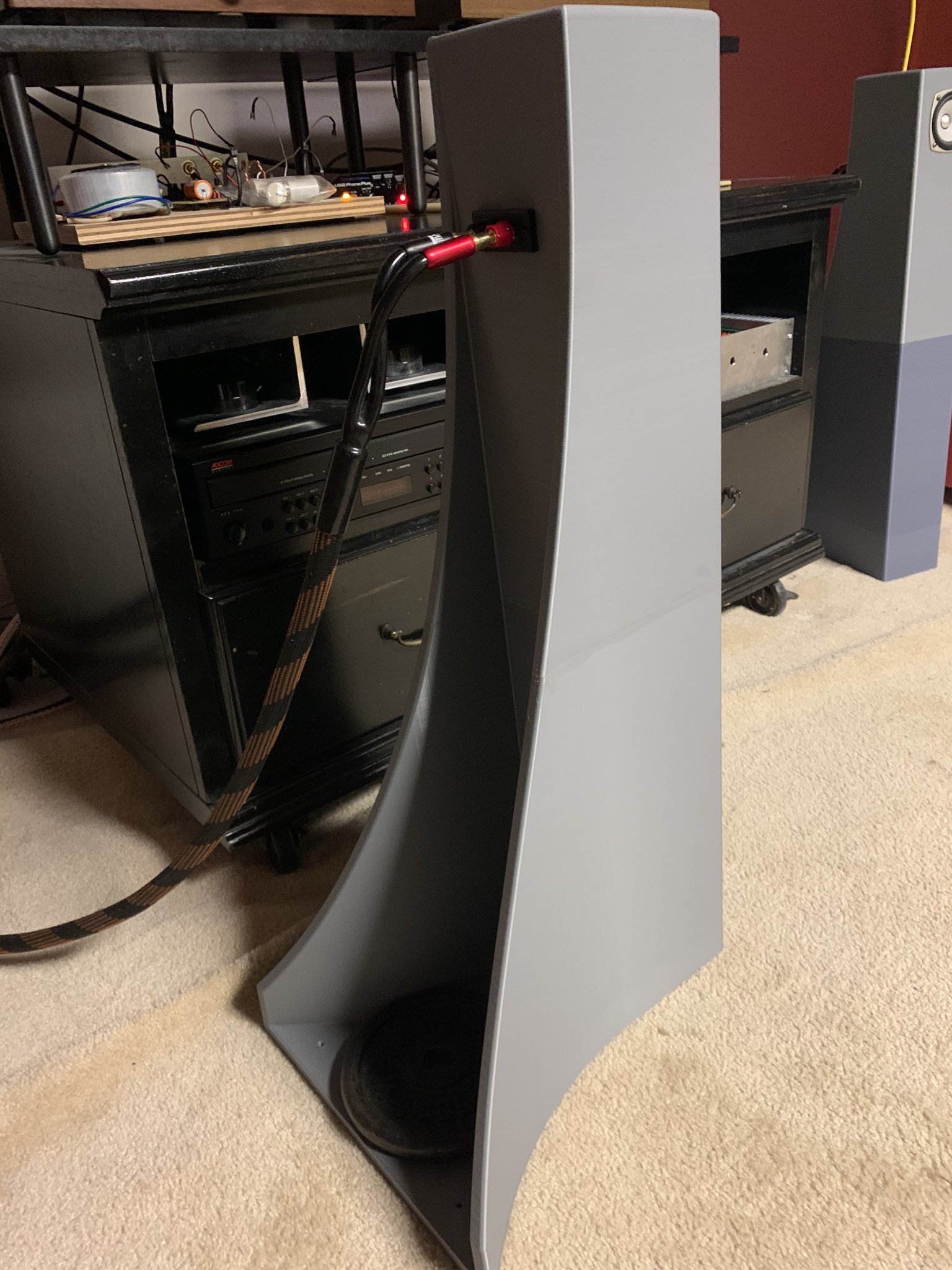

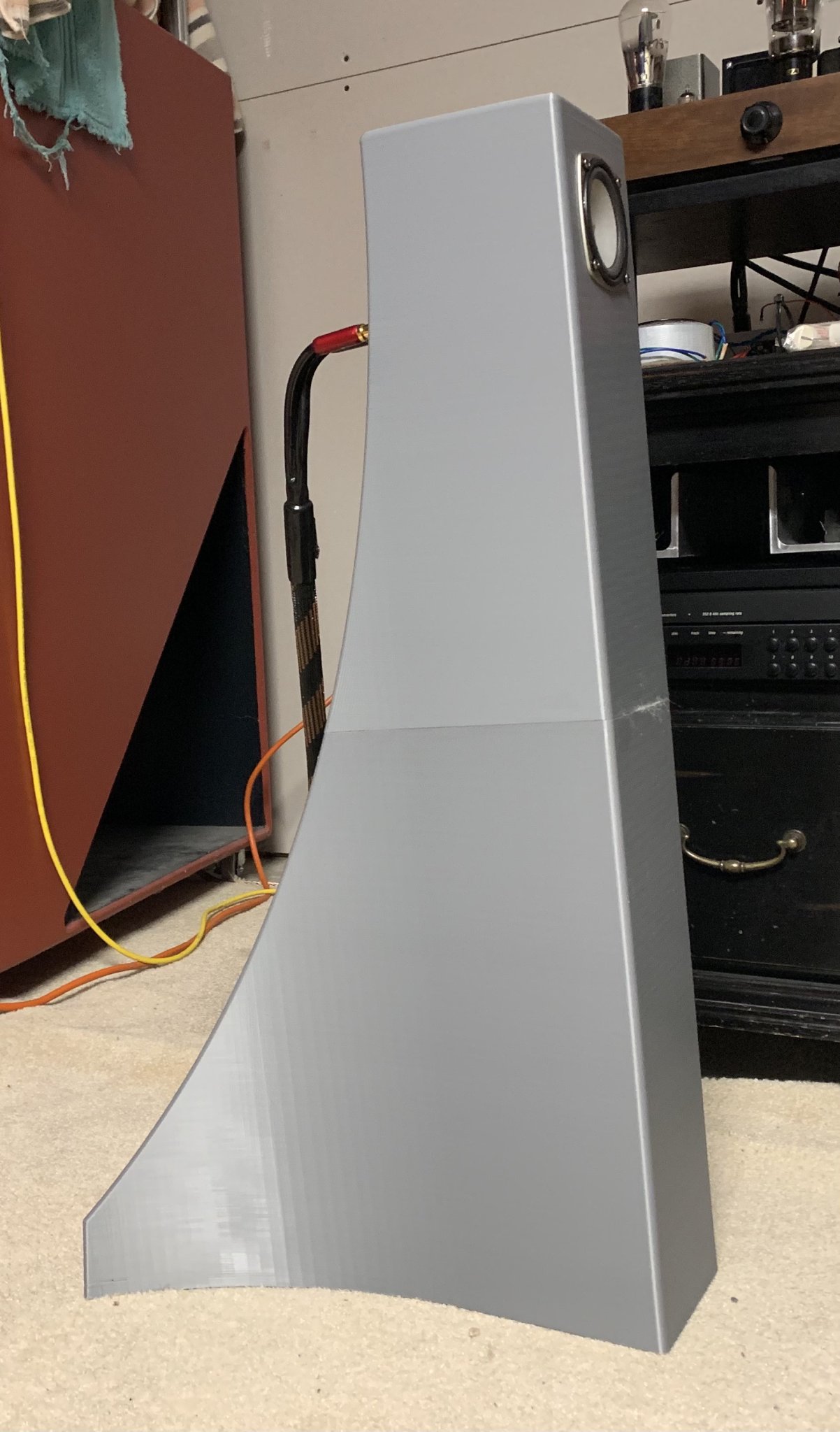

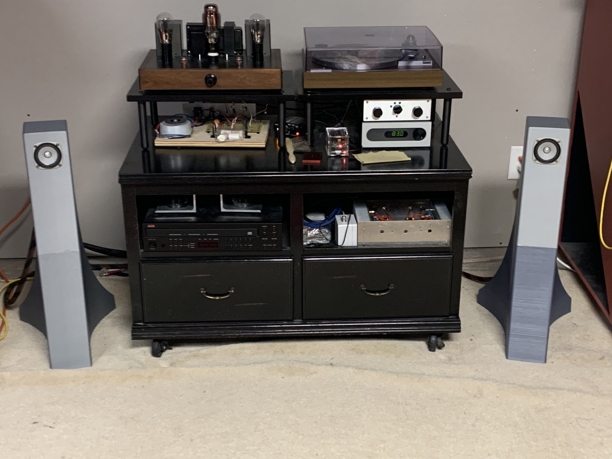

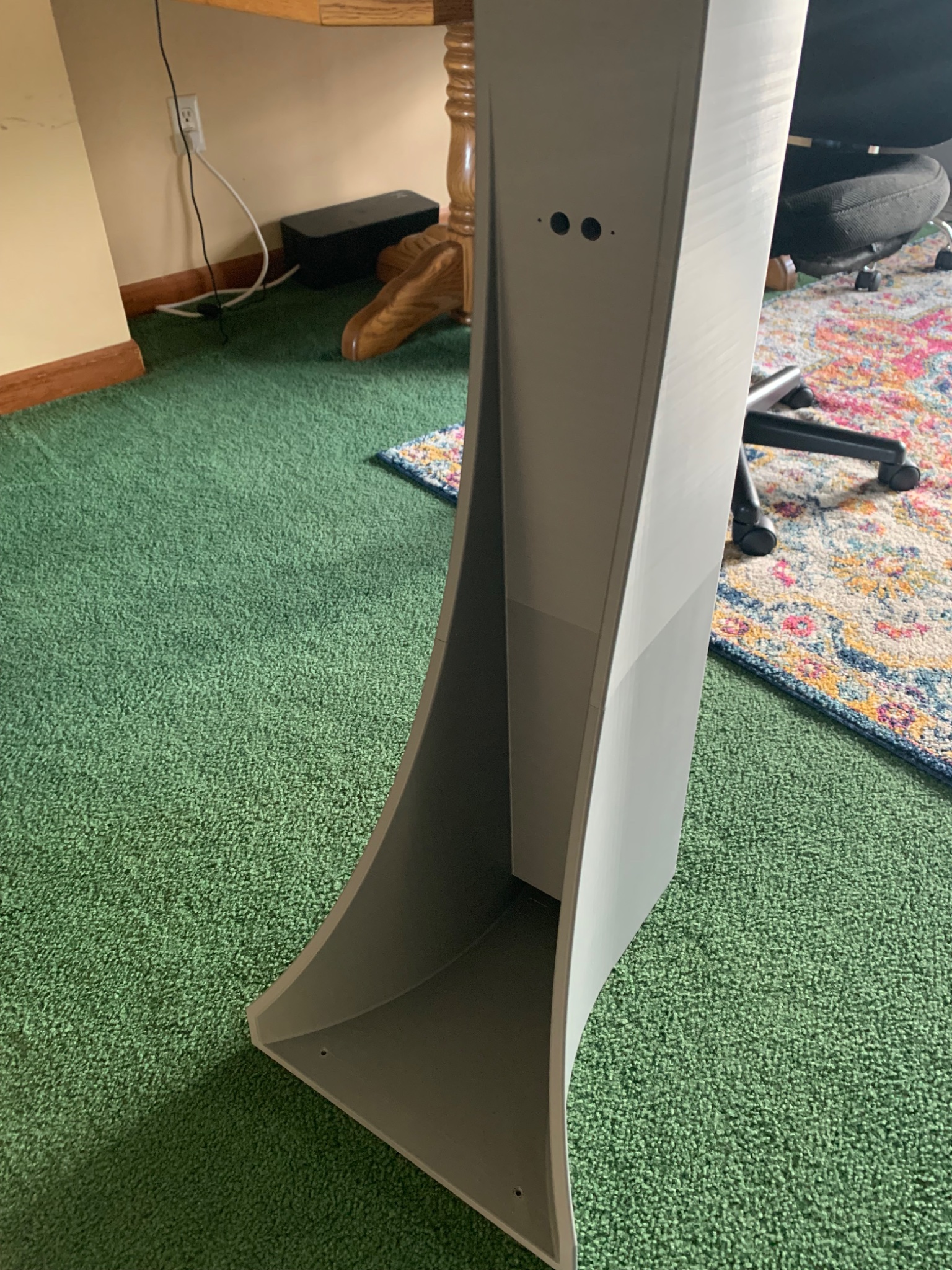

I was able to 3d print these and have Fostex FF85WK in them. The back horn is a little bigger than the original XR design. I have not decided what color to finish them but been listening to them for a month or so. Listen to the video with good set of ear phones and turn it up. I hope the link works, pretty good bass for a speaker with a 3 inch driver. The amp is a type 45 SET but running type 46 globe, 1.25 watts.

Hi Tiverson, if you don’t mind, please share your STL model files of the speaker here for others to give the 3D print option a try. It’s a beautiful speaker with the curved wings. Do you have any internal photos before assembly? Also, what was your print wall thickness and internal hollow void density for the walls as 15mm is quite thick.
Thanks!
here are the stl files per XR request, now this is for the Fostex FF85wk driver so if you try a different driver, it may not fit. i do have the model and i can put in different bolt pattern and different size opening for a different driver, but that takes a little time to do. you will need a a 3d printer with at least a 400mm x 400mm x 450mm build volume. It took the bottom half 10 days and some hours to print, you may be able to cut that down by bumping the speed print. also this is for diy for yourself and not to be sold commercial, just want to put that out there.

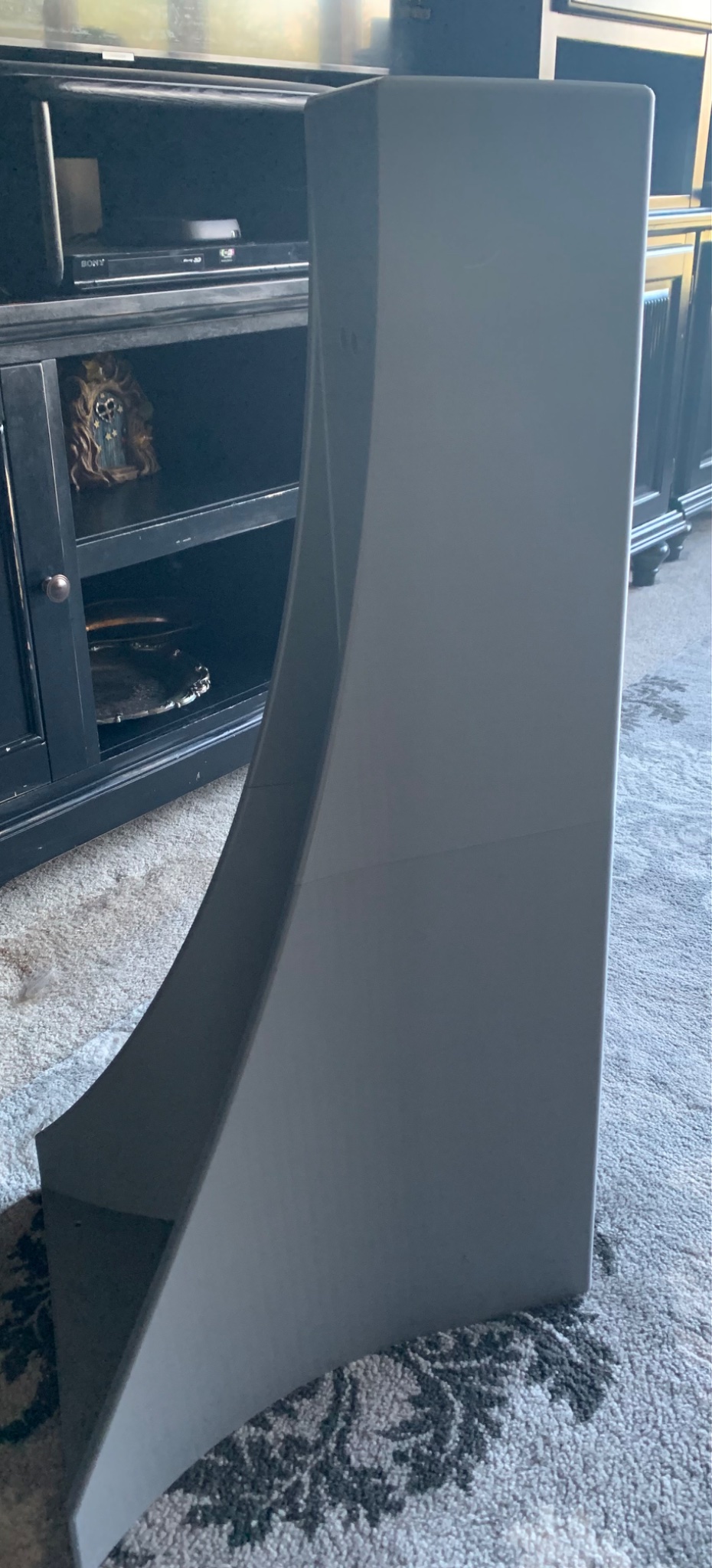

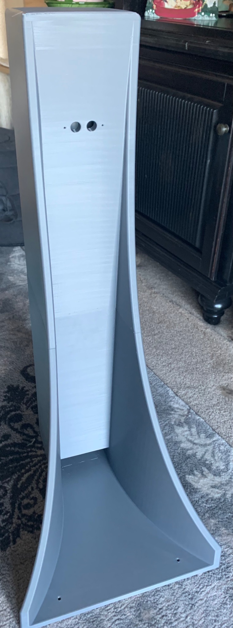

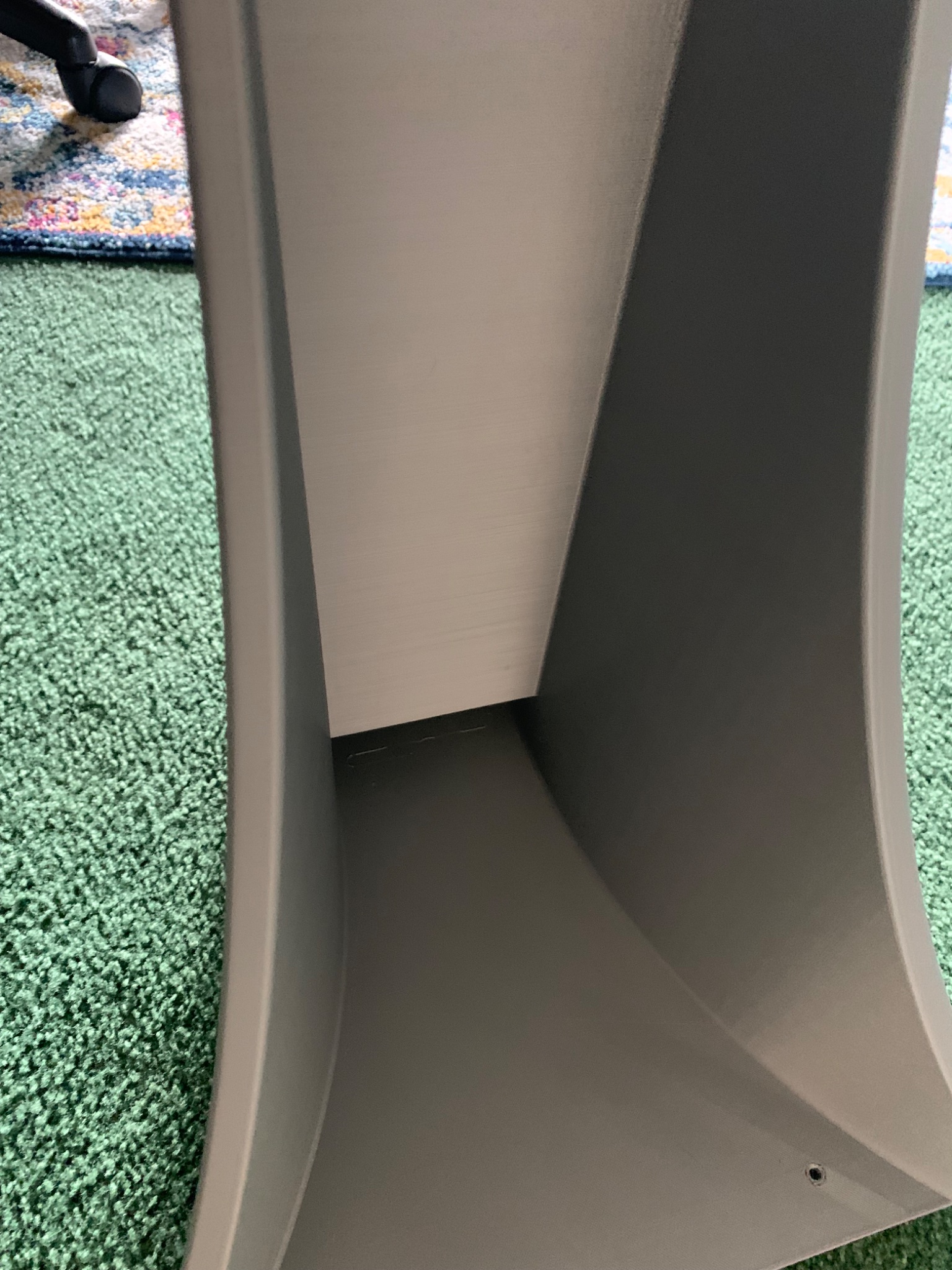

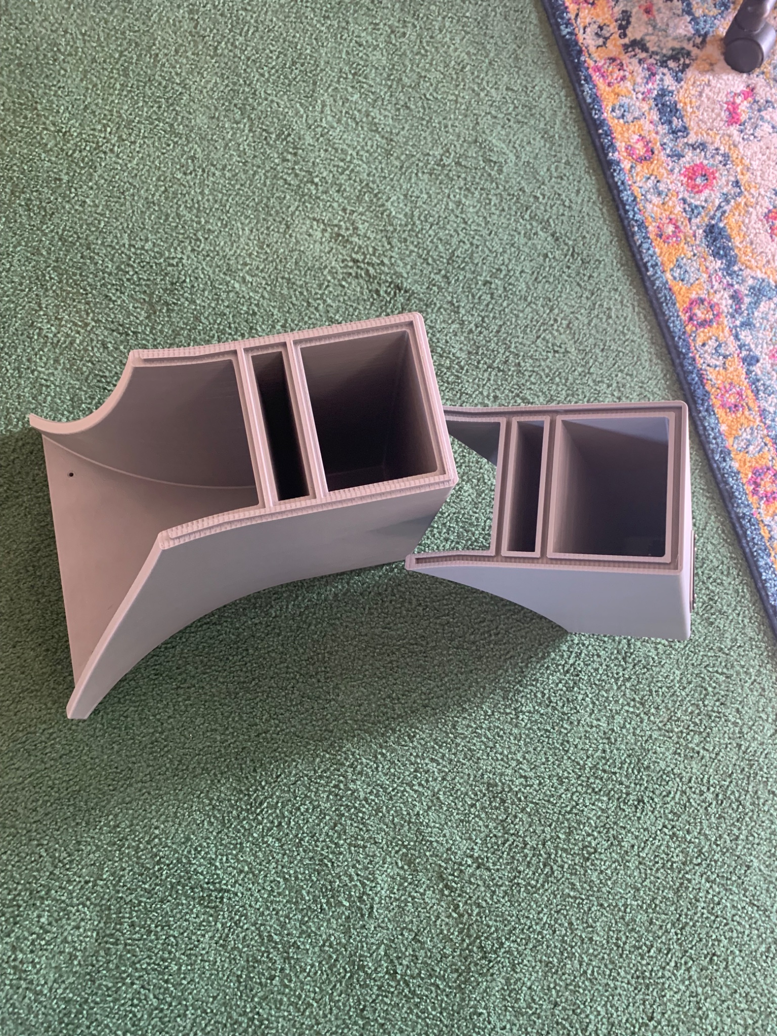

Here are pictures of the two haves. The joint is tongue and grooved so they are fitted together.

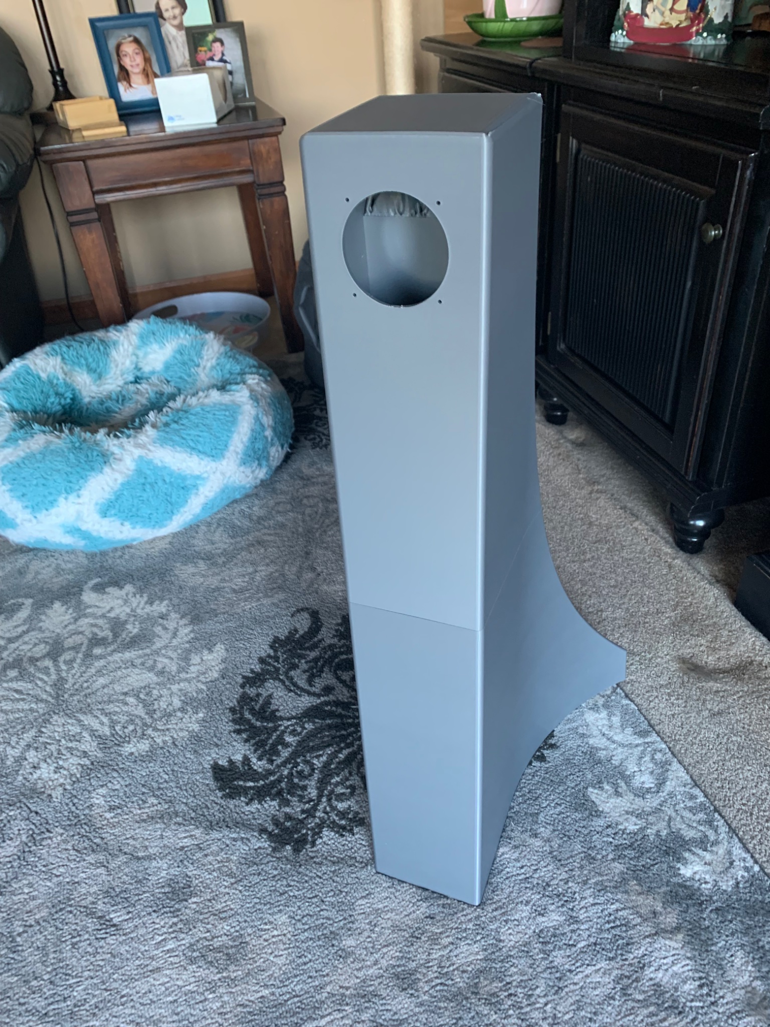

Thank you, Tiverson! Nice touch with the tongue and groove. I think a popular driver might be the TC9FD. If I recall, many 3.5in drivers have the same cutout hole circa 2.9in to 3.0in dia and a similar screw hole base diameter. The FF85WK is a bit smaller at 2.9in and TC9FD is 3.0in so would require some enlargement with a Dremel tool etc.
More picture of the prints before assembling. Also I tapped the m4 holes for the binding post. If anybody builds these please post picture on this thread or XR forums. Merry Christmas all!

The datasheet is here but it’s not very clear what the hole diameter is based on the sheet. The info from Parts Express says the cutout hole diameter is 3.0in and that’s what I remember using. Hence, the FF85WK was compatible, being 0.1in smaller.
https://www.parts-express.com/pedocs/specs/264-1062--tymphany-tc9fd18-08-spec-sheet.pdf
The TC9FD has same cutout as the premium ScanSpeak 10F/8424 which would work well in this design as well.
