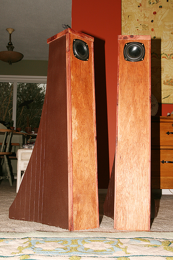

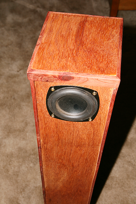

I finally got around to building a pair of FH3 Foam Core Mini using Aura ns3-193-8a1 drivers that I had on hand. I basically used the dimensions That X provided a year ago with one modification is that I changed the back of the flared sides to 10" instead of 12.
The build didn't go as well as it should have; they aren't square- more a parallelogram 😱.

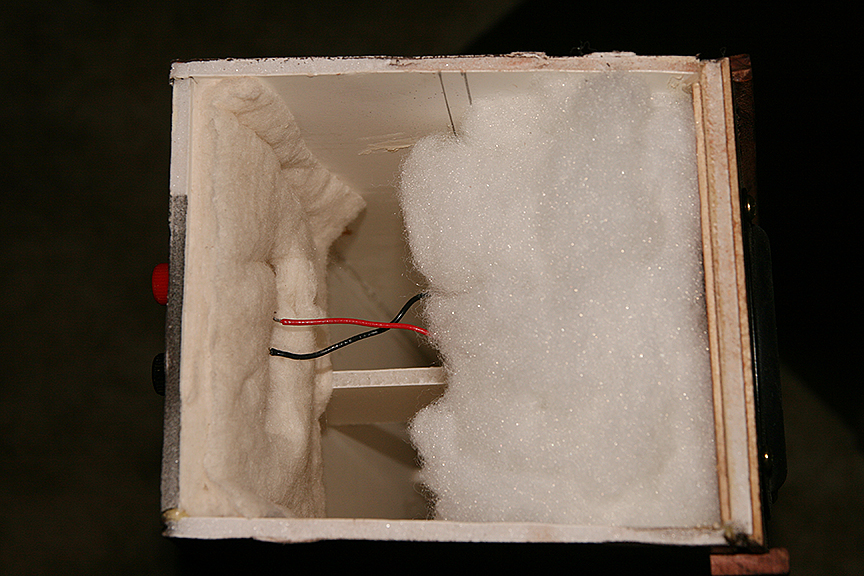

I only had enough felt to cove the back panel and used poly stuffing around the driver.
Sound is fairly good the mid and upper range is very good but lacking a bit in the bass. I'm still messing around with the stuffing as you can see in photo 3.
This is a good fun project- Thanks X for getting this one started 😀

That looks great with the stained plywood! Congrats on another build. You were going to build a Met that I sim'd for you at some point or did that morph into the 24 in Cornu? The stuffing makes a huge difference - very light amount below driver - loosely pulled out and just an inch or two.

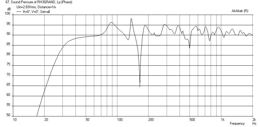

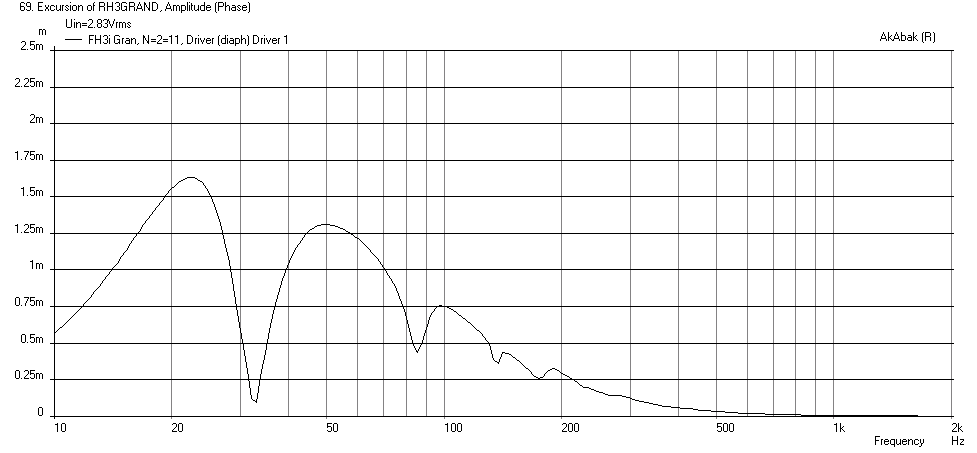

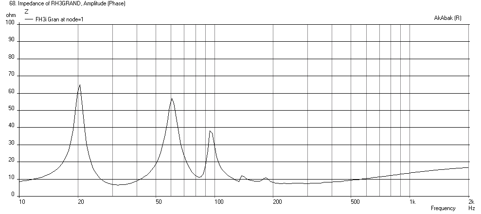

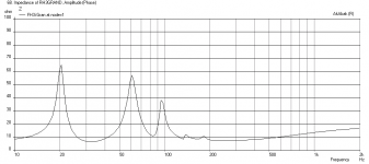

Supersized variant with Dayton PS220-8
I have been looking at a scaled up variant of this speaker using the Dayton PS220-8 8 inch point source driver. I am surprised we don't see more projects around here with this driver which has some very nice specs.
Scaling this speaker by 2.3x all around (almost 6 ft tall x 10.4 in wide internally) you can get some good bass response with the PS220 driver. It will need a BSC circuit though to match the bass with the mids and highs.
Here is what I was able to get with the simulation for a speaker placed 3 ft away from back and side wall in a corner. It is so big I figured you have to put it in a corner to get it out of the way.
Maybe a possibility for a lightweight build with 1 in thick Corning pink XPS foam sheathing? But then a speaker this big with a nice driver deserves wood - although I would hate to have to move it with the full weight.
Sims assume a 1.5mH+10ohm+1uF cap all in parallel and wired in series with driver
