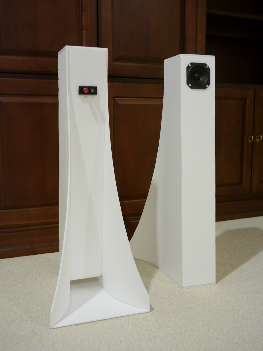

Update on sound: after letting my new drivers break in for 40 hours, these speakers are sounding fantastic! I am again getting that non-stop grin 😀 when I listen to them and just want to try more and more CD's. The imaging, sound stage, and clarity are superb. With the 3.5 in Vifa, of course you cannot expect deep bass, but I think I am hearing stuff reach down to 50 to 60 Hz and it is wide - since it radiates from the back and reflects off the wall. The bass that is there is very clear, well-balanced with the mids and highs, and has punch, it is not boomy. The speakers work really well with jazz, vocals, chamber classical, and pop.
After hearing how good they sound driven by a Lepai 2020+, I decided to hook them up to my old Yamaha power amp (45 W/ch at 8 ohms). WOW is all I have to say, the bass extension is now remarkable! I am only running the amp with the volume knob at the 10 'o clock position and the sound is amazing. I can really feel the bass much more now. The Lepai in stock form with its puny power capacitor just doesn't have enough oomph to drive the Vifa's to an excursion that can produce the nice bass in this enclosure.
Anyhow, I am very happy and can't wait to get back to listen to them again. 🙂

They look really great 😀

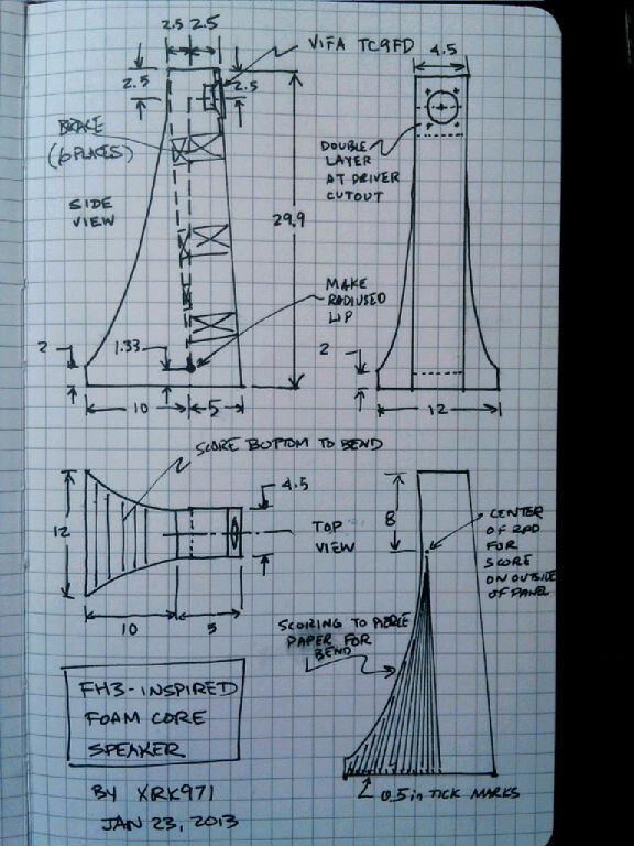

Is there any chance you could could post some plans for those of us that are somewhat horn challenged but would love to build a pair 😕

I can post some plans but the easiest thing to do is to use the published FH3 plans and modify key dimensions with what I have on post 1. 29.9 in tall, 5 in deep, 4m5 in wide, 1.33 in gap for horn exit throat.

Let me know if you need more details on the plans, that was what I was able to send you while on the road armed with nothing more than my notebook and a cell phone camera. Refer to the photos to get clarification on the bracing, etc. Looking forward to seeing your build.
Good luck!

Hi xrk- I was meaning to get back to you - thanks for the drawings. I got sidetracked with an amp project to go along with the 18" Cornu's. One thing always seems to lead to another. 🙂

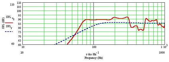

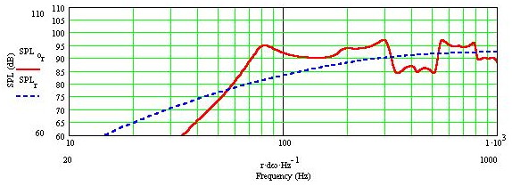

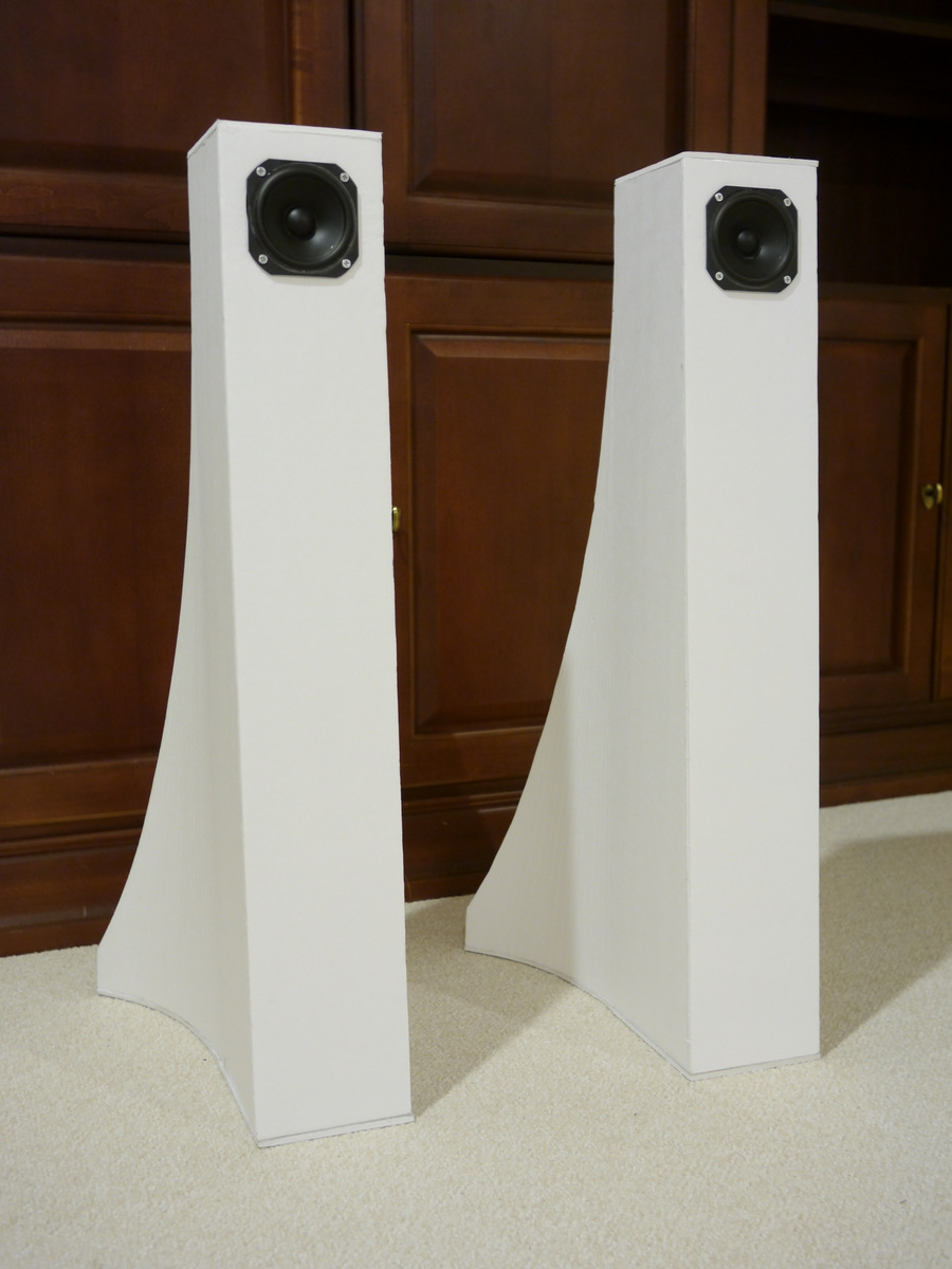

I have begun building the FH3 inspired foam core speakers to give the Vifa TC9FD a try. Just for fun I ran a simulation in MJK's MathCAD worksheets. Modeled as an MLTL (similar to a Metronome, just folded and with a rear firing port instead of down firing).
The stuffing/lining should improve the suck-out in the 400-500 Hz (I hope).
Cheers, Jim

Jim,
Thanks for doing the sim on MJK. Did you use the dimensions I have on post 28? How did you handle the rear horn? My measurements actually go down a little lower than 80 Hz. Looking forward to your build. I think KenLBird said he will be building it too.

Hi xrk,
I used your dimensions for the enclosure minus the 'horn' behind the port. The MLTL worksheet has no provision for dealing with that. (I also didn't bother with the later parts of the worksheet where you enter further details of the enclosure, etc.)
To better simulate, you would have to use the BLH-sections worksheet; being lazy, I didn't bother going there, as it would mean learning how to deal with that sheet. Maybe someday.... or maybe not...
BTW: I am simplifying your design by making the 'horn' behind the port a straight (as opposed to curved) expansion. Yea, lazy, lazy, lazy.

Jim,
The curved sides are easy and their difficulty to execute shouldn't be over-estimated. It takes 15 minutes to score the lines on the side to allow curving before you glue it on. Make the base curved with the flare out. You have built cornu before so know how easy it is to bend, hold, tack with hot melt and you are done. It looks and sounds better with curve - gives you 3x gain on horn expansion and adds stability to base. Trust me on this 😉
One other thing, since you have benefit of sim, try reducing terminus gap from 1.33 in to something a tad smaller. It should pull bass extension down lower if that is what you want.

It's actually kind of surprising how good the sim is given the crude scaling I did which shouldn't have worked given the feedback I got on how nothing depends on Sd. Lucky
I guess? If you can do me a favor and run the sim with the params for the FR10 driver I have above - keep dims the same. I am wondering what a swap would do.

Guess you got lucky. And the reason I decided to proceed.
Using your original dimensions, the FR10 doesn't look nearly as nice. An expert like Scottmoose could probably adjust it in a jiffy to get a good alignment. I expect I would need to fiddle for two or three weeks to fix it.
