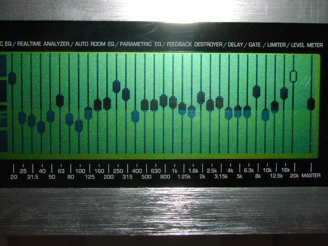

Fertin Frquency Measurements
This is the left channel after Auto-Q function has run. Scale is +-16db. The readout shows the corrections needed to get a 0db level 20hz to 20khz so you need to invert the scale to get the actual in room measurements for left channel only. You can see that the L channel needs 9db of boost to be flat at 20khz, right channel showed 5db of boost needed. You can ignore the stuff 40hz and below because there is construction going on across the street here in Tsimshatsui (new train station) and the vibrations are being felt.
Otherwise more or less similar to the summed measurements with the SPL meter although with greater degree of accuracy esp. on top end.
Hope this completes the picture.
