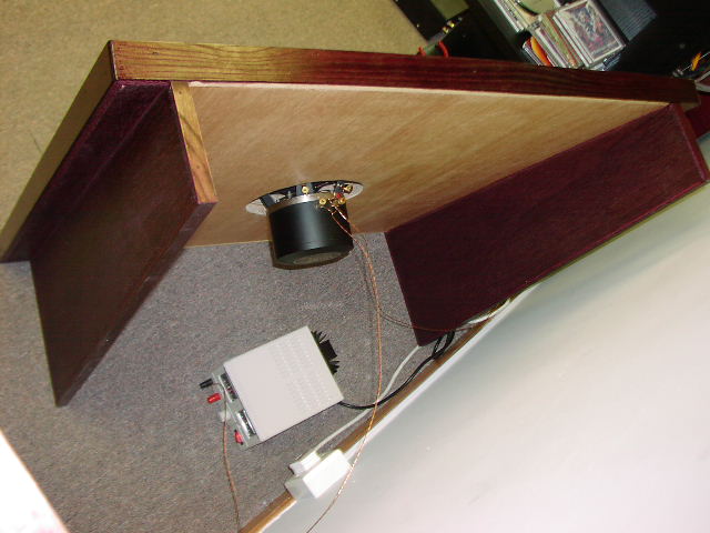

now the report

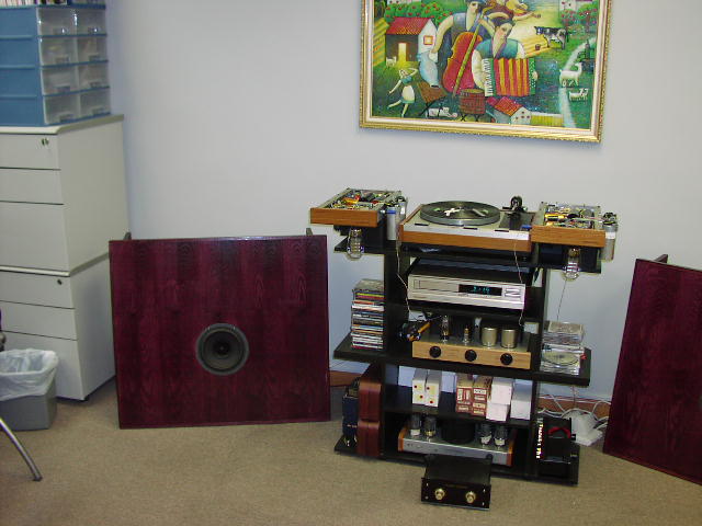

You can see the new baffle is drastically different from the first one I posted. It's built according to the golden ratio used by Japanese audiophiles as previously linked. I knew the driver would be close to the floor, and it was with qualms I had it built, but when I actually saw it come in the door - my heart sank! The bottom is only about 23cm off the floor. I had visions of listening from the orchestra pit.
Here are the measured frequency responses in my room using the Sheffield setup and test disk:

So the sound is now coming in at 40hz and saying goodbye at 16Khz (if my SPL meter is to be believed). Also there is a nice hump from 80hz to 250hz which now gives somes weight down there. Measured in position as shown in the picture.
Image height doesn't seem to have suffered. I still get sounds coming from my musical reverie painting. Low bass is pretty good. Overall tonality is much more balanced.
But why does this work? Is there really something going on with this 'golden ratio' thing? The configuration is counter to all the advice given about keeping the driver 70cm off the floor.
I'll play with positioning and interested to receive any suggestions about it.
Another issue. The former attached to the driver had started to scrape the cylinder. I don't know the proper procedure but here's what happened: The nuts attaching the suspension came loose so the driver went off centre. I loosened all three nuts so the suspension was loose, then slid a thickness of paper around the diffuser into the gap (from the front). This kept the former equidistant from the cylinder walls; tightened the 3 nuts up and it worked! No more rubbing.
OK, that's the latest installment. I think we're closer to home now.

Wow, 10db down from 10K to 16K. I'm having a hard time understanding how this thing cannot sound dull, rolled off, and lacking in detail. Do cymbals, high-hats, etc., sound real with these?
What mike are you using? Most of the mikes are OK at mid frquencies, but when it comes to both ends of spectrum they might be deceiving. You ears are the best test. If the highs seem to sound OK the mike lies.😉
I concur. The top and bottom octaves are often dodgy unless you have a pretty high quality set up. That Radio Shack misery isn't even heavy enough to be a good paperweight.
Still and all, -10dB >10k and -10dB <70hz is not particularly impressive.

in room frequency measurements
That 40 to 20K +- 3db stuff is only free air/anoechoeic (sp?) chamber measured. Real room measurements are all over the spectrum. Also, as said, my TES SPL meter may not be that accurate throughout the range. But I can assure you the Fertin's sound great, with sparkle on top, full midrange and now bass. Later, I'll be using the Behringer to measure again. It comes with a microphone that is sensitive on the top end and probably more accurate throughout the range.
All the speakers I've measured in room (office and home) are bumpy like that. sometimes +- 15db. The Fertin was relatively smooth compared to others. The mic used was the one attached to the TES SPL meter.
An interesting thing about dipole dispersion: Just before putting the golden ratio baffles in place I was testing the Tannoy GRF with the Sheffield test record. Placed 1M away from the wall, they had LESS bass (50hz) at the listening position than the Fertin/Golden Ratio baffles. But at a position physically standing between the speakers (standing at my turntable), there was a ton of it. But the Fertin's had good bass at the listening position, but a little LESS standing at my turntable.
It's an education.
