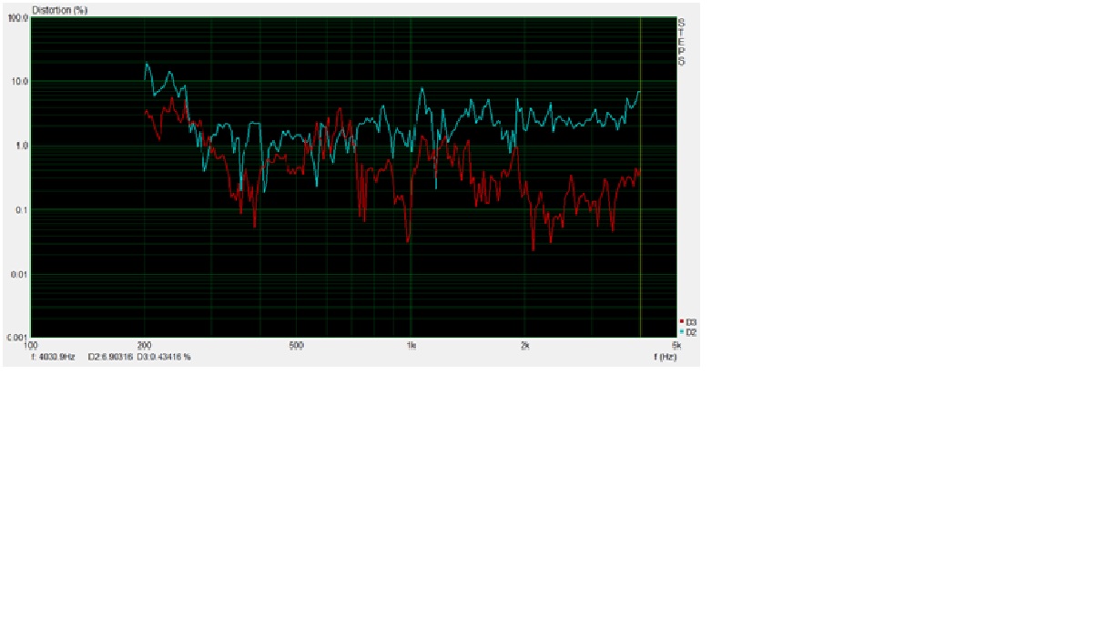

10NDA610 104db distortion
104db

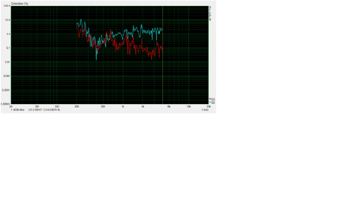

10NDA610 110db distortion - No Preamp Clipping!
The mic pre was a little hot in the previous graphs. This was done with 110db pink noise at one meter. Of course individual tones are much louder during tests. Was reaching around 121db during the sweep. Not sure what the mic is contributing. Wish I had an Earthworks or the like.
I think this is a fair showing for the power levels invloved. You'll only hit these levels for very brief moments domestically when showing off or your own curiosity.
Not going to have time this weekend for off axis charts but it's about -6db @ 2khz 45 degrees off axis. If you want perfect polars with an AMT it's probably not going to happen...but it will sound killer.
for the distortion measurements you can set the power level and simply move the microphone further from the speaker.
If the measurements are not being corrupted by the microphone, the relative distortion levels will be the same for both measurements. If the mic is compressing, then with the mic further away, the distortion products will fall off more rapidly than the fundamental signal measurements.

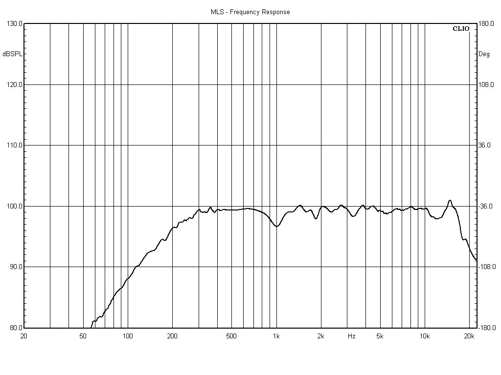

Midrange 10NDA610 with 2nd order low-pass only (active 15" woofer below) and Beyma TPL200 with 2nd order high-pass. Still in the development phase, dimensions of the front baffle makes big difference. Commercial product, so no further information, sorry.
