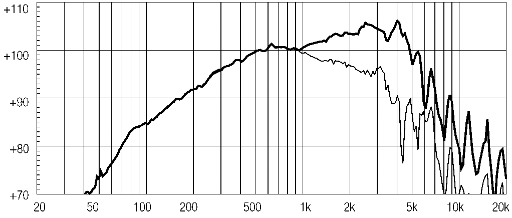

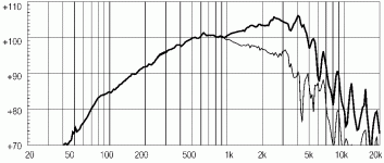

Have you seen dispersion curves you can point me to?
Thin line is measured at 45 degrees off axis. Ideal for AMT (TPL) or horn loaded high frequency driver.

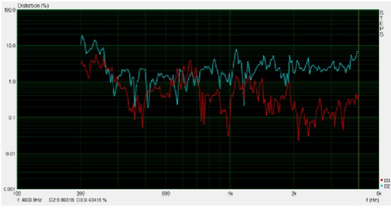

Was looking at this driver again. The measurements I posted a couple years ago were actually in the mid to high 120's at 1m. Recently discovered that STEPS was putting out more signal than the other programs I use. No wonder it was loud.
