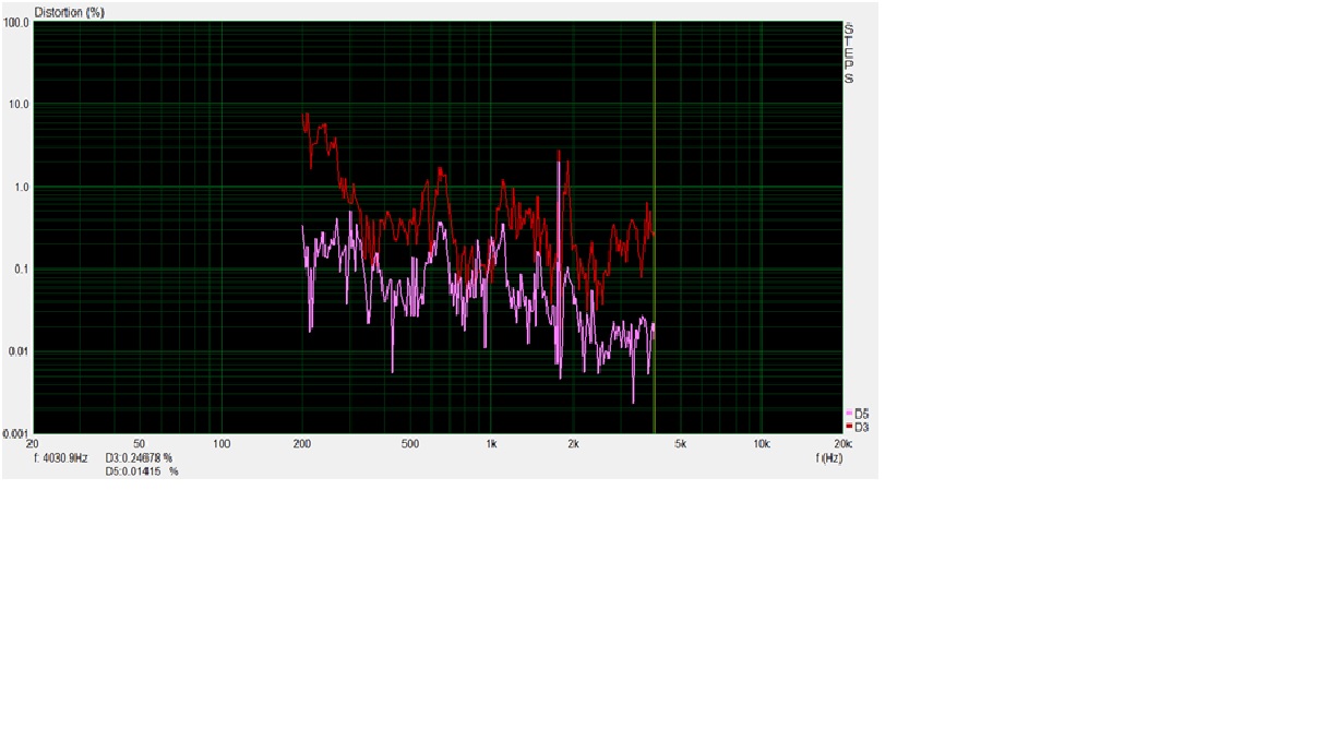

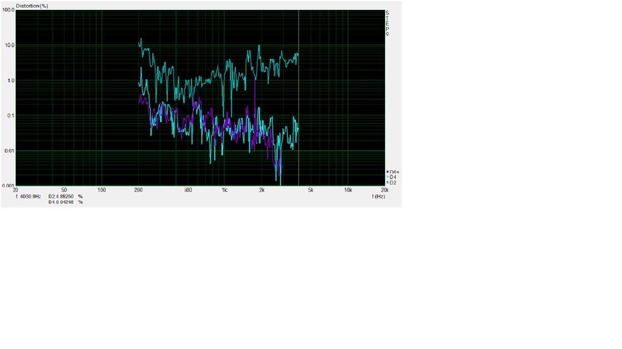

10NDA610 110db distortion
Quick non-optimized distortion measurements.
- 110db @ 1 meter measured with pink noise using a CEM DT-85A
- 2009 ECM8000 uncalibrated measurement mic @ 2 meters into A&H ZED14
- 40 liter non braced 3/4" chinese birch box with minimal lining
- Bandpassed @ 150 and 4khz with LR12 slopes.
- Test signal using ARTA STEPS from 200 to 4khz
- 123.1 db max spl @ 1 meter with one channel of a QSC PLD4.5 just shy of clip indicator.
