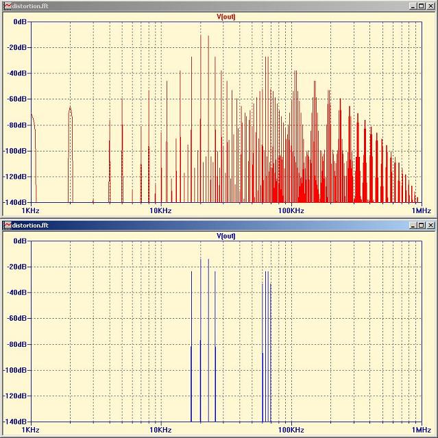

traderbam said:Yes.
Blue is spectrum of 20kHz + 23kHz signals through a perfect cubed function, y = X^3.
Red is spectrum when a modest amount of NFB is applied.
The worse your non-linearity the more gain you need to fix it, but enough gain will fix it. It's when that gain is poorly implemented (as in y = x^3, that feedback gets a bad rap.
Unfortunately in the world of discrete electronics we don't have access to super-beta's like an op-amp designer has.
It's not that simple, feedback can't fix, just attenuate. You can't increase feedback as you need, your amp would get unstable.
To keep a feedback amp from oscillating, you have to decrease feedback with increasing frequency. But, this decrease with frequency gives you the problem that the higher order harmonics generated by the feedback itself will not get attenuated to acceptable levels.
If you look at traderbams fft, feedback will not be able to reduce the harmonics generated above 100khz.
You see, whether you use feedback or not, the first step in amp design is to reduce open loop distortion.
Mike

This may seem bizarre but you have to consider both the mathematics of a feedback system and the way our brains hear things. NFB reduces the total distortion but is the total distortion the only factor in good sound...or even the most important factor?
I think the original debate was about Rod Elliot's claim that NFB does not introduce new frequencies. This is incorrect EXCEPT in a linear system. As MikeB implies NFB will reduce its own splatter as it is increased but only up to a point where it becomes unstable.
