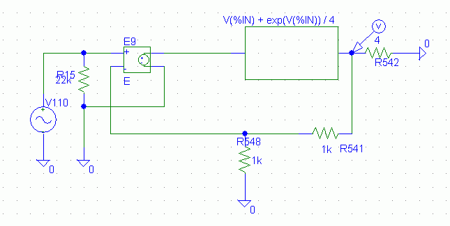

Brian, see attachment for spice circuit i used... I took the expression evaluator for different functions.
I did some more research. Using the equation "Cg = K / (1 + K/Og)" for feedback loop (Cg = closed loop, K = feedback divider, Og = open loop) with unity gain, you end up with a gain function y = 1 / (1 + x), where x is 1 / open loop gain.
Looking at the taylor series for y = 1 / (1 - x) Wiki You see that this functions is simply a sum of all polynomials.
This should mean, that a closed loop transfer is always rich of harmonics, if x is not constant. If x is constant, the result is also constant = distortion free.
I think, that if open loop distortion is reasonably low and feedback not too low, this effect is negligible.
Mike

Ok, thanks for the explanations Andy and Mike and for the Baxandall articles, Andy. That's very helpful. It looks rather involved so I'll study it carefully and I'll consider your model, Mike, and get back to both of you as soon as.
Brian

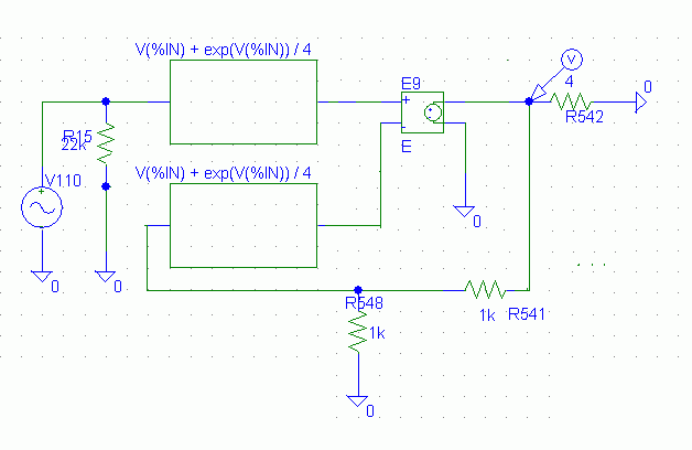

I was thinking more the general case. For example, is the circuit below equivalent to MikeB's (ignoring for the moment the exact transfer function at the feedback return node might not be the same as the positive input)? The two transfer boxes and summing nodes represent of course components of a single device. If not, which is more representative of the general case?

Oh, I think I see what you're getting at.
Your diagram is equivalent to Mike's but if the two nonlinear blocks are different, then that's a more general case. In that more general case, the output of the nonlinear circuit would be a function of, say, V1 and V2, but it could not be expressed as purely a function of the difference mode voltage V1-V2.
Another way to think of that is the nonlinear circuit's output being a function of both difference-mode and common-mode input effects. The sims that were done in the Cordell negative feedback thread with the BJT and JFET would take into account common-mode effects via the Early voltage in the BJT case and the non-zero output conductance that's a function of Vgs in the JFET case. This would be handled internally by SPICE. I think the models that ware picked were just typical devices like the 2N5551, with no attempt made to manipulate or determine the effects of the Early voltage. In retrospect, I guess the Early voltage should have been removed from the models so the default value of infinity would be used. That would put the results closer to Baxandall's theoretical predictions that neglected the Early effect.
The idea was to isolate and simplify as Baxandall did. Since those sims were intimately connected to Baxandall's approach and results, it becomes confusing to discuss them outside that context. So the response to questions such as "Why was it done in such-and-such a way" becomes, "Because that's how Baxandall did it. The purpose and scope of the problem were to first duplicate his results, then extend them a bit". If you're not familiar with what Baxandall did, the article is a very worthwhile read. It would also make the discussion easier by putting the work of the Cordell feedback thread into context.
