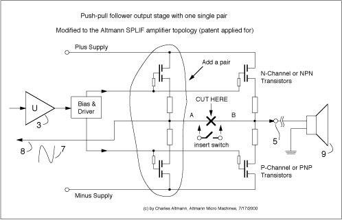

Any comments on this design?
the author claims the following
"The SPLIF (split feedback) topology has all the benefits of global negative feedback.
Like good linearity, very low distortion (or the distortion you like) and as much power, as you desire.
The SPLIF (split feedback) topology has none of the drawbacks of global negative feedback.
It does not try to control the speaker. It does not even notice, that such thing as a speaker exists.
Stability problems from reactive loads are not an issue with the SPLIF amplifier topology.
Yes it seems to be too good to be true, but there is even more to come:
By connecting the outputs of the output stages (4&8) with a switch, you can switch feedback on and off.
So you will actually be able to actually hear, what feedback does.
You can do it yourself with your existing amp.

Rubbish. The reactive load currents are reflected back through the stages and still appear on the driver or pre-driver outputs.
What this technique achieves is a reduction in speaker induced feedback to the inverting input node of the amp and removes one very linear stage (output follower) from the Global feedback loop. But it is still a global feedback amplifier (it includes the three stages of a Lin amp topology inside the NFB loop).

It's a clever idea. He has sort of made two output stages in parallel, one feeding the speaker and the other a dummy load. By taking the FB from the dummy output he corrects some of the distortion of the speaker output while mostly isolating the FB from the impedance effects of the speaker. It's a half-way house between GNFB and no FB.
Like Andrew I don't think his claims are water-tight but I can believe that his circuit sounds much better with the switch open.
"The SPLIF (split feedback) topology has all the benefits of global negative feedback."
It doesn't have the benefit of sensing the distortion at the speaker output...so there is distortion that the FB system cannot reduce.
"Like good linearity, very low distortion (or the distortion you like) and as much power, as you desire."
Sure.
"The SPLIF (split feedback) topology has none of the drawbacks of global negative feedback."
Not sure that it has none of the drawbacks. It depends what you recognize as NFB drawbacks. It's not as global but is still partly global as Andrew points out.
"It does not try to control the speaker. It does not even notice, that such thing as a speaker exists."
See above.
"Stability problems from reactive loads are not an issue with the SPLIF amplifier topology."
See above. Less of an issue, sure.

By coincidence, I proposed a "SPLIF"-like topology the other day here. I think with a good (that is, linear -- e.g. by means of local FB) output stage this is an worthwhile approach. It's maybe somewhat irrational but I'm quite attracted by the idea of seperating FB loops in terms of the signal domains they handle -- one for voltage (global FB), one for current (local FB in the OS). OTOH there are good designs around which do just the opposite, making the error signal for the global loop *very* output current dependent (but in a very controlled way, by using a OS with a high but nevertheless stable output impedance).
Mr. Altmann is a quite controversal figure in the scene, I'd say. I agree with Andrew that his conclusions on SPLIF properties are not all correct, especially the stability margin stuff with odd loads. It is an as global loop as it was before, it only "seperates out" the load current from the GFB. Not sure what it does WRT crossover distortion... with class A I feel it's working well.
