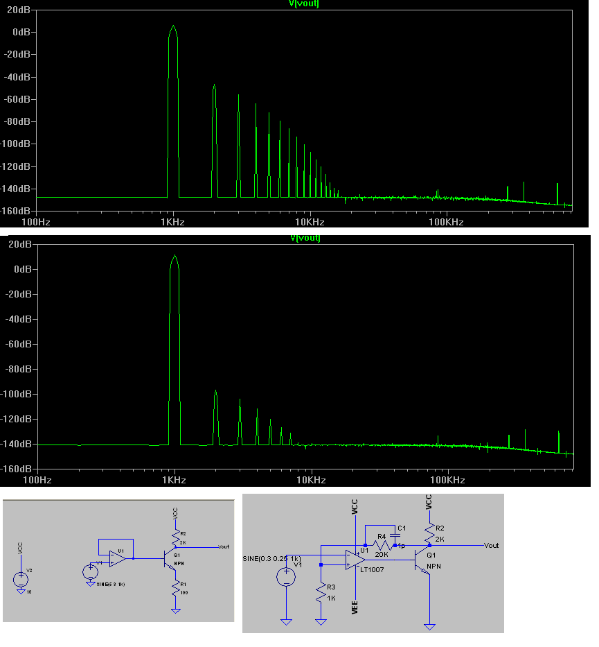

I maybe my simulations are wrong , but i could not see any addictional harmonics above -140db , when the feedback was applied. Maybe erronous is to use so much feedback as op amp supplies.
First picture is without any feedback(only emitter resistor); second is with strong feedback with op amp in circuit.
regards,
Lukas

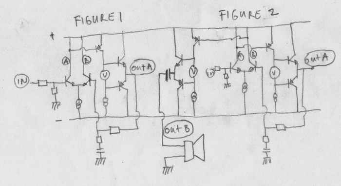

Feedback has it's limitation, especially when headed with problems in output stage. Crossover distortion is really heavy duty for feedback to fix. Maybe it's the main problem 😀
Figure 1 is a simplified power amp topology. The signal tapped from leg A of differential pair, and so on, feedback comes to inverting input.
To see that feedback has it's limitation, try to hear what is the sound likes from the signal of leg B of differential pair. So there is 2 amps left and right, but the feedback node only comes from the right amp. The left amp is open loop, so we must put cap at this output before the speakers.
By figure2 experiment, you will see that the system has a limited capability for fixing things. There's not unlimited energy to fix everything.
The worse the output stages are, the worse you will hear the sound from the left side of the amp (out B). If you biased both output sides very heavily classA, you will be able to hear good music from all sides of output.
If both side of output is low biased classAB, especially mosfet, you will notice that the differential will take side very much for fixing the out A and sacrificing (because there's nothing much power left for fixing after fixing out A) out B. Because feedback is taking side for out A, you can hear undistorted music here, but outB is very-very distorted.
