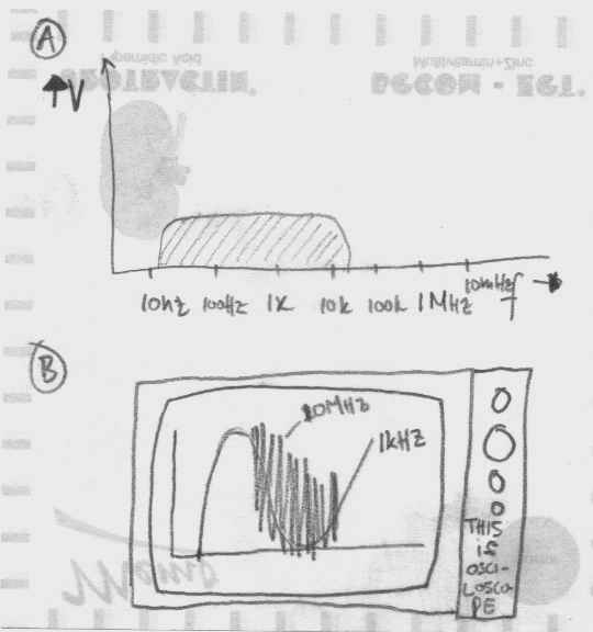

There are things that people not realized when thinking about feedback.
First : In a feedback amplifier there is the main cct and feedback itself. When arguing about feedback, people usually think (not realized) that the cct (that is subjected to feedback) is a perfect cct. That it will take forward gain and feedback flawlessly.
If they (not realized) thinking that the cct is already "perfect" then the one who makes the bad sounding must be the feedback.
In reality, a real cct is not acting like this ideal condition. Feedback will work at any condition, wheter the cct is smooth or have many bottlenecks, feedback will work it's duty.
In an amplifier, signal goes to base of transistorA, then from it's emitor/collector it goes to base of transistorB, then from transistorB's emitor/collector it goes to base of transistorC, and so on.
Sometimes there are "bottleneck", example : signal after transistorB's collector is not having the properties (impedance) of what transistorC's base is wanting. The more transistorB's forcing, the more "bottleneck" happening at transistorC's base. TransistorB cannot force transistorC's base to accept B's output if the demands of transitorC's base is not fullfilled.
A good example is a stage after VBE multiplier (this VBEmultiplier lies in VAS' collector). From here to the next stage there should be base stoppers. This is just one example, I just want to show that it is not the feedback to blame for poor sonics, but there are more important factor. The cct have to be as "blameless" as possible, for the audio signal to travel, before blaming feedback for anything.
I think that TIM is exactly this "bottleneck". The signal will stuck at one point because the previous stage cannot make the next stage accept what the previous is forcing.
About frequencies. We looked so much graphs that has the horizontal axis of f (frequency), like drawing A. In drawing A we see, from left to right, frequency is rising, from 10hz, 1khz, 100khz, 1Mhz, etc. Looking too much of this graph, again, people (not realized) think that frequencies above 20khz is located in far area in right direction. 10Mhz is located quite remote from 20-20khz so it will not matter, because it is very distanced from our hearing range.
But actually, when we see drawingB (this is osciloscope), if we have 1khz sinusoidal, where is 10Mhz signal? It is NOT located away from the 1khz, the 10Mhz signal lies WITHIN the 1khz sinusoidal. So I think behavior for frequencies above 20khz (and below 20hz) will certainly affect the spectrum of 20hz-20khz, because those frequencies (>20khz and <20hz) are not located distanced away from 20-20khz range, they are right there at the same place, right between this range. They can intermodulate each other, so it is not only the 20-20khz that has to be perfect, but we have to look also of <20hz and >20khz to make good sounding amp 😀
