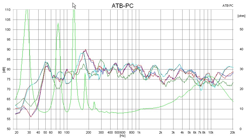

some measurements after all!!
Before it starts a lot of discussions ; these measurements are 1/6 smoothing IN ROOM measurements at Xanders home to find the optimal speaker and listening position!!
So they are NOT absolute but relative measurements.
The ATB system has some algorithm to include bass in-room measurements ; and you can leave the system on and move your speakers seeing what's happening on your screen.
And take some screenshots which you are going to see.
First pic : 2x imp. one time tweeter reversed. and 50cm spl centre of fe166.

In my previous post you see not much happening below 70 Hz.
This is because of the algorithm in the prog.
The concerti is to fast for the prog.
The bass needs some time to build up in the room.
So measure at listening posistion ; both speakers.
Notice the big diffrences dependent on different reflections !!
A proper 45Hz , in room is also possible!!

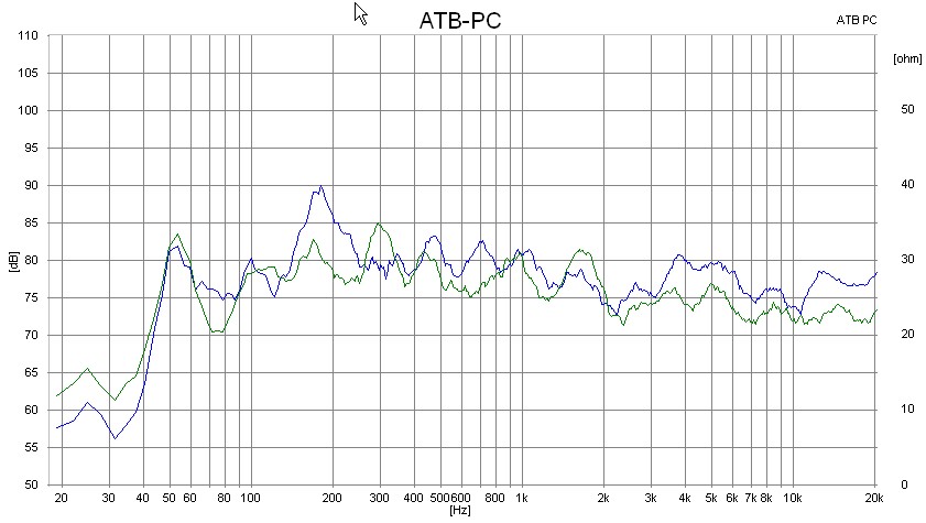

And for now the last picture.
A lot of curves with a lot of listening in between.
Xander's choice : light blue and green for the second speaker.
Almost 40Hz "in-room" ; not bad at all.
Holographic / ESL - like sound with FAST bass.
Xander said to me that after optimising everything it sounded at least 100% better than before.
They now have a price/performance ratio of 12 (Xander's words ; not mine!!......but......they are SOOOOOO GOOD!!)

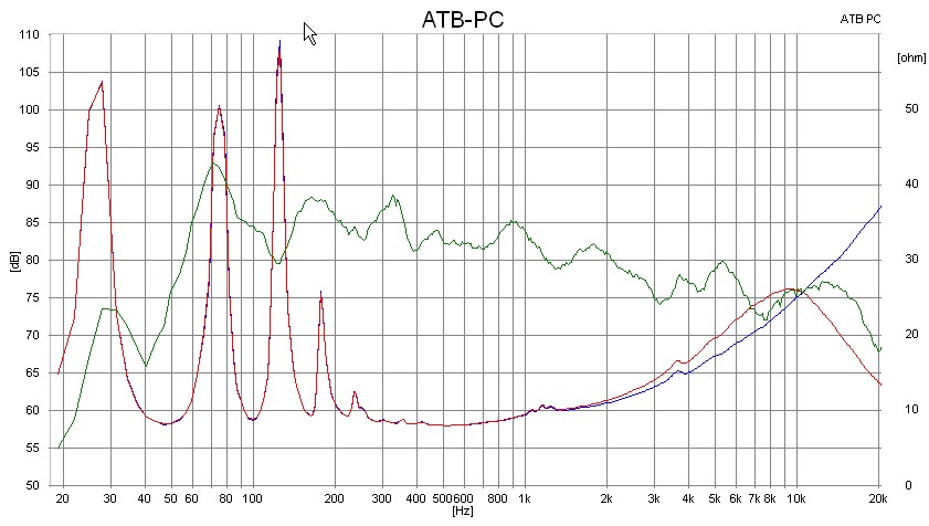

I am curious: what optimisation that Xander has done on the speakers? The three SPL vs. Freq graph differs a lot. I hope that I can have the speakers of the third graph.And for now the last picture.
Thanks Leon for bring us such a good design. I believe the 12x p/p is not exagerating.They now have a price/performance ratio of 12 (Xander's words ; not mine!!......but......they are SOOOOOO GOOD!!)
The left and the right print differs significantly. Was this due to the environment, eg. room etc. ? And I am wondering why all the measured SPL below 90db? I remember there is another measurement done by Bob Brines, which was done in a big garage and did show that the SPL vs. Freq was quite consistent with the driver's published spec, except some elevated bass.In my previous post you see ...

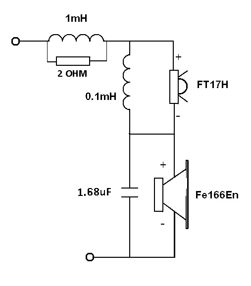

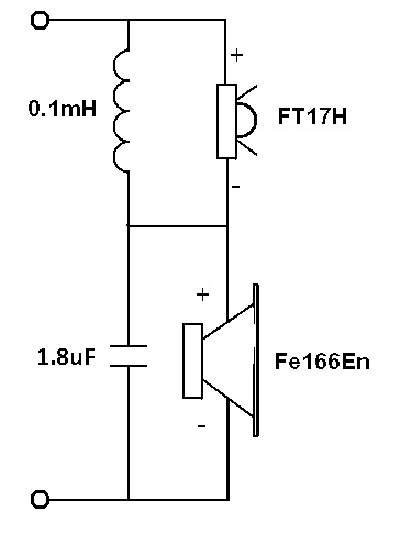

Final crossover?
Hey Dzius,
How is this crossover doing? I'm interested in trying to build this project too!
Has anyone flush mounted these drivers? I like the way that looks.
After I'd listen for a while I've decided to use a little bit of baffle step compensation and reduce capacitor value to 1.68uF. So my crossover right now looks like this:
I haven't done any measurement so far but while playing test signals I can hear 35Hz.

Crossover is doing very well I recomend it. I tried many other setups but this one plus First Watt F3 is probably the best. Baffle step correction is a matter of room acoustic and personal taste of course. I'm planing to test direct connection FT17 to the amp output with 1.68uF cap and 3ohm resistor in series too (just for research) . Nonetheless these speakers are just fabulous judging it by ears. They play live music not just reproduce it. You can't figure it out of measurments or specs. I invited friends who are musicians the other day to confront my stuff with their instrument sound memory. After playing many differente pieces of music their final opinion was very good.

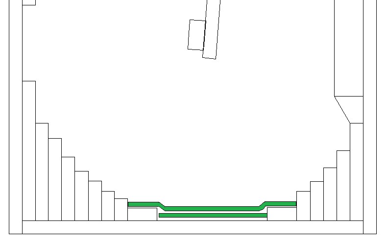

Target specs?
Do you have the line length and the pipe tuning? the target anyway?
also, your speaker pics show one that looks like one I've seen at humblehomemadehifi.com.
Yes, I also think it's smarter.
Took me several drawings to reach my target.
By placing just ONE panel different I succeded getting a hybrid horn that was without parallel pieces.
The other differences are a result of HornResp and AJ-horn.

You can adjust the CC by adding some woodblocks inside by ear.
