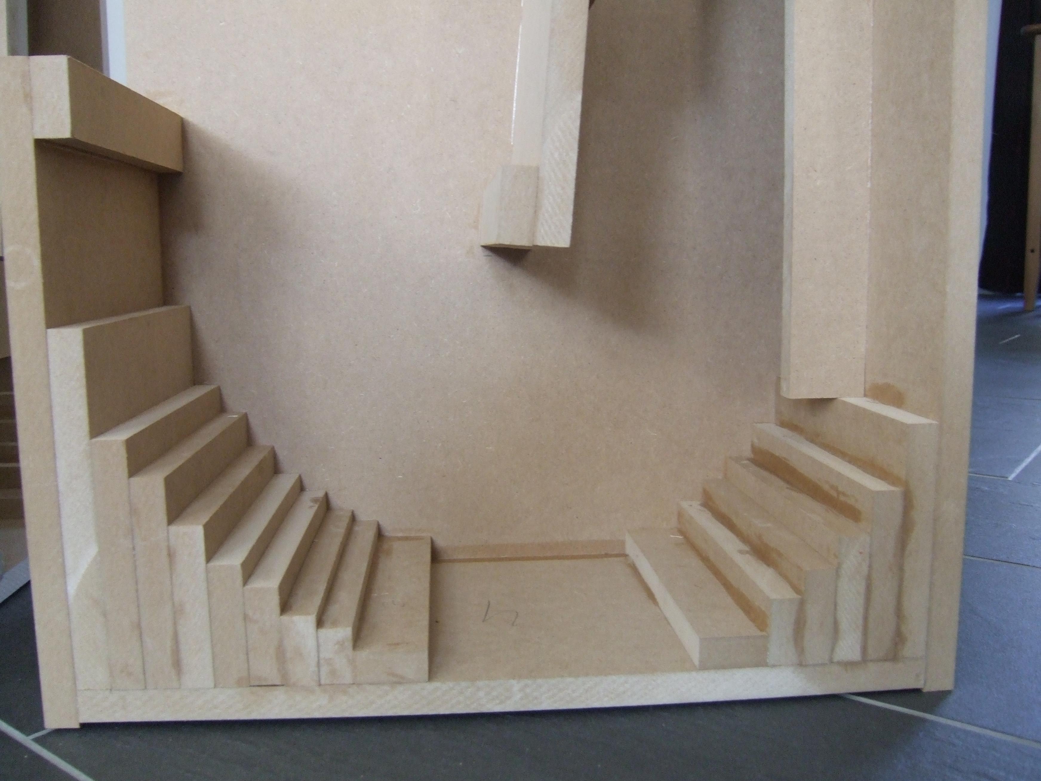

similar design but with strangely shaped mouth so called "k-slot contour"
Acoustic Horn - Backload K-Horn
Is there any practical point in using it instead of rectangular one ?

About the K-slot horn ; I've already seen it and took another look today.
Want do any discussion about the 2 designs. Seen that the other designer "set" the same smart angle in the top baffle!!
If you build a set of mine : make a removable front-lower-baffle with 2 inserts:
one square and one with an exponential slot and try for yourself!!
Give us your results!!

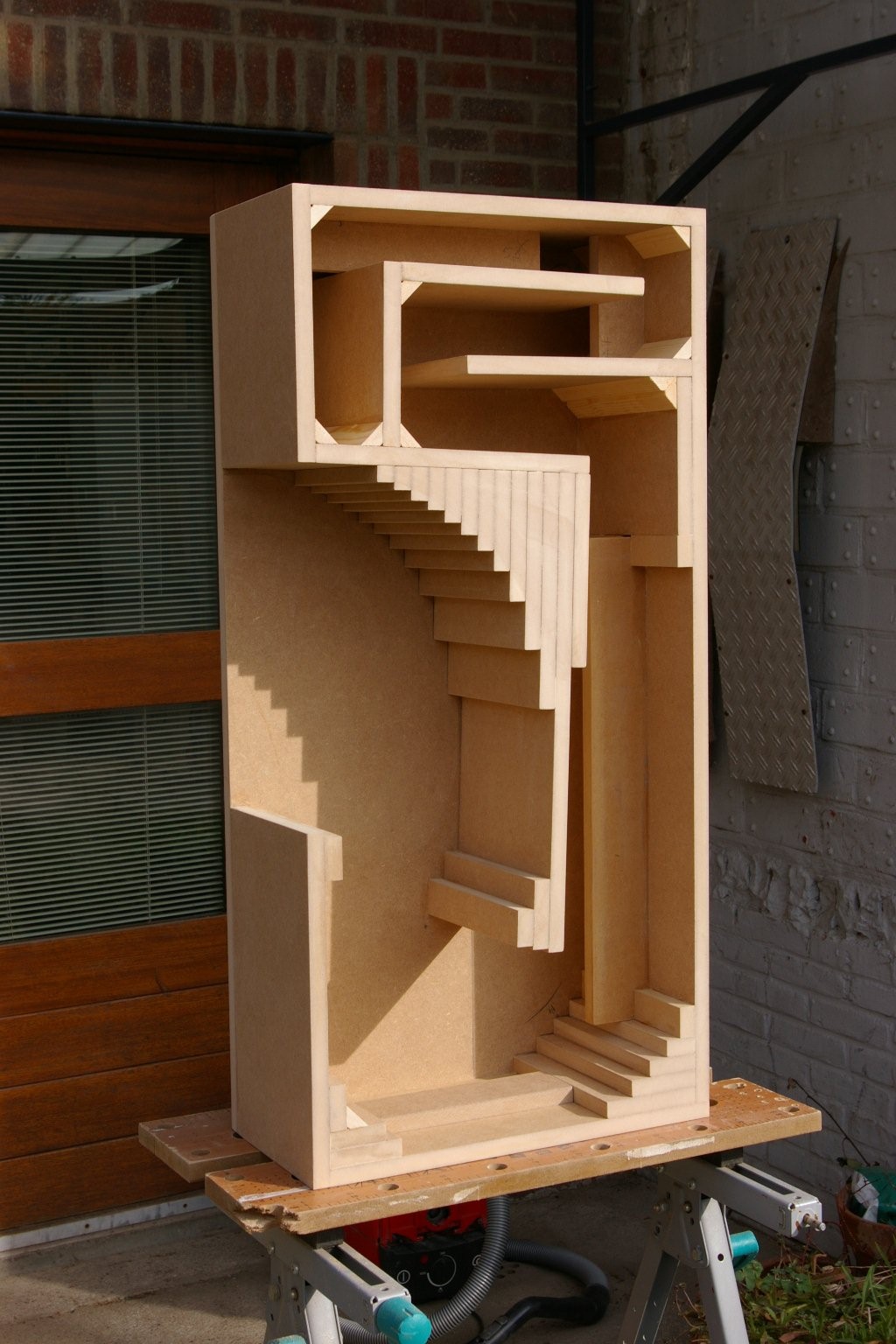

King Leonidas you're completely right
I just noticed that Bill Woods RCA-fan Backload K-Horn is very similar to your design, so both should works similarily good. Not only is the idea of removable front smart but very handy also. Thank you !

To Dzius :
If you want to do your own design , feel free to do so.
Don't change my design under my name!!

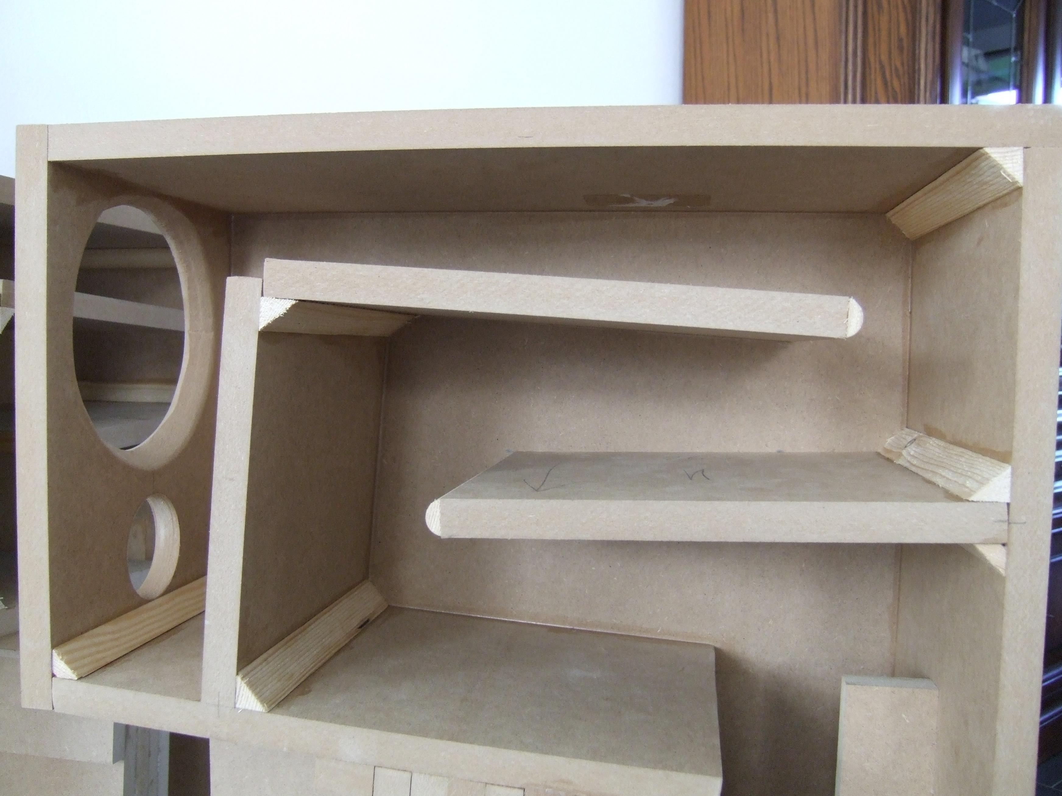

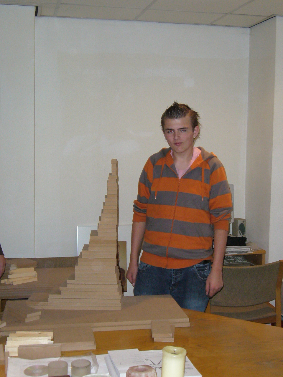

We went a long way until I reach this design ;
Pics included of the MK1 version WITH reinforcements on top and back.
After using the ATB precision system with an acceleration element I concluded that there is NO need for top reinforcement.
Also there is no "hole" in the fr.range ; so no need for a "supra-Baffle"!!
We also clamped a stroke of MDF in the centre of the mouth for checking side wall vibration!! There was so little vibration that I left this reinforcement out just for the better LOOKS!!
So feel free to do your own design but don't change mine!!
This is a proven design that made about a douzen of people very happy!!

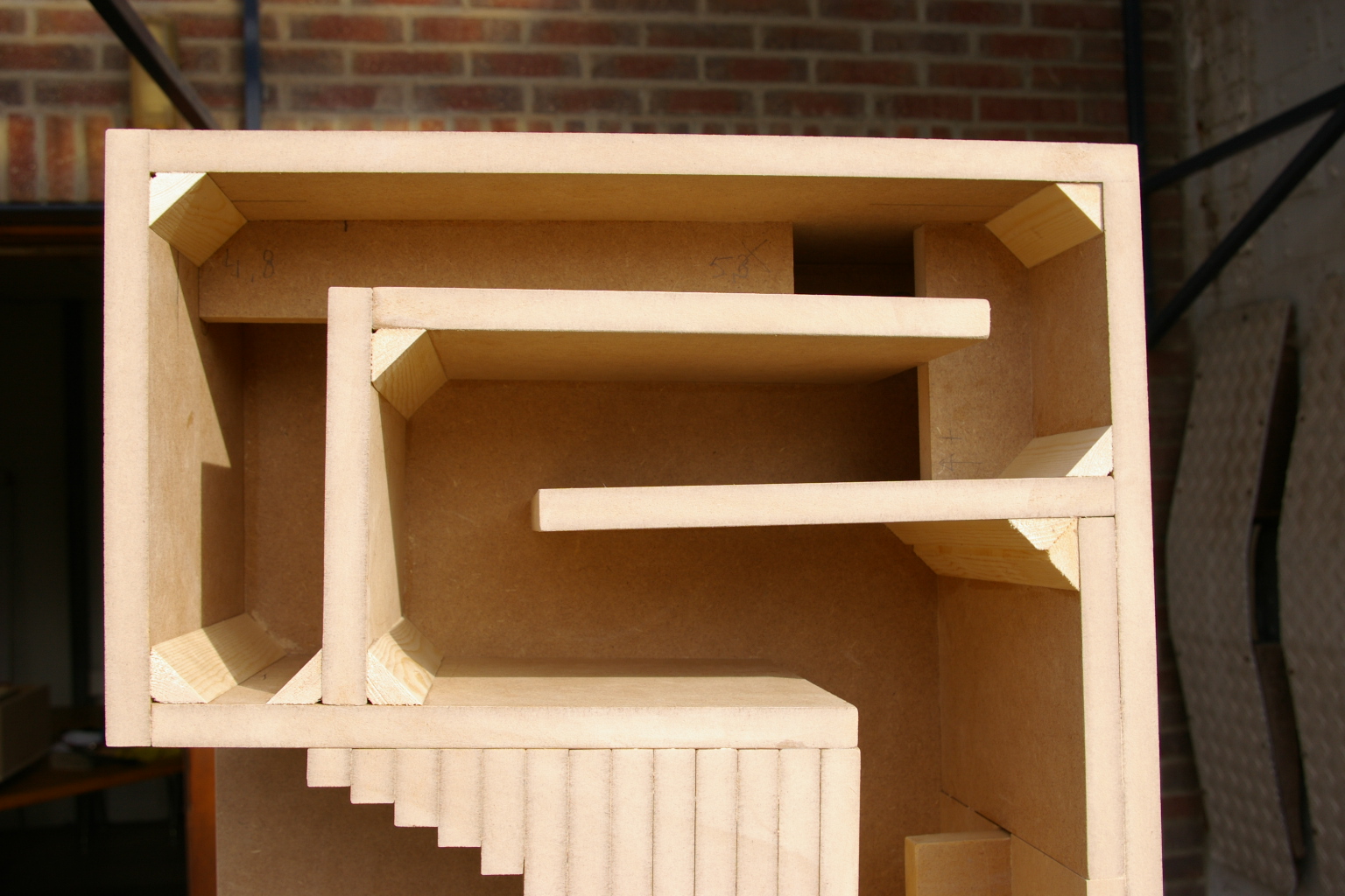

OK. Point taken. Terry Cain in his Single Horn Ben (Lovecraft Designs Audio Equipment ) uses round baffle and it looks fine. So maybe there is only aestetic need for that but no harm in using it.
Even though stiffen elements are not so important nonetheless can be useful as an aid in assembling whole enclosure I think. One doesn't need to glue them.
It's nice to hear you have tested so many options .

Fill up the triangular holes to avoid resonances.
(You can use dry sand)
Did you recalculate the first part of the horn??
By adding reinforcements you also change the compression ratio by aprox. 10%!!
Yes I'm planning to fill triangular empty spaces with sand of course. Reinforcement in the first two part of the horn are pretty thin i.e. 8 mm. So compression ratio will change much less than 10% I believe. But I didn't do any calculation. How you judge it then? Tell me before I mount side panels.
