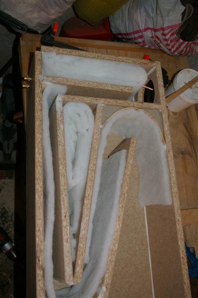

After burn-in most people don't use any absorbent at all!!
Wich means that the design is okee!!
During burn-in time only the Cc is slightly damped with 3 or 4 mm wool felt on 3 sides.
If you have a very reflective room you can ad small amount of poly fill in the first 5cm in the centre of the throath.
Very easy to reach and experiment with by removing the full range speaker.

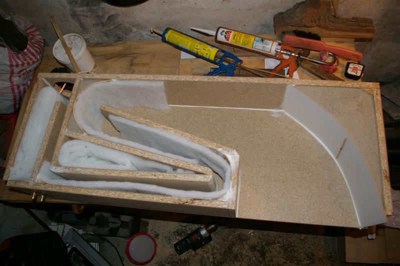

We used some soft filling in and arround the whizzer for the first 200hrs.
Why?
To make them more listenable during the burn-in stage ; but some people leave them on and go away for the weekend= another possibility!

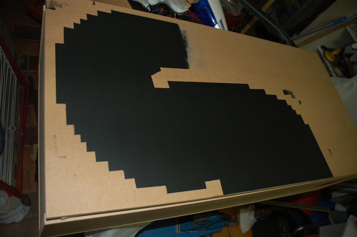

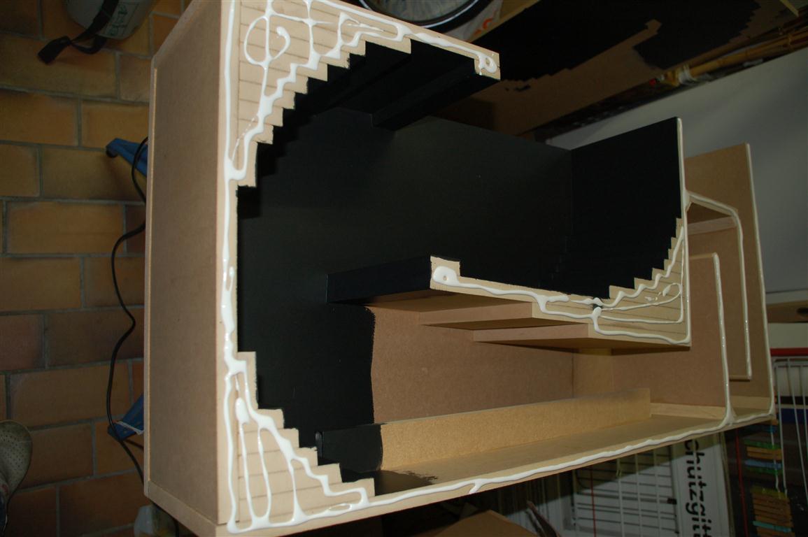

Do you have a picture right before do you close the enclosure? The bottom of the enclosure intentionally is with 1 mm shorter? The thickness of the stuff is 18mm?
the tweeter is in series with a C ; 0,82 -2,2 uF and then parallel to the Fr.
add an R ; 1 - 2.2 ohms in series to the C to adjust the level of highs ; is room dependent.
At this moment , after burn-in , everyone uses only 2,2 uF.
Does anyone use the resister after burn-in?
What was the thickness of the material you used? Did anyone try with plywood?
Answers:
After burn-in ; nobody uses resitor!! Only first 40/50 hours till bass starts happening!!
Bottom minus 2 mm : people glue lead-sheet on yhe underside ; gives more controlled bass and a more firm stand (they are tall!!)
Everything is 18mm thickness ; when you look at the drawing you see 250mm - 2x18 = 216 ; this seems uncorrect but 216 is after sanding the last side . gives 215/214mm !! (hope this is clear?)
I always use MDF but you are free to use other materials as long as the thickness is the same.

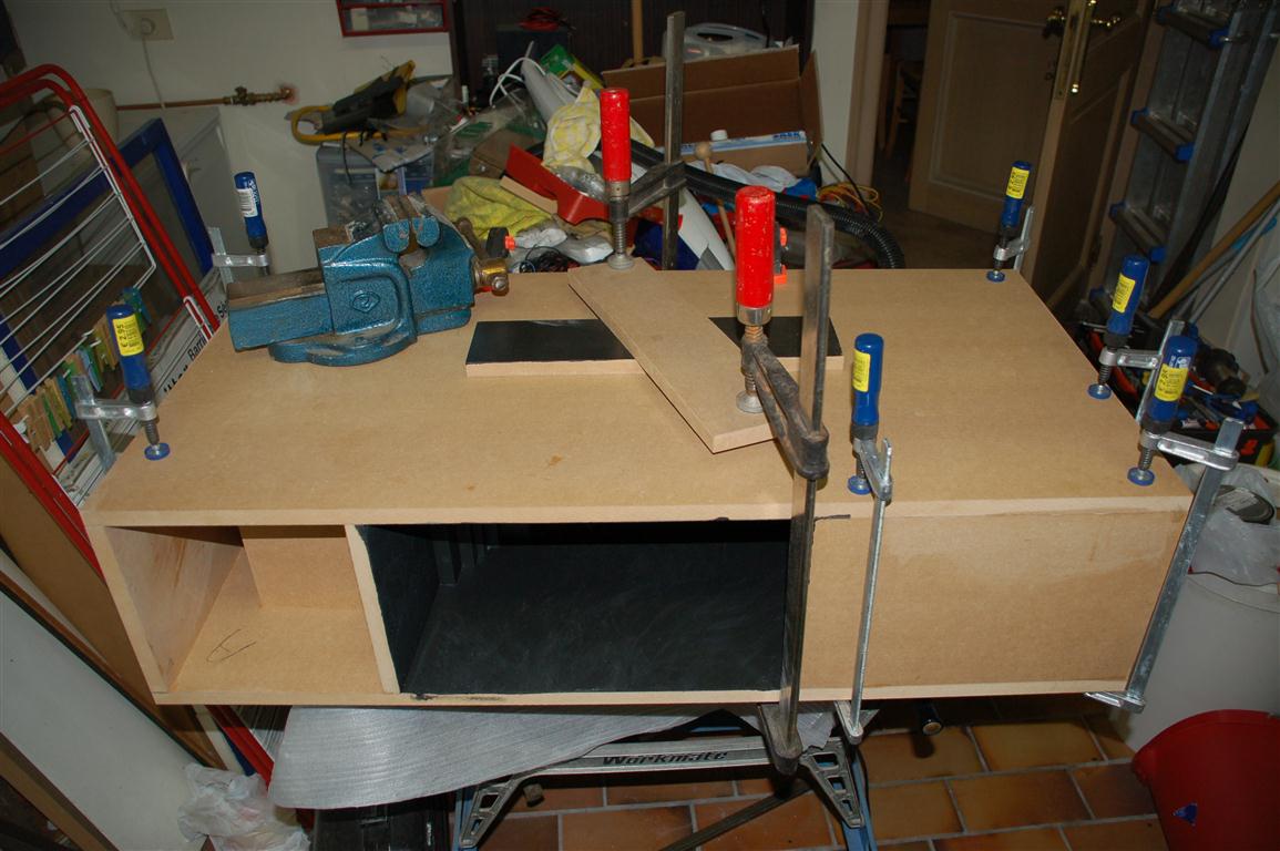

Some more pics ; just before glueing.
You see the glue as a continueish line.
Put the last side on it and DON'T PRESS IT!!
make small circular movements with the last side ; don't press!!
Wait for about 10/15 min.
Then start clamping the side on the outside and put a lot of maass on the centre (BOOKS!!)
Sand the sides after drying!!
If you are not to experienced : Take the last side 2 mm wider and longer then the other side ; easier sanding flat!! ( suppose your angles are a bitt beside 90dgrs!!)

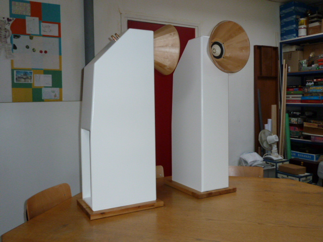

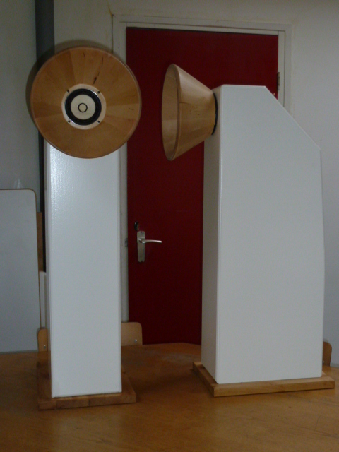

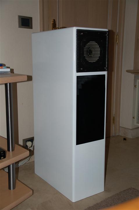

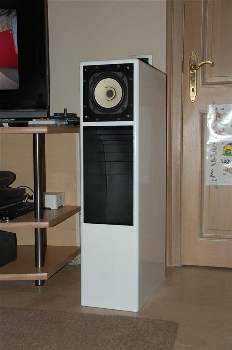

The last pics are Xander's product
These are the end-results!!
MDF is nice painting ; he did it by hand wih a roller!!
This was all before he added the tweeter boxes on top.

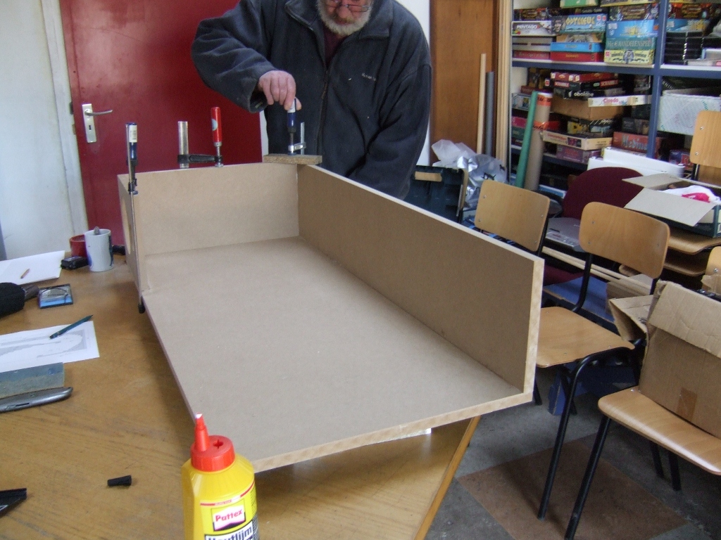

Everything has to do with the "building-sequense "!!
I'll try to explain with pics, so there are going to be several posts!!

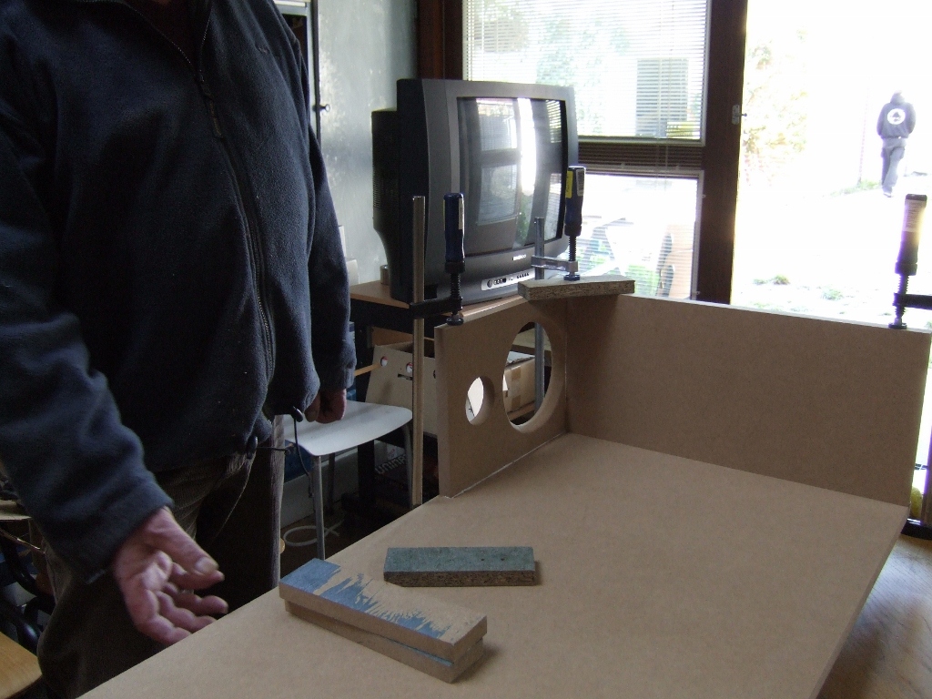

Basic building lines :

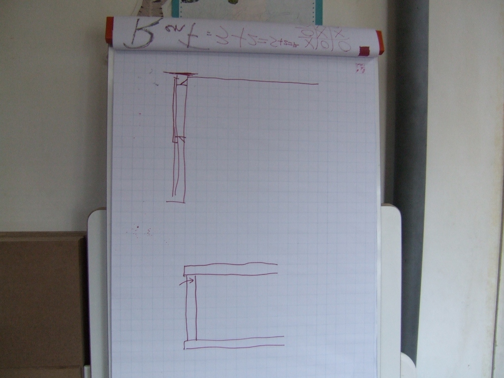

pic 1 the sketch for explaining.
Every panel of MDF has a flst side = Hard(H)
and a top side = Soft(S).
Every time you join 2 pieces the S is a bit over the H ; because of sanding after glueing ; when the H is more outside you will never get it flat later on.
In the drawing I exagerate very much.

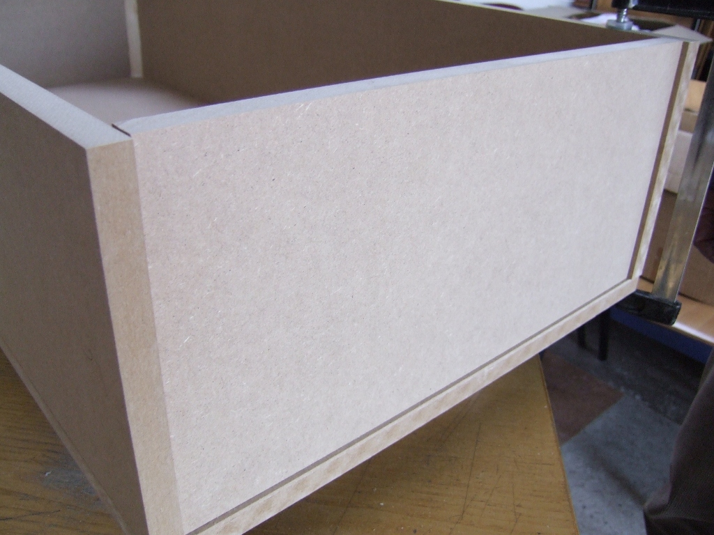

pic 2 is the real life situation ; when you look carrefully you see the S a bit over the H !! about 0,5 mm!!
In pic 3 from the inside , you can see the glue so it will be airtight.
Now wait till drying is don , be patient!!

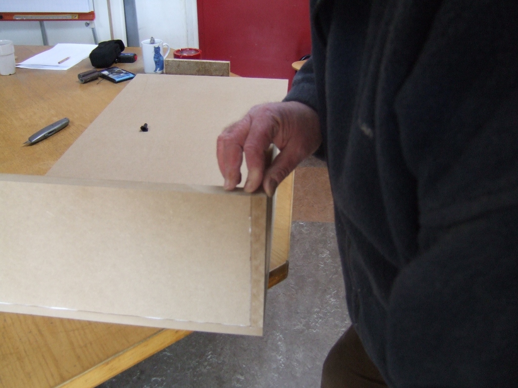

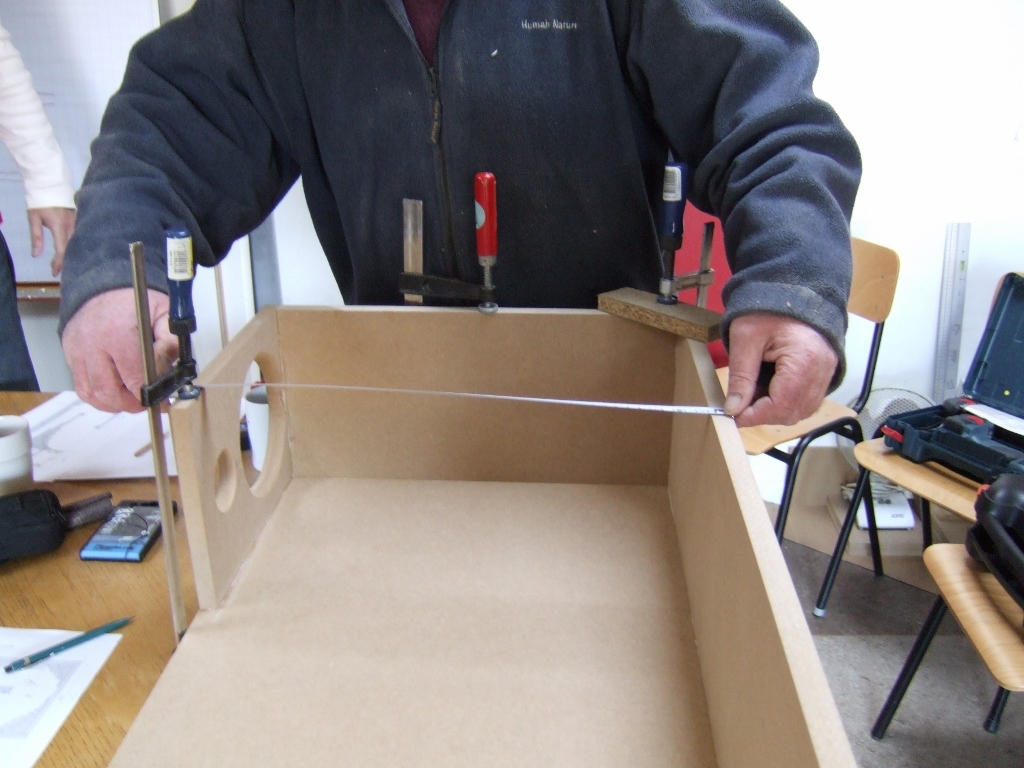

In the next pic 1 you see me adjusting ( by hand ) the back panel and in
pic 2 : I check by measuring 499 mm if everything is okee
pic 3 : close up of the bottom.
On the left you see a small gap ; adjust to 499 mm.
After final sanding the loudspeaker will become 499x1049 mm
instead of 500x1050 mm !!
But everything wil be as flat as possible!! (optically)
And your last side panel wil be over H as wel , so you can sand flat!!
Hope everything is more clear now.

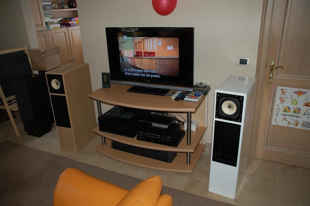

Dear Leonidas, king of Sparta!
I'm a 42 years old man, and I'm carpenter, but I never made a box with this method! We have a proverb: " The good priest learn till death!"
Thank you!
PS: Is good ( for the best sound) if I make the enclosure 500x1050?
Thank you!
