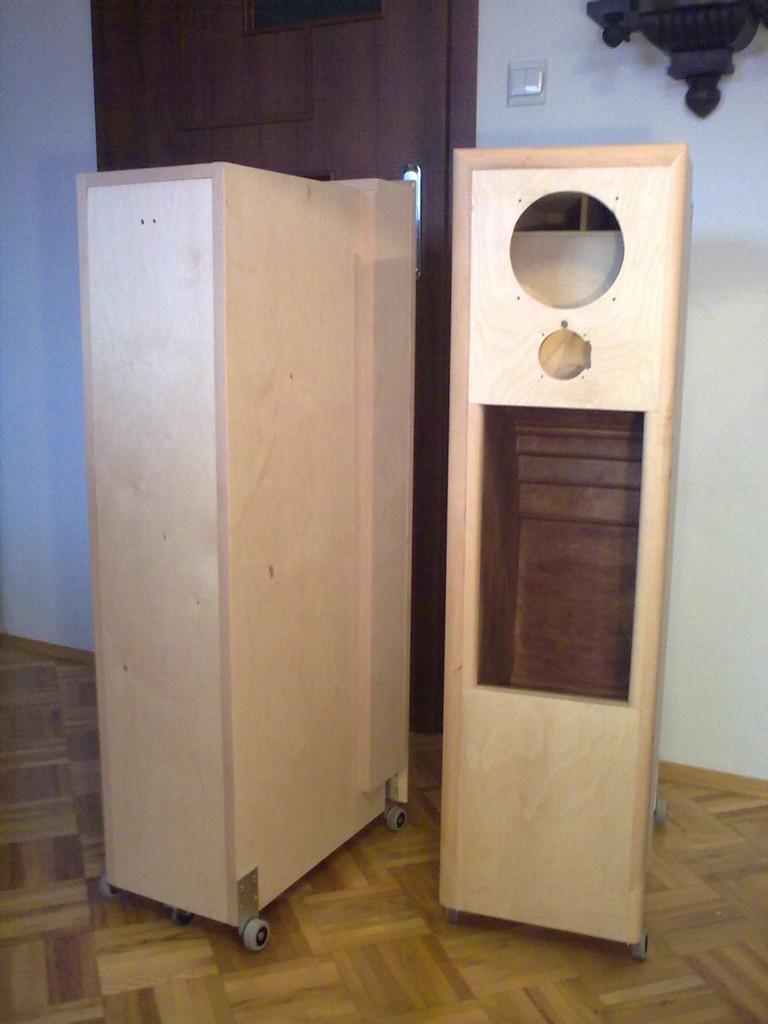

For breaking in my Fostex FE166En I've built recomended factory bass reflex enclosures. My impression is that even though there is lack of bass response in this particular instance but high frequency response is just OK. In back loaded horn it's a little bit different and we need to smooth HF response a bit by use of tweeter. That's my understanding of the matter.

I've put things together but I haven't finished speakers in full. In order to keep courage to finish I'm doing first listenig tests.
My Fostex's FE166En probably haven't broken already in, so I have to use baffle step correction cirquit (L=1mH, R=3OHM). I've used different tweeter also (old Telewatt FH5 with 0.68uF capacitor in series). With that speakers sound just fabulous !!! No doubt about that. Just diffrent from any "conventional" bass reflex. So far I've listened to every genre of music, every kind and age. I will do frequency spectrum measurements to tune final speakers resposnse soon.

By knocking with fingers at speaker panels around I've found something described in the review of Concerti 108:
"On the technical side, the resonance you heard on some music material was due to cabinet vibrations near the mouth. This is fixed in v3 by using new composite side walls and strengtening plates. The pebble leather inside the horn last segment also helps by "lubricating" the air flow."
(6moons audio reviews: Gemme Audio Concerti 108)
I mean side panels at the mouth are prone to vibrate more likely that anything else in this speaker. So I'm going to do something about it.
The walls of openings are allways much prone to resonate than the walls of a box that get intrinsic crossbracing of perpendicular walls. Two or three crossbraces in the horn opening is effective and does not add so much weight as increasing wall thickness a lot.
