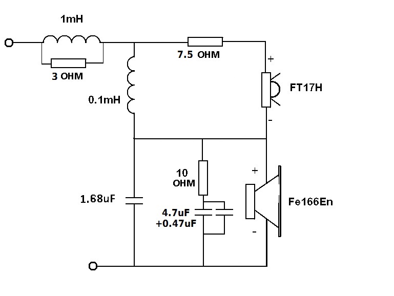

What components should I buy now for the crossover?
According to Leonidas: 1 - 2.2uf capacitor + 1 - 2.2ohm Resistor
According to Dzius: 1 1.8uf capacitor1+ 1mH inductor +1 0,1 mH inductor + 1 2ohm resistor.

I tried many other options but this one is best for me. Rigth now I use even more bass boost using 3ohm resistor paralell to 1mH coil. But frankly speaking first built it in MDF or even better in plywood before thinking about cross over. It take time every separate element glued need time for glue hardening and "setlle down". I've got a lot of experience with wood and recomend 4 hour time for glue hardening before glueing the next element over previous one. So it takes a lot of time. Additionally you need carpenter clamps to fix elements at position and proper glueing. Greater number of clamps will speed up work . All in all it's not an easy project. From this point of view FH3 is much better. But you have bought drivers so good luck !!! 🙂

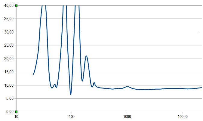

So decided to make map live easier and improve crossover by using zobel network and turn speakers into more or less constant impedance. After several attempts and listenig test final version is as follow:
Rigth now impedance plot is more leveled:
