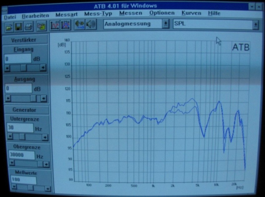

Back to the 138 esrs. Any thoughts of how would these perform in front loaded horns?
It does not want to have so much Gain from the Horn in the ower Frequences:whazzat:

How high up a horn nominally works depends on the design upper corner frequency. You certainly don't want it working up to 2KHz. 300Hz is about the practical limit, depending on the design, give or take, or you'll run into imaging problems, and also issues with the outputs from the two distinct sources combing with each other.

300Hz exponential horn (I don't like the exponential flare, but it's quick). St = 6.895in^2. Sl = 159.63in^2. Length 22.6in. Vb = 0.5 litres.
Man, that almost looks like it would make a real nice Mid-Low FLH driver; just a little too low efficiency.
Another 5 - 10 dB efficient...
