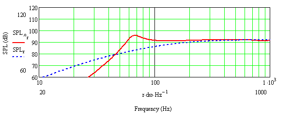

scott,
i don't understand.
sorry if i said something to offend...
i keep looking for what your comments are in context to, all i can find is that you posted a curve in Post #258, and commented in Post #262...
But that was on using a FLH...
I just wanted a general idea or where roll-off was, and a general idea of where to expect F3 to be, (I'm not going to be using these in any where near "perfect" room, etc.)...
Do have plans for a small TH that's ~95dB 20 - 60 Hz in 1 Pi & was wondering if the two might work well together...
Seeing the roll-off of the BVR lines up with the TH so well, it kinda makes that more worth trying to me.
no comments, but thanx!

No offense taken mate -there's nothing here that's personal to you; I was speaking generally.
For the sake of interest, I stopped posting computer models for anything but the more basic designs like MLTLs, BRs & the like a little while ago (not just here), because they were proving to be a double-edged sword. While they're very useful to the designer, they are often less so to the end user, because what you see isn't really what you get. For a start, they're 1/2 space graphs, so in-room behaviour is very different. It's also a case of needing to know both what a design does / is for, and also what the software does & doesn't show. For e.g., the (soon to be replaced) Olivia box on the FH site sims max-flat in 1/2 space to 50Hz, but in practice, it won't go anything like that low. It wasn't actually intended to -that just happens to be how it models, but the graph may unintentionally mislead some people. There were a couple of other, less important matters too, but it was primarily for this reason that I've quit posting graphs for the time being. I might start again at some point in the future, but for now, I prefer not to.
FWIW, in practice, expect an F3 around 60Hz.
That should mate nicely with that Tapped Horn.
Not quite as simple as I'd hoped (one box, one amp), but should be able to get by with just one amp.
Then mess with the 10 dB "suck out" & peaks on top...
Should have paid more attention before I bought it.
You'd think I would have, as much as the things cost...
r
