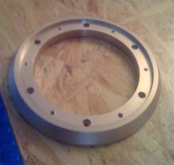

Dr. ODD said:HI Mirko
Realy nice looking Speakers. What kind of mounting rings did you do under your Drivers?
Glad to see your Progress.
Bernhard
these are some bronce-rings that some nice-guy made for me on his lathe.
similar to thte brass-rings that are available for the the eSigma-series.
the driver is boltet on the ring and the ring is screwed on the cab.the theory behind these
is mass-loading, what means the rings enhance the mass inertia of the drivers against the
movement of the cone which results in better details and faster response.

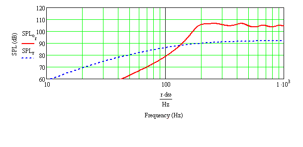

xcortes said:Back to the 138 esrs. Any thoughts of how would these perform in front loaded horns?
You tell me.
300Hz exponential horn (I don't like the exponential flare, but it's quick). St = 6.895in^2. Sl = 159.63in^2. Length 22.6in. Vb = 0.5 litres.
