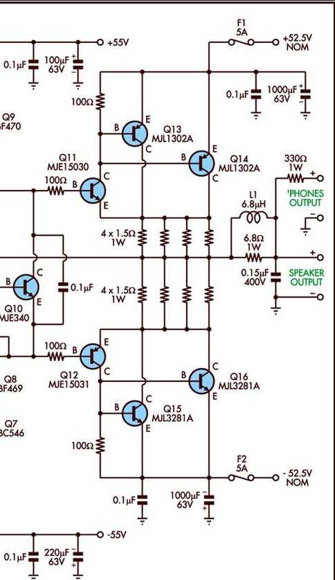

lm4702 output
What do you think of using this type of output

I just got 2 lm4702 amps working,they sound pretty good. I do feel the chip should be on a small heatsink it runs pretty warm.I built one witth darlington outputs and the other with Sziklai outputs.It does seems like the Sziklai sounds better .Some of the problems I had with Sziklai is the bias adjustment is more touchy.Its also very important to have all the pico farad caps in place or it will oscillate.I was going to use the lm4702 amp for sub amp with low pass filter and gainclone amp for small speakers.Photos to follow.

Thanks for sharing, and I think I really like this output configuration too. My CFP stage is a little different, but I think I will have to try yours and see how I like it.

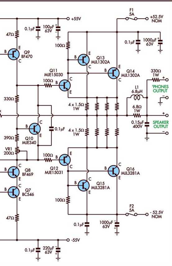

Quick question: I noticed you are using 4 parallel 1.5ohm resistors rather than a single .33 or .375 ohm resistor. Are you having any issues with overheating a single resistor, or are they behaving well despite any potential mismatches?
lm4702
This schematic is from a discrete amp project from silicon chip website,but I have seen this type of output in many amps when I used to repair audio equipment.You can use 1 resistor ,just make sure you have 100 pf from base to collector of driver or it could oscillate.

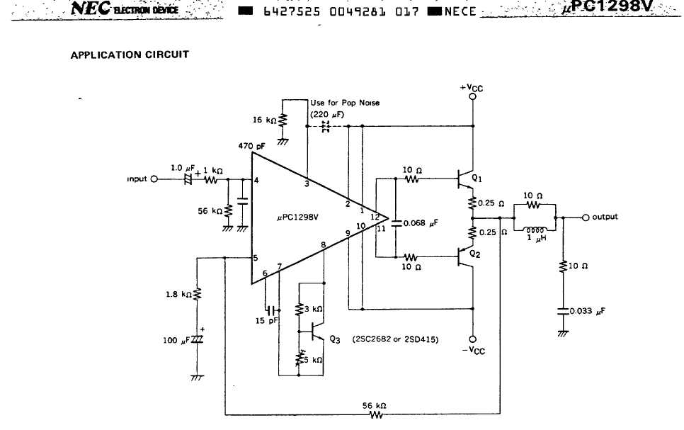

Fets may be the way to go with the lm4702 since they are voltage devices that wont load down the lm4702 5ma is not much to work with.I have used the upc1225,upc1270,upc1298 for many years as a driver IC with just a couple of outputs and bias transistor
