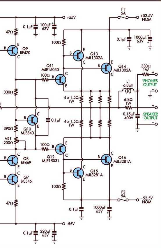

Nice job on your boards,You may want to think about a rev b board set up for Complementary Sziklai Output,I tried this output with the lm4702 and like it better,it leaves room for more choices for output transistors.

I was also thinking about some Sziklai style output for this amplifier - no problem making board for it 😉
Differential output voltage of the LM4702 is a little to small (I have max. 6.4V here) to pull out all the 'heat' from IRFP transistors (Vgs should be about 3.7 for each or more if you wont to work in 'flat class A') so I have to buy some 2SK1529/2SJ200. I want to keep this as simple as I can without adding another stage.

steven344, what do you think about one, universal board for this amp? Output stage can look like this:
Most of power transistors are in SOT93 and TO247 enclosures with standard pin-out (BCE / GDS). Configurations for this board:
1) T3 and T5 (or even T4 and T6 for double pairs) are MOSFETs. There are no T1 and T2 - only C and B pins are shorted.
2) As above but T3 and T5 are darlington transistors.
3) All transistors on this schematic are mounted = Sziklai style output.
4) T3/T4 are NPNs and T5/T6 PNPs. R3/R5 and R4/R6 - jumpers. This way we have symmetrical power darlingtons.

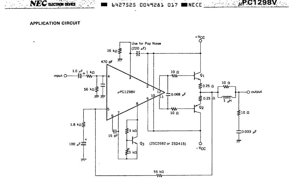

With a driver transistor on your board with the 100 ohm on the collector plus 100pf base to emmitter,I put the outputs and emmitter resistors on a heatsink and ran wires back to the board.
lm4702
The lm4702 is just a voltage amp you can design the output stage anyway you want,darlingtons are the cheapest most simple way.Check out upc1225,upc1270 I have used these many years to build sub amps.You can use 2 bridged to get about 100watts
veteran said:steven344, what do you think about one, universal board for this amp? Output stage can look like this:
That's not a bad idea. I had been playing around with different output board pairs to get the same idea. The only drawback that I can think of would be that the size of the universal board would be a little larger than necessiary. Still, that's definitely not a deal breaker, and the added flexability would be nice.
David
steven344, now it should be more clear.
Just few jumpers and you will be able to make your output stage 😉 I'm using 56pF caps on input and NFB - without them my amplifier is unstable without any source connected. The only nice darlingtons are the SAPs but they are hard to buy.
dfdye, maybe it won't be much bigger 😉 I can place transistors in front of LM4702 (mine is running quite hot so I will need a little heatsink for it).
