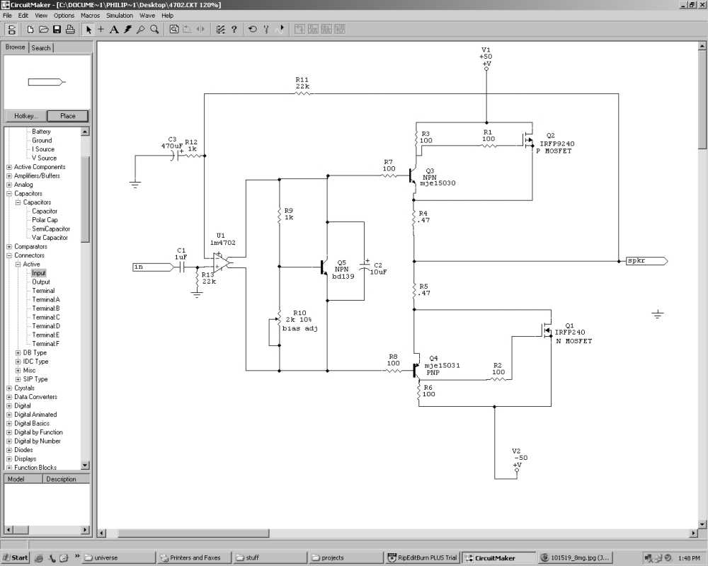

ihave seen a shematic from you with irfp240 9240 and some driver mje15030 31 is it working well?
i have ask veteran about irfp240 9240 and he said its not so good
to take them because the threreshold is not god for lm4702.
the problem is the 2sk1530 201 are much expansive.
lm4702 with mosfets and driver transistors
The circuit does work ,it allows enough bias to turn on the mosfets using the driver transistors
