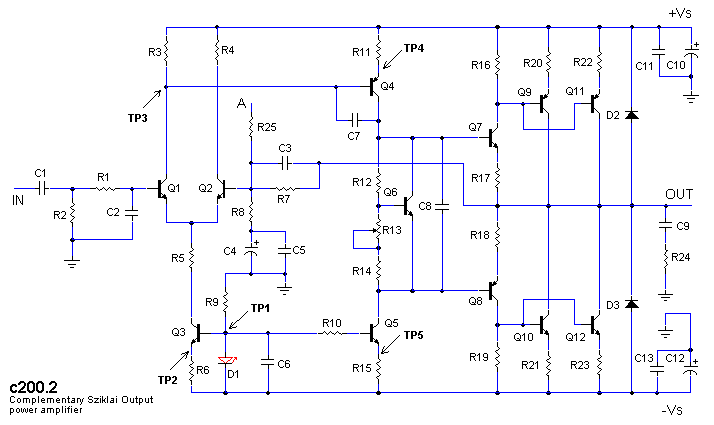

This is only a draft. You can see FETs on this schematic but there is a place for TO247/SOT93 transistor with ECB pinout.
http://www.audio.webd.pl/pdf/monster_amp.pdf
That looks like a great start, but with my limited experience, I have to ask why you have two transistors (T1 & T50) when most of the designs I have seen/used only use one. This is not questioning whether it will work, but I simply don't know the answer.
I thought there might be some advantage but after further thought I can not think of any. Works the same as one. Looks better on paper?
