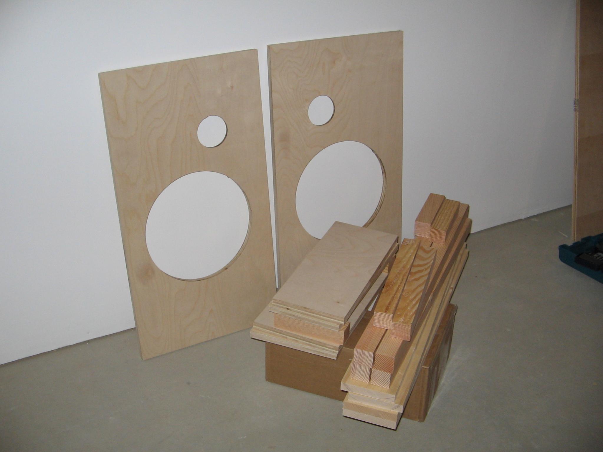

Parts ready to build. I have a portable table saw so it makes things workable. All the lumber came from my local depot. The birch plywood for the baffle is alright I guess. The top piece on the stack was flat enough and wasn’t dented or otherwise so I took it. I was by myself and wasn’t prepared to go through the stack. Couldn’t find straight 2 X 2 (so I found a straight 2 x 4) and cut the supports for the wings and baffle on my saw. The wings are cut from 6 inch plywood. I don’t know why my new router bit burned the plywood a bit when making the speaker cutouts. I took it in three cuts and went real easy.

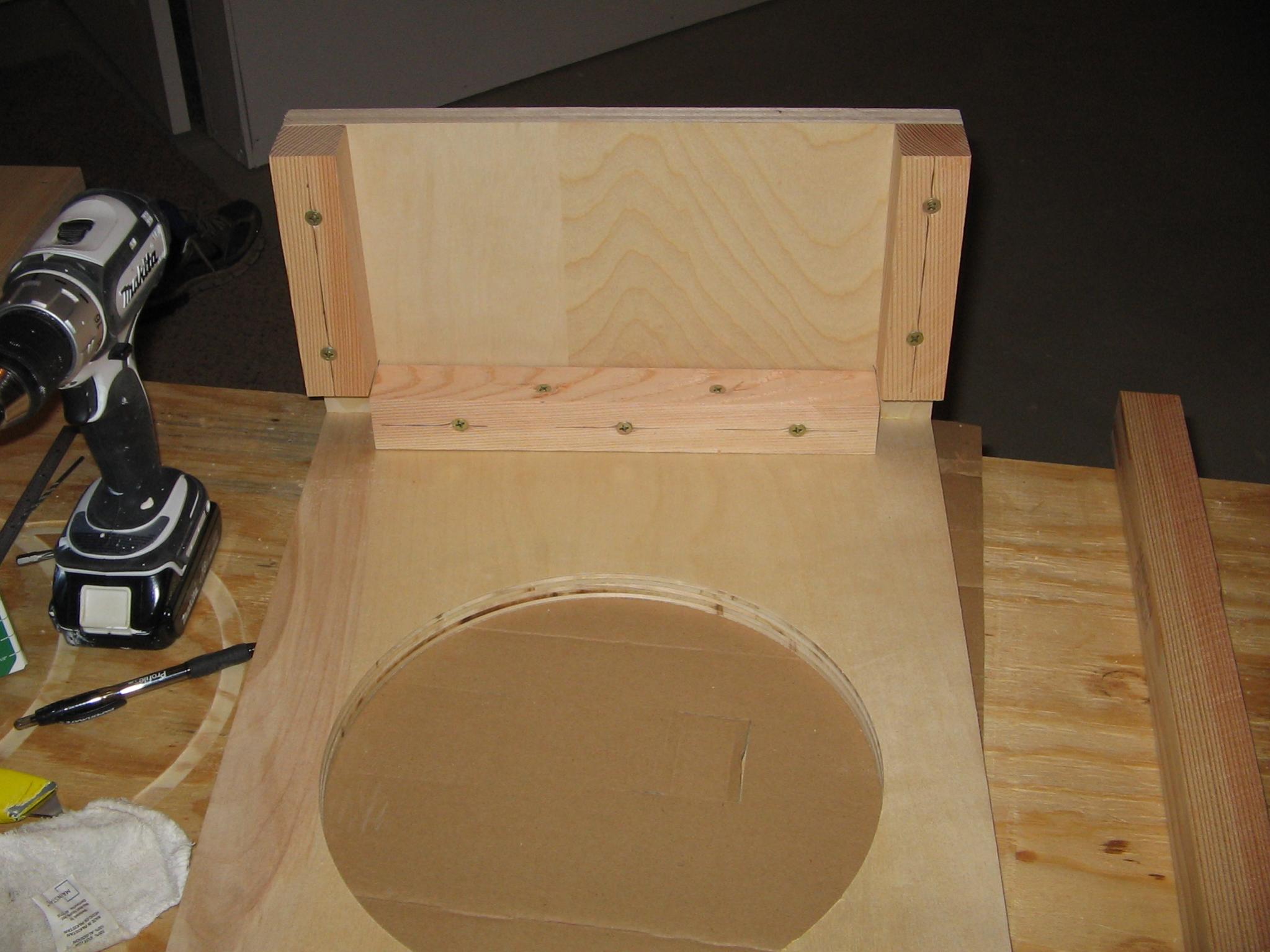

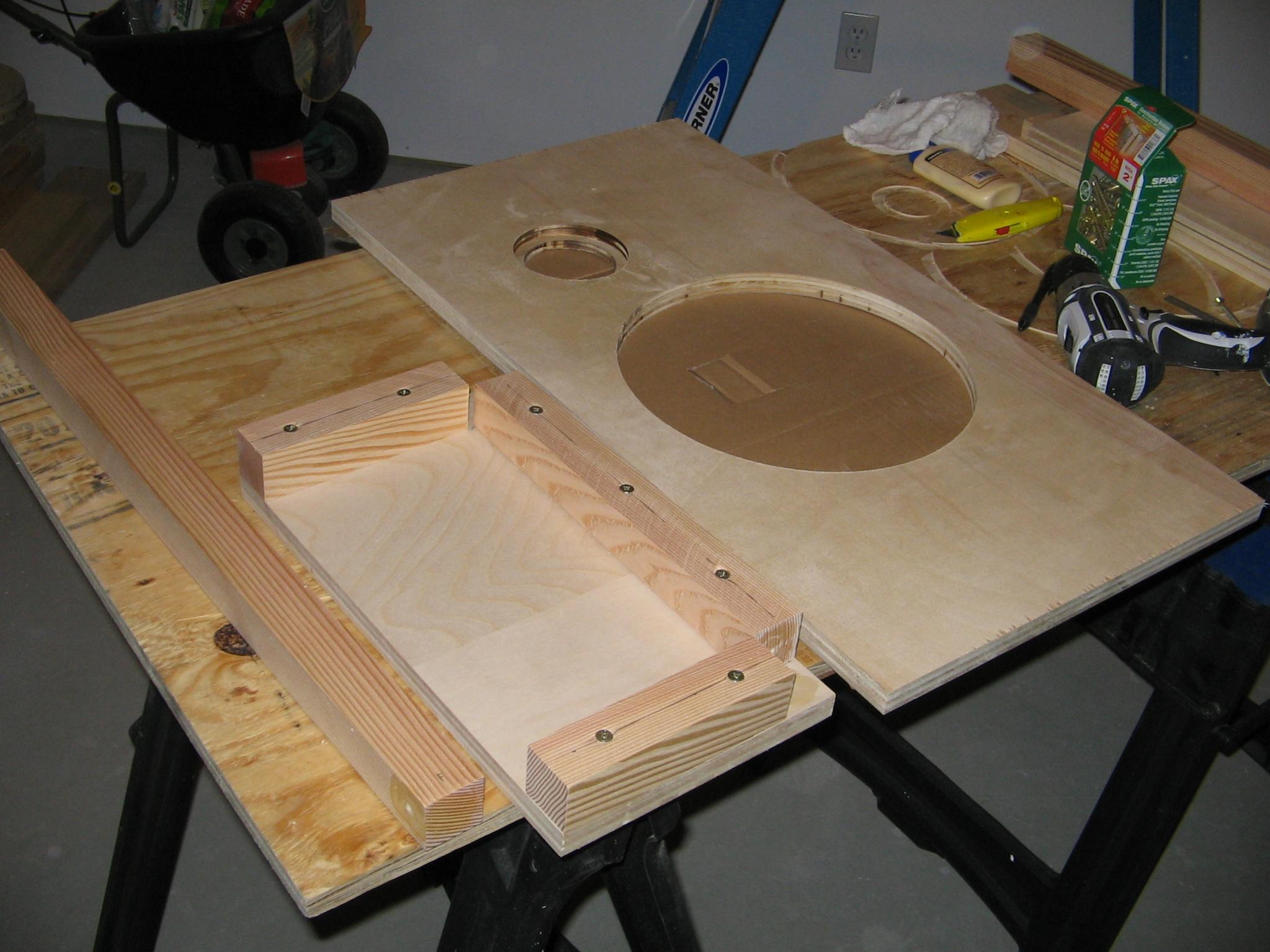

Assembling the base with wood glue and #10 screws. I pre-drilled everything with 7/64 so as not to split any of the pieces and made sure not to drill through the plywood. Started with the base and baffle.
