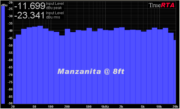

OK, I will be adding a few comments concerning the crossover. Will need to break this up, so just dealing with C1 in this post. The info below assumes a Pad resistor (R2) between 4 and 4.5 ohms.
Using Pano's pretty crossover schematic as a reference, (thanks again Pano) I want to look at the current C1 value and where one may want to experiment.
Keep in mind, the current set up is MY personal preference in My listen room. The main goals were to find a simple layout that provided the best combination of low parts count, tonal balance, power response, musical qualities and long term listen-ability. As with all designs there is room for improvement.
The High pass cap C1 helps to set the low end roll off and partially determines the roll off rate. The best I can measure (combo of RT3 and ARTA) the 6 Mfd provides a 3rd order net acoustic shape with the roll off starting at about 600 Hz and is 18 db down at around 150 Hz. The calculated 1st order electrical predicts a - 3 db at around 1,350 Hz and we should be somewhere around -18 to minus 21 db around 150 Hz. So what is happening is the roll off is delayed by well over an octave, but once it starts it is much steeper than theoretical. What we are seeing is a combination of electrical, baffle (OB F Peak & F = factors) and driver induced roll off forces combining to form a 3rd order acoustic response. So much for depending on electrical only factor(s). I will forward a couple of RT3 files to Pano so he can post them. A picture really demonstrates what is going on.
BTW, the data was taken with the Vifa at 44" off a carpeted floor at a microphone distance of 8'. (On axis) The wall behind the speaker is standard sheet rock and the speaker has about a 10 degree toe in toward the center and is 43 " from baffle face to rear wall. Large room, 21' X 26' X 8' with a lot of furniture and such.
As for playing with the 6 Mfd. To be honest, this value was selected by ear and experience. A smaller room could possibly benefit from a smaller value, say between 5 and 5.8 MFD. But for most I think the 6 Mfd will prove to be the best compromise.
