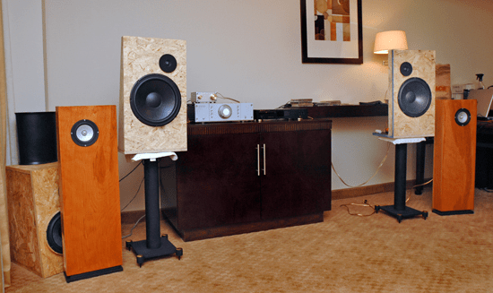

The first Manzanita from 2007 was put together with what looks like OSB. They'd look fine with a coat or two of paint.
