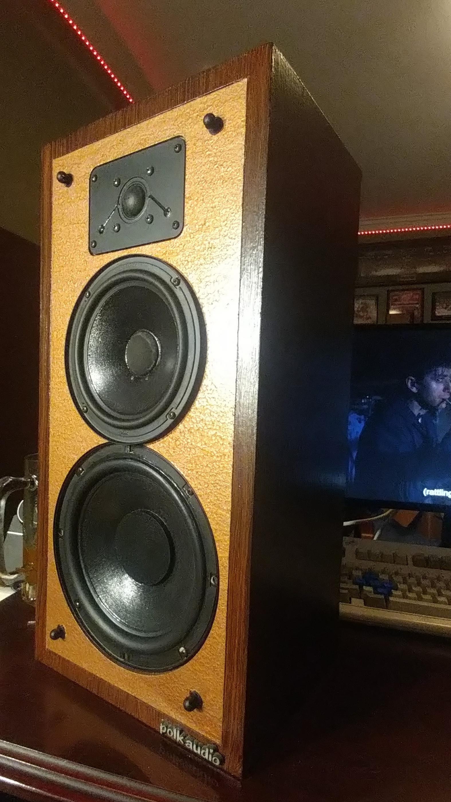

Here's the effect I'm talking about when I first piloted it. Polk Monitor 5jr, low enough value for me to really experiment with. Removed all the vinyl veneer, sealed the mdf, sanded it, primed it. Spray painted it with a carmel colored base coat of rattle can paint. Covered that with gel stain. Ran a broom from top to bottom with small movements to simulate wood grain. Where the broom traversed it uncovered the caramel colored base coat. On the baffle I put a layer of rustoleum hammered metallic paint. I'm not saying it's perfect but you can see the faux painting and wood grain over the bare MDF that I sealed with some flat poly, it doesn't look terrible to simulate wood grain. But if I have enough spare veneer I am more likely to veneer these. I just wanted to articulate the two tone look and faux painting from a previous project in a photo.

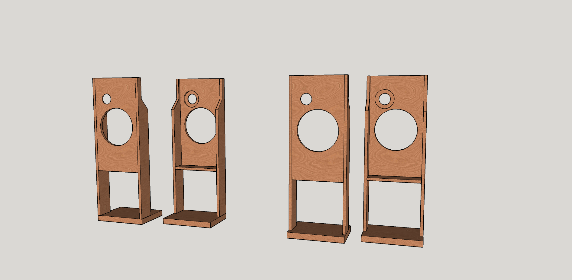

Here are two views of a design that extends the wings down into legs so that a separate base is not needed. The only difference between the two designs is how far the bottom piece extends to the front. It’s just a matter of which is aesthetically preferred.
Note that that the bottom piece is 1.5” thick in order to add more weight to the base. Also, I plan to use oak rather than pine for the wings and the bottom piece. Again, in order to add more weight down low.
Also note that the wings are reduced in depth from the top down to the center of the Vifa driver. That is something I noticed that John has done on some other similar designs. Don’t know how important it is. So John, if you would care to comment it would be appreciated.
