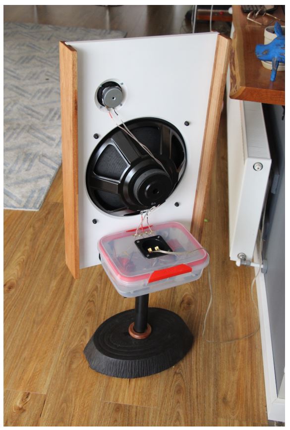

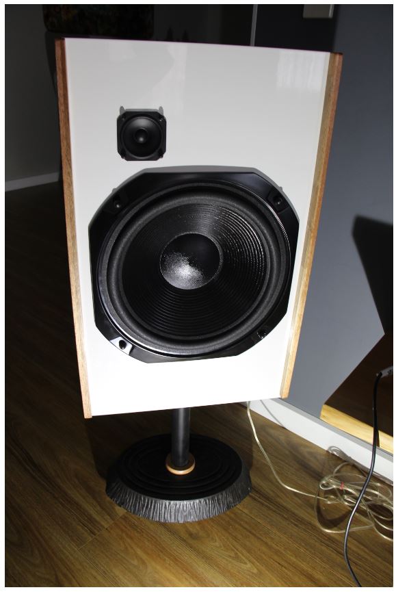

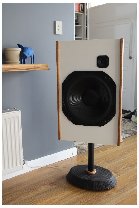

Good day Gentlemen
This is my first built in DIY audio. And it's a Manzanita. Please don't judge harshly...
When I first heard them sing even with my Hitachi 802 amp I cried for 10 minutes. I have never heard anything like it in my life. When I'll get them a few tube amps they will sound even better.
Thanx, I'm glad you like it. :) The base stand is painted concrete. I used sausage BBQ foil for the form. Then painted with oil paints mixed with boiled linseed oil. The base is about 30 pounds which gives stability. I have adjusted six legs under the base, this way I can move it vertically for a few degrees up or down. Crossover boxes are food containers a few bucks a pair, with a few modifications, but they look good and transparent, you can see inside. The pole is from a fence post - pretty thick. Wood around the baffle is Meranti. The baffle itself is an old table top, so almost no money spent, just time. :)
