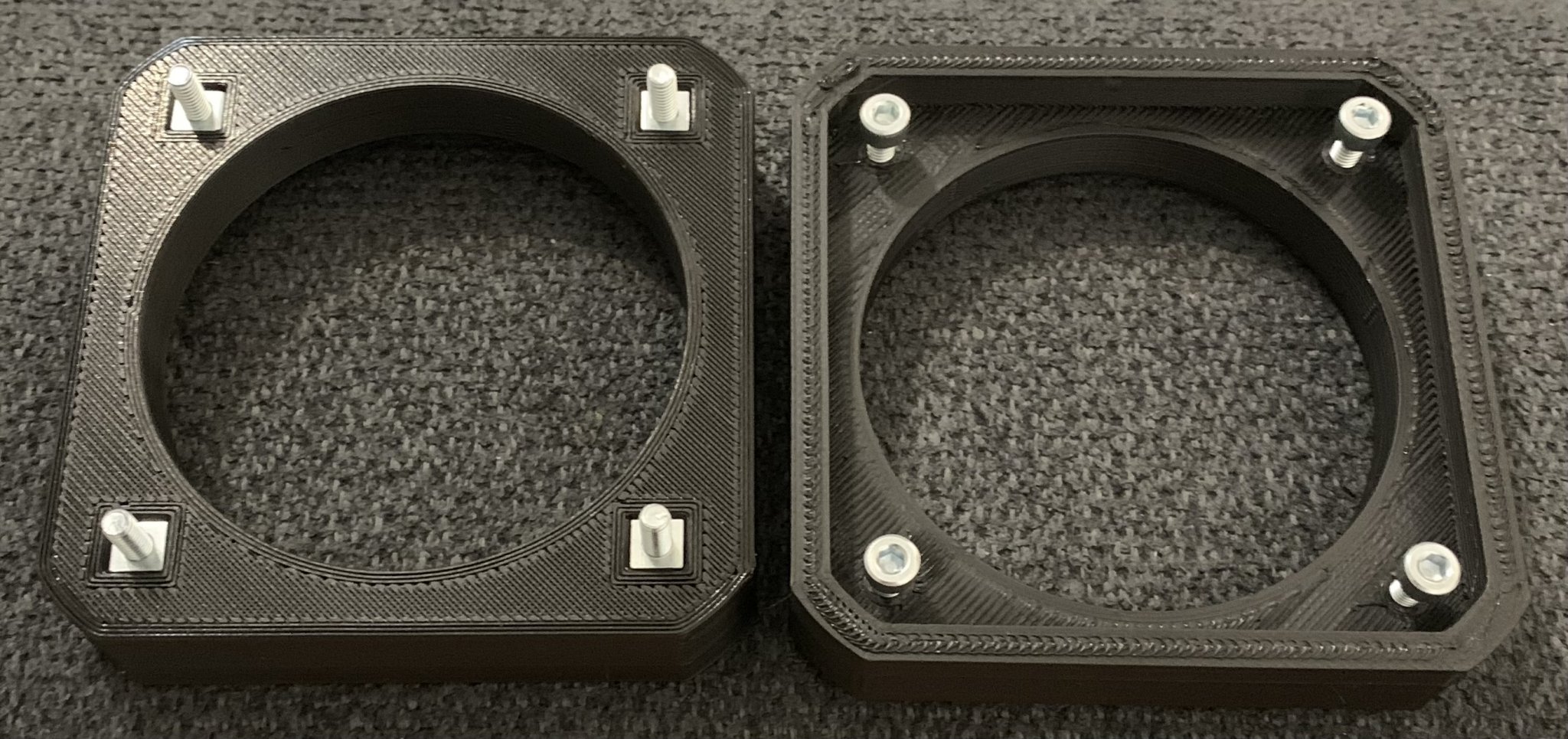

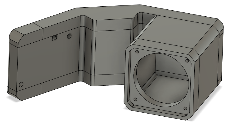

They are 3D printed and held together by M6 threaded rod - I will share the STL here later. These are not my best prints, I had a half clogged nozzle and will need to print new ones. Also, they will be glued together and will need a bit of filler and sanding.

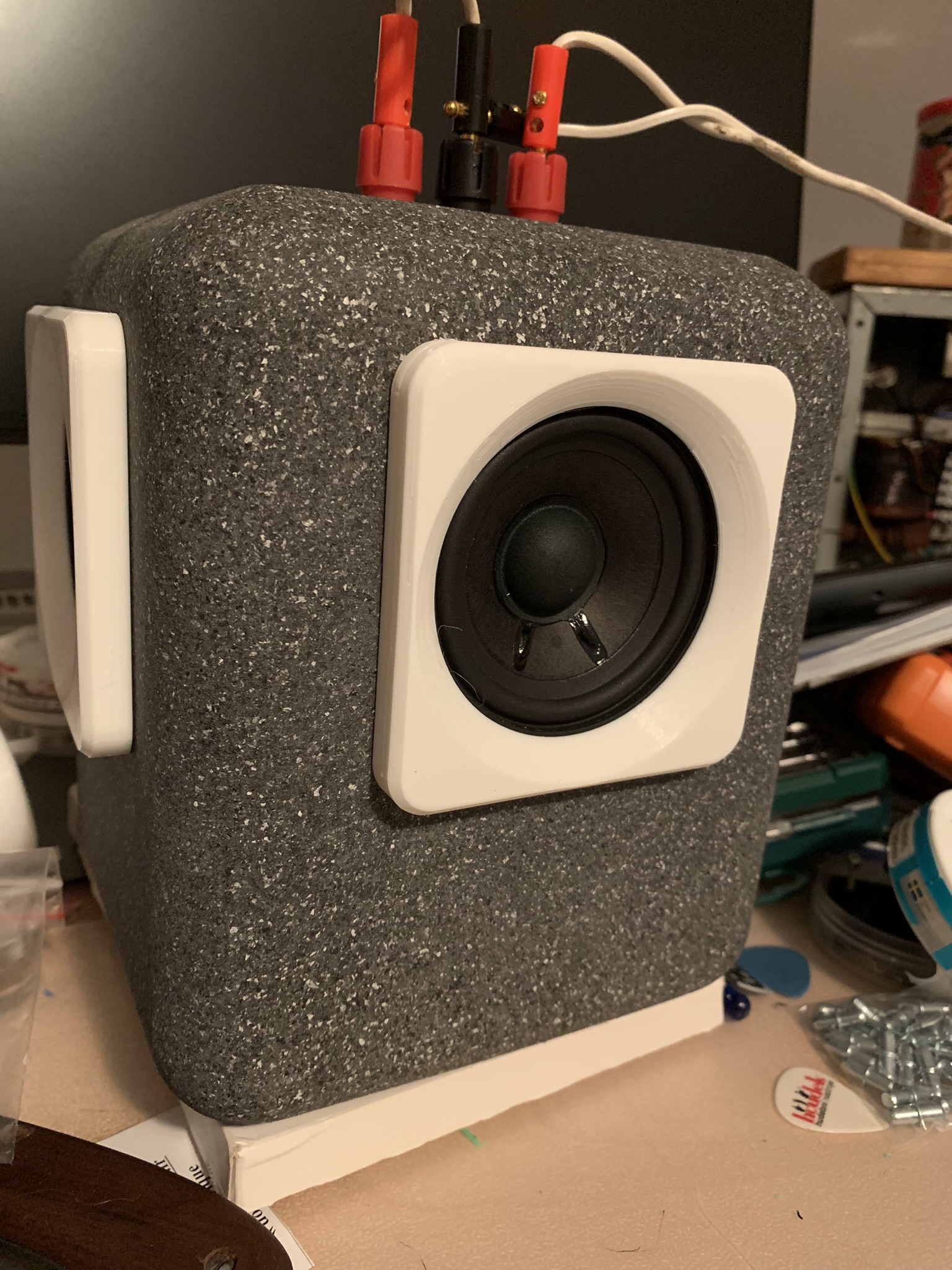

Both of my delta printers are waiting for spare parts... But I am thinking I should actually try a 9 driver line too (3s 3p connection)...once the printers are back to business, I will print some more. The easiest way to build the box would be cutting some pine planks of the correct width. The not so good prints I have now will be glued together soon and the construction from planks will be tested in small scale.

I think the banana sockets and 4.8 mm fastons could be in the package that was delivered today. That means the Hydra clone prototype could be potentially put together for testing in the weekend.

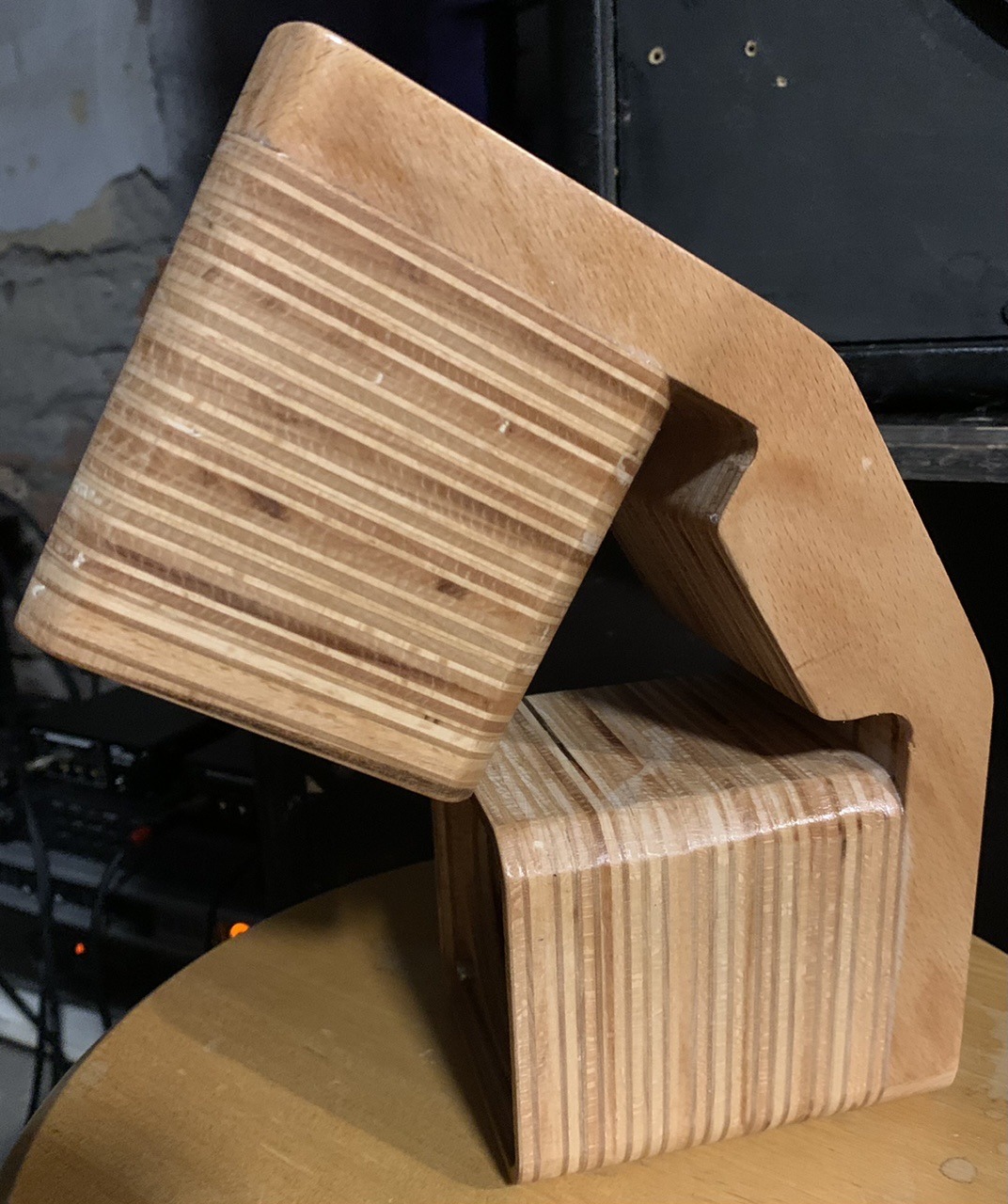

Finally, I got my belt sander out and spent some 30 minutes with the Hydra clone and then one layer of matte spray lacquer. Still some sanding and two more layers to go. The dual box looks pretty good with some small exceptions. I have my deepest respect for @wesayso for building his arrays from (hand cut!) layers of plywood. My very small project will be most probably the last to use this technique (well, maybe except some Yuichi style horns in future). I fully understand the price charged for the original Hydra.
Reactions: stv
When writing the last post, I never thought I would say that, but I will build the second one to the pair. I only tested it for half a minute, I will need to listen more and make some measurements later, but it was definitely all worth the effort.

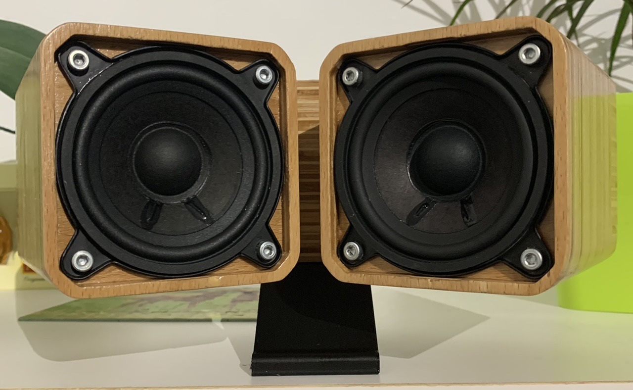

On a 3D printed stand🙂 I forgot to mention that they need a subwoofer/bass unit (I had one of my 40Hz bass horns connected). I always liked the Bose sat/sub with 4 dual cubes they had connected to a jukebox in my favourite bar (4 dual cubes and a sub). This is better. These seem to have a relatively wide sweet spot and due to the angled arrangement, the dreaded comb filtering cannot be heard by me.

Cool.. just wondering how do you listen to it? Placed horizontal or vertical...?
