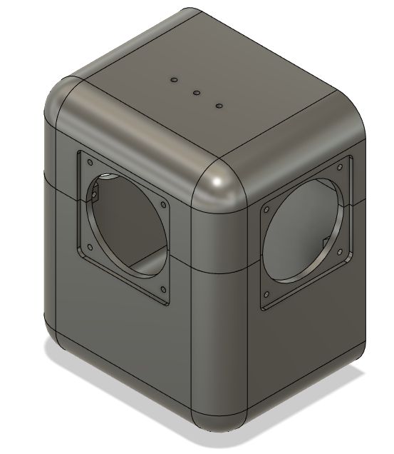

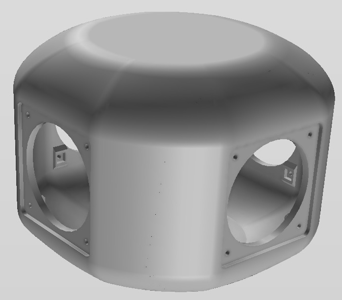

Inspired by the IMP loudspeaker. Not sure if printable like this, it calls for a 24h print. I am not sure I dare🙂

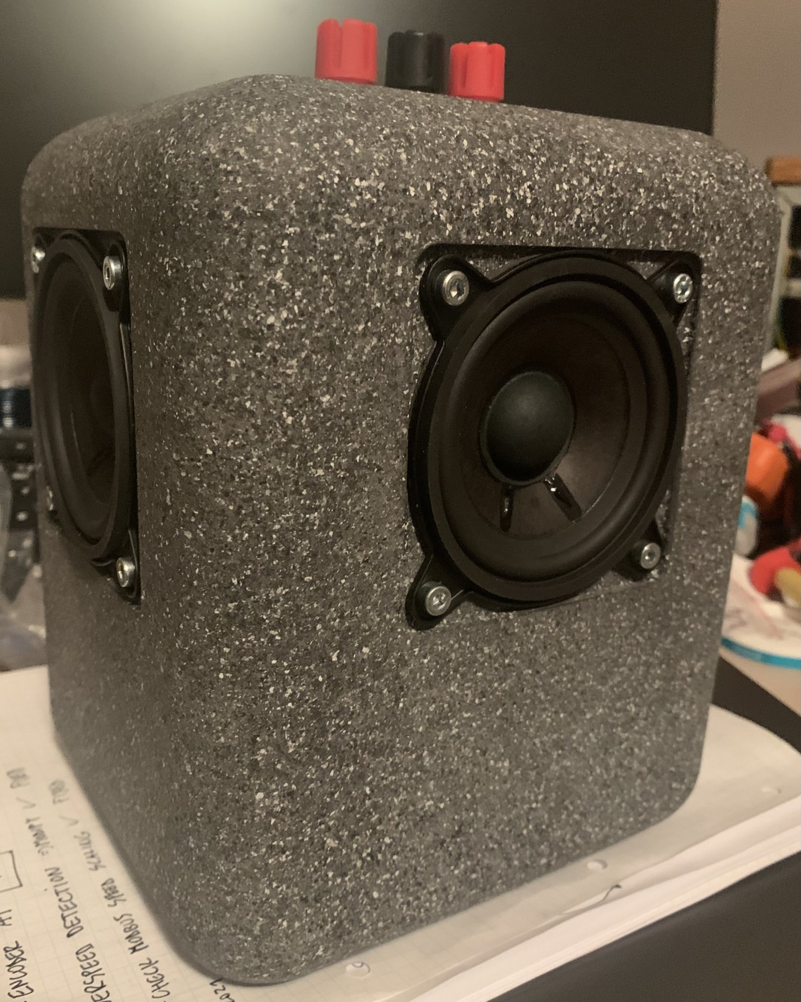

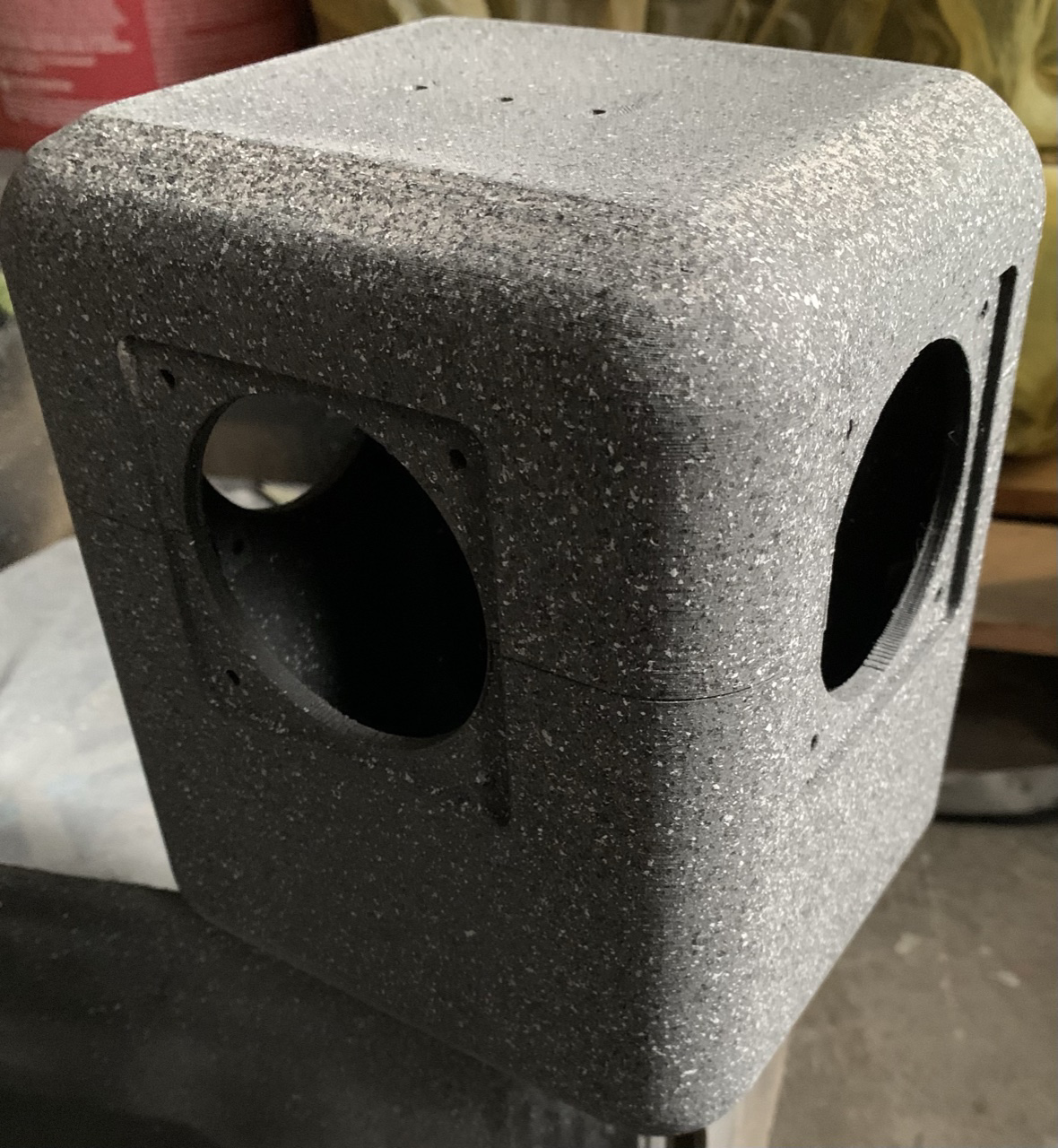

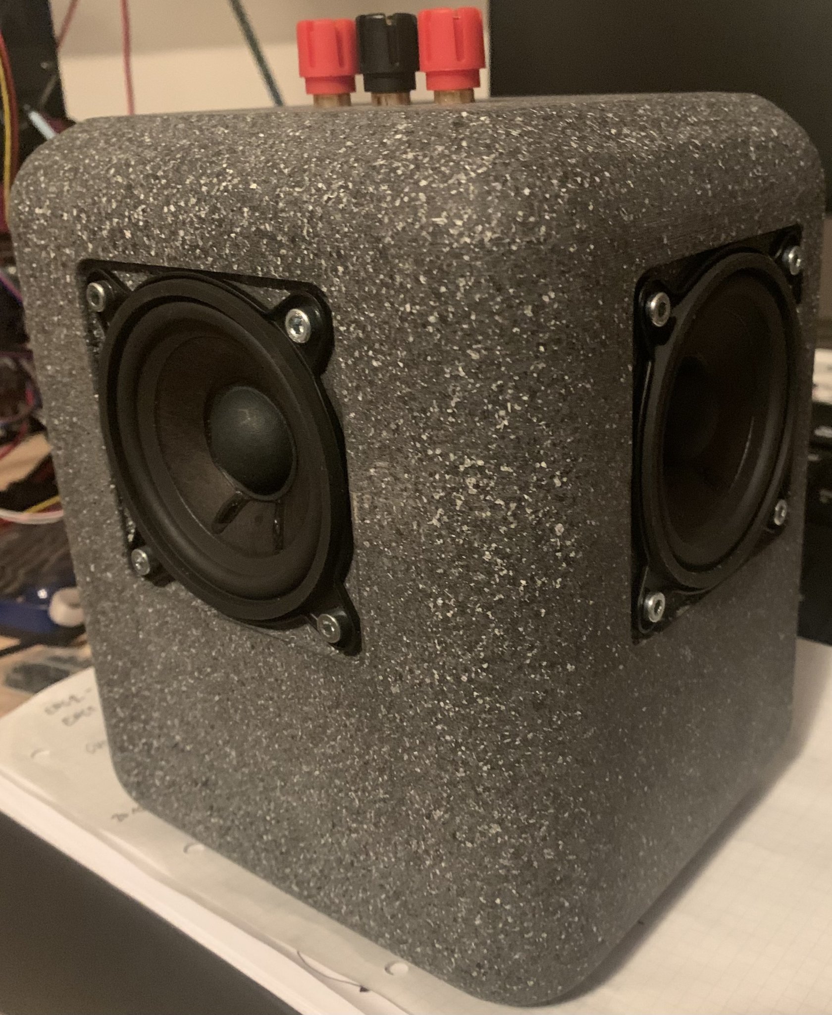

So the Single Speaker Stereo box is finished. No psycho-acoustic filter, it is temporarily replaced with a piece of cloth damping the direct HF. I did just a small test drive and with a subwoofer it seems it will work pretty well. I will later print some frames with magnets to fit on the hex screws for looks and protection. I will experiment with various materials for damping the direct HF, maybe even print some sort of diffuser.
I would love to hear your thoughts on these. Been tinkering with the SSS idea for a while now. Like the idea of physically damping the front driver. Should preserve any low-mids from the sides that gets lost in the filter. Could be adapted into a Tabaq or Pencil design.

@danb11 It works pretty well if you have a proper room for it. Damping the direct sound with a cloth seems to work fine as well - blocking the direct sound makes the stereo effect better. Definitely worth trying out, even a rigid carton box would work (Elias did that).
