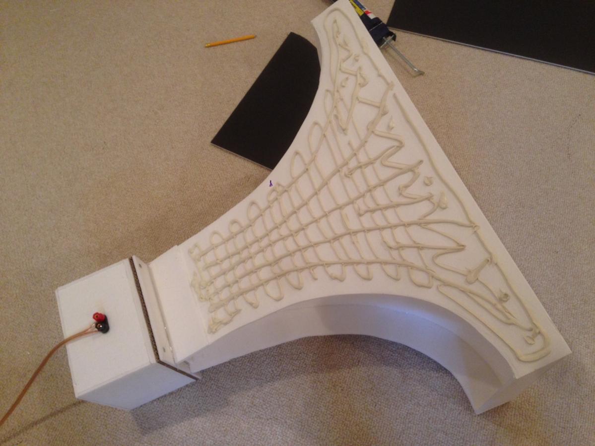

I've made a few speakers with 3" Faital. Some small line arrays that were nice, and some goofy horns, as shown below. All worked well and showed promise. None could go low enough without a woofer, IMO.

Hey XRK. Yes that dollar store foam core is fun and handy for prototyping. I found that it buzzed far too much for final use, but I never moved on to plywood with these. Should have.

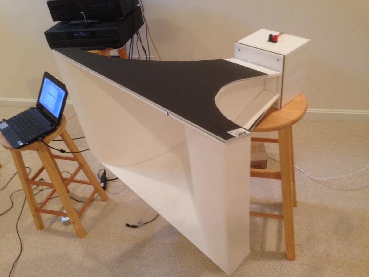

I've made a few speakers with 3" Faital....and some goofy horns, as shown below.

Yes George, those big microwave horns were precisely my inspiration.The set in the picture on the right look much like the old AT&T microwave relay horns...
I was going to make my reflector tops curved, as they are on the microwave horns, but for a first build just went flat for ease of build. And of course theorizing that a flat reflector would spread the HF better - pure rationalization on my part. 😉

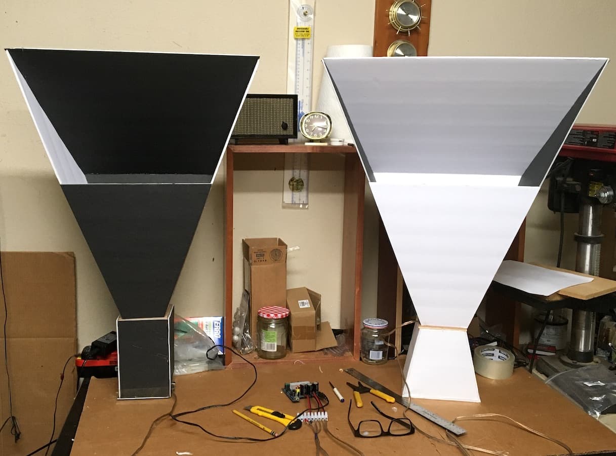

On these Reflect-O-Horns and the flared conical horns I did not notice any efficiency gain over the normal driver. Shouldn't there be?

In the point to point microwave world where these horns were used the idea was to focus all of the energy at the receiving horn. In this application these horns worked much like a folded megaphone. One sized properly for audio would be large and have a small sweet spot.

Perhaps if you made a before/after comparison.I would assume that a horn should show some efficiency gain over a box enclosure, but from what I read, it's mostly in the lower octave or so around or below the driver's resonance.
From the outside, you can view the waveguide as a focussing device.. when directivity is constant with frequency, power falls at -6dB/oct.

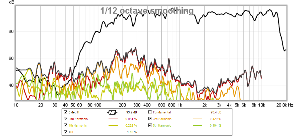

You can reduce the buzzing a lot by glueing on a second (CLD like) layer with latex caulking. The added foam core pieces can be smaller and applied outside. Or auto sound mass loaded butyl works well too.

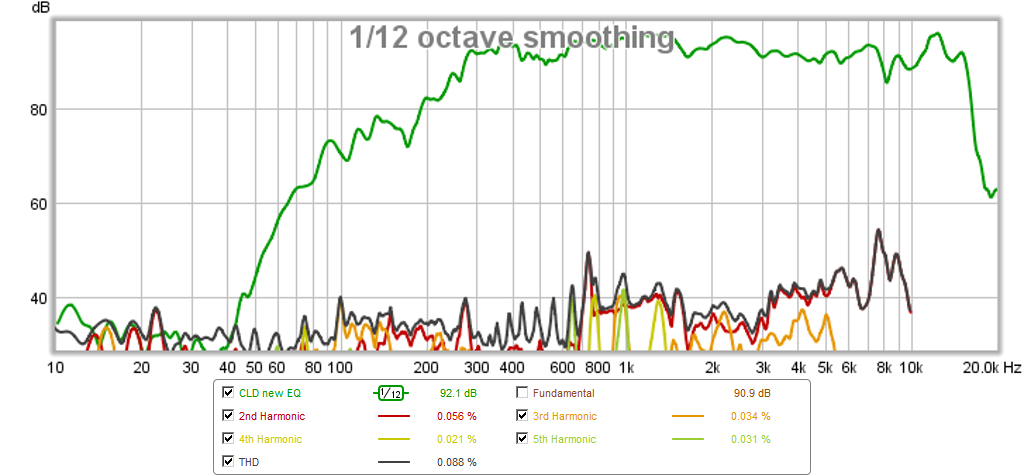

I managed to really reduce the buzz and distortion with the added CLD on my tractrix horns. Typically would get 10dB gain in the mid to highs.
PRV 5MR450-NDY for FAST/WAW applications
Before CLD, lots of buzzing:
After the latex CLD treatment:

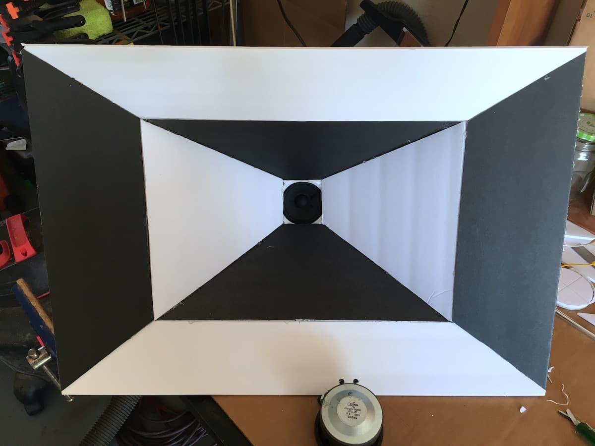

Another project is hornloading the 3FE22 with a large CD horn. It will need quite a bit of EQ. The adapter is 3D printed, ready for measurements.
Is that a 2" throat horn?
