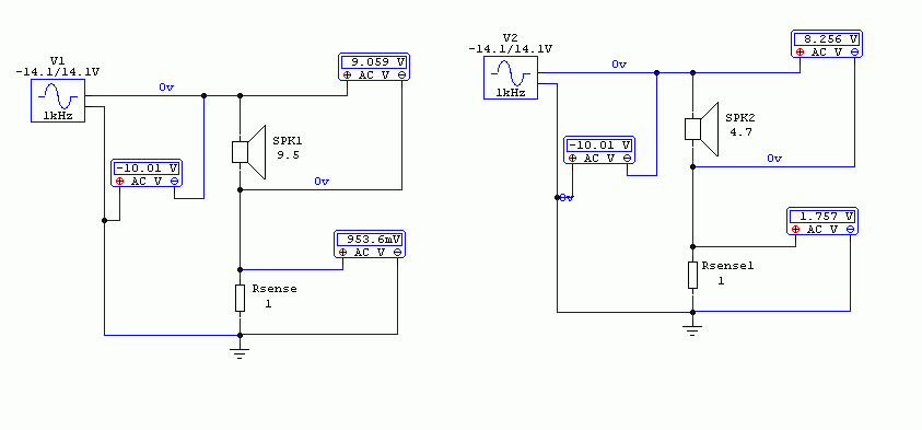

Fabrice,
please look carefully at the picture below and try to understand what are you really measuring and what conclusions are you making out of your measurements.
Voltage on load falling with load's resistance is not just because of DF (1/Zout of the amp) but also due to voltage division with Rsense.
So you should measure the voltage from amp's output to ground, not just across the speaker.

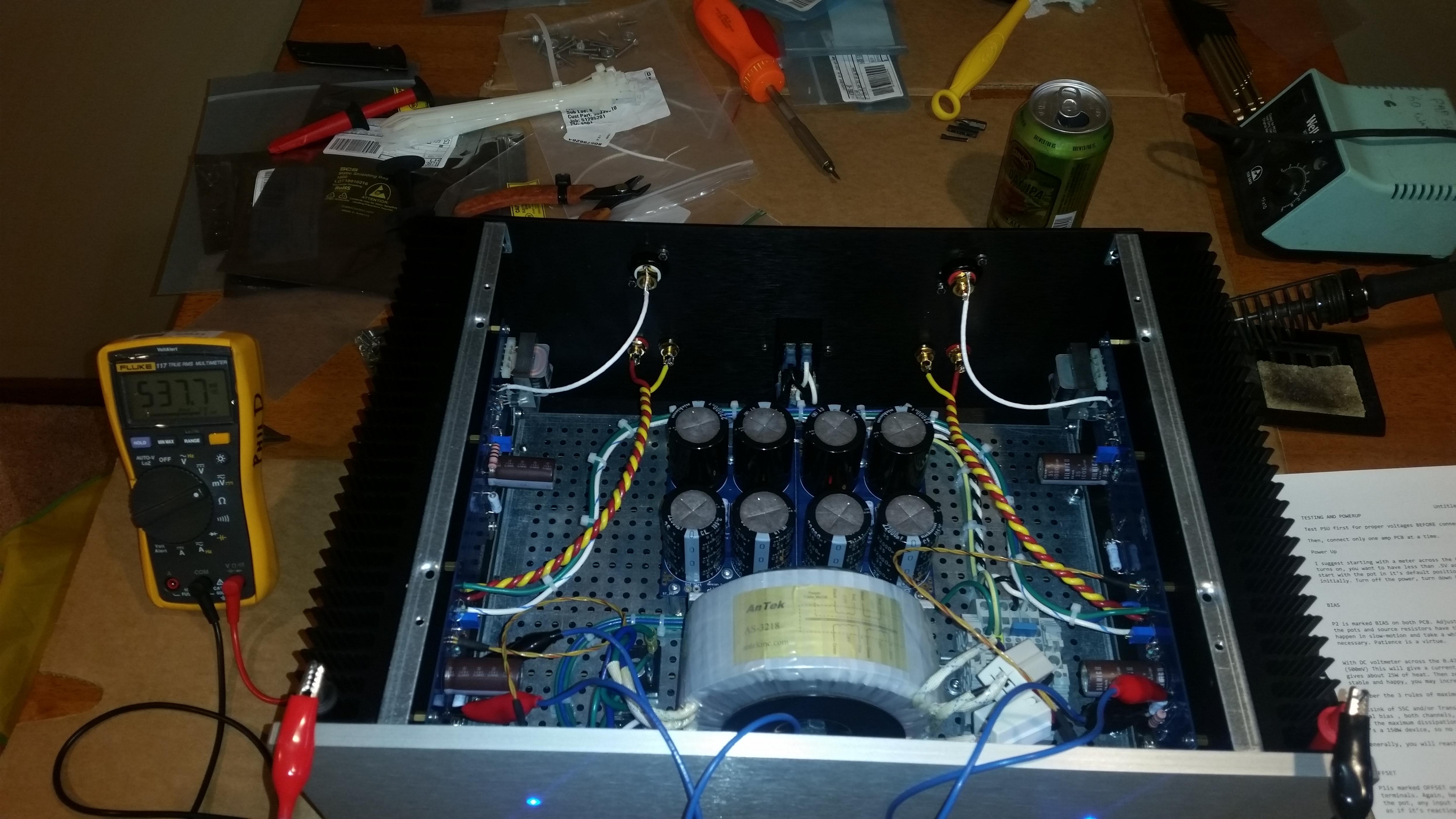

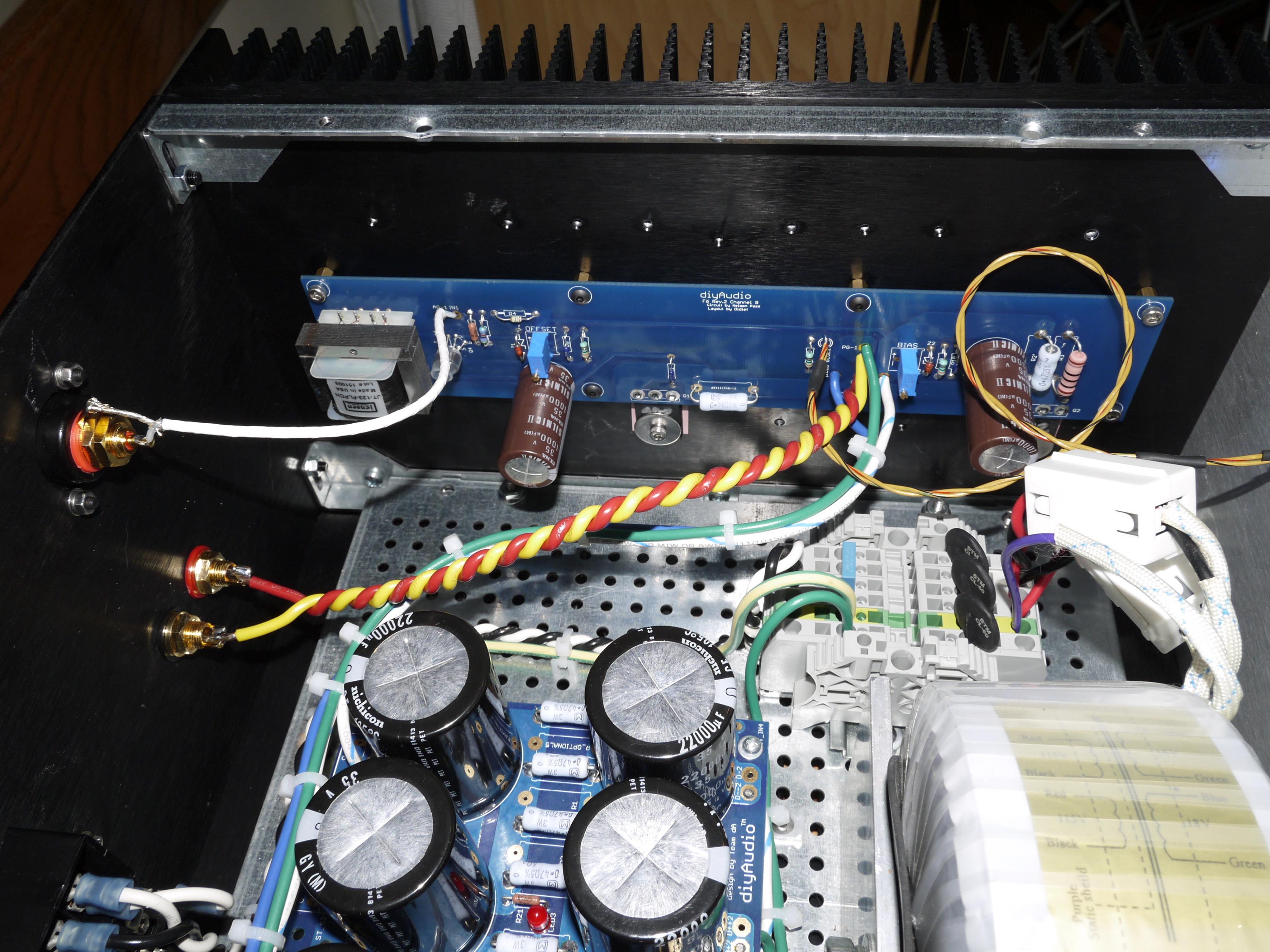

Finally Finished!

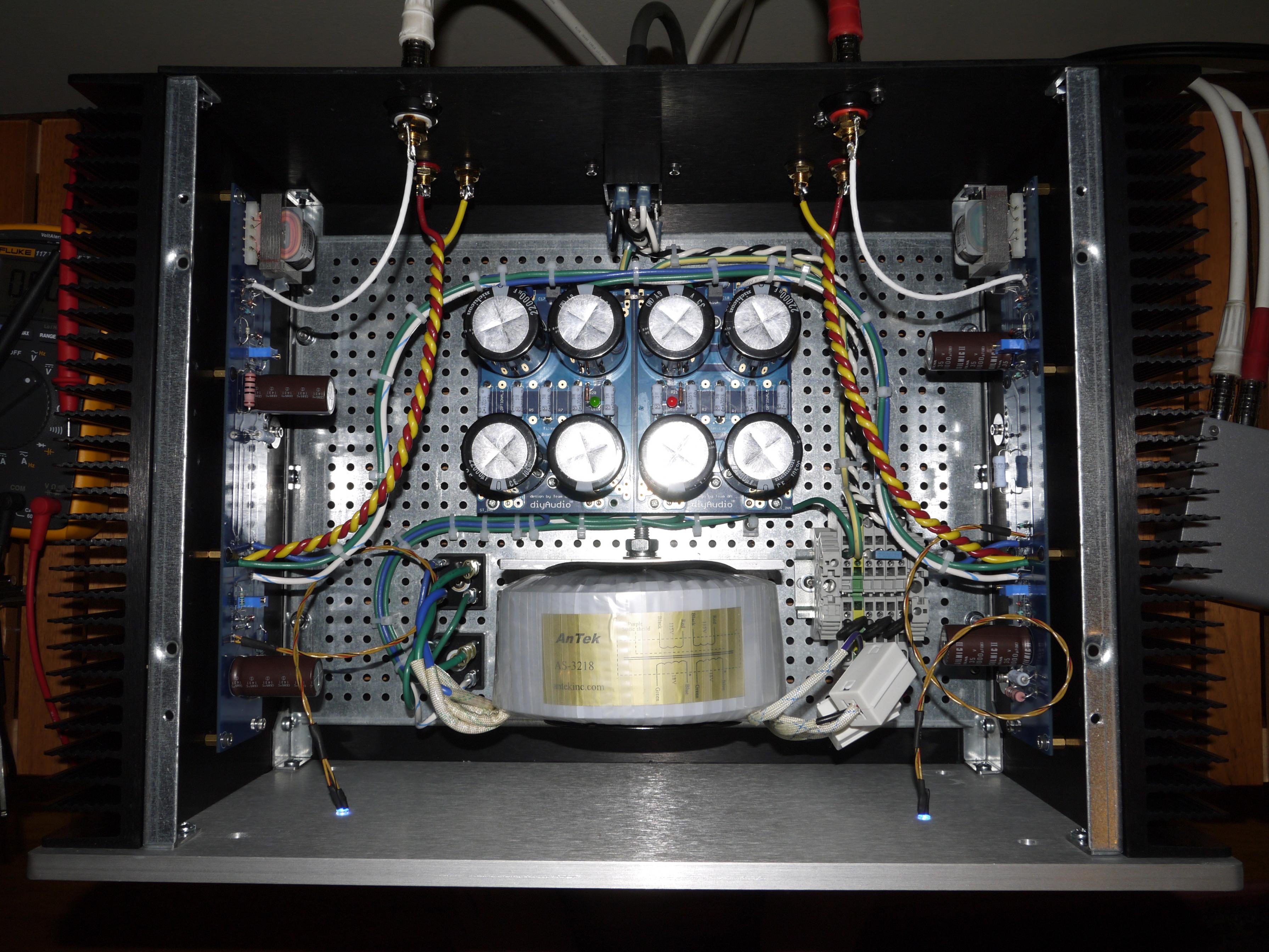

After starting a F6 one and a half years ago, I finally finished today. Power-up was uneventful and after a hour of warm-up I have it biased at 1.2 A per channel with less than a mV of DC offset.

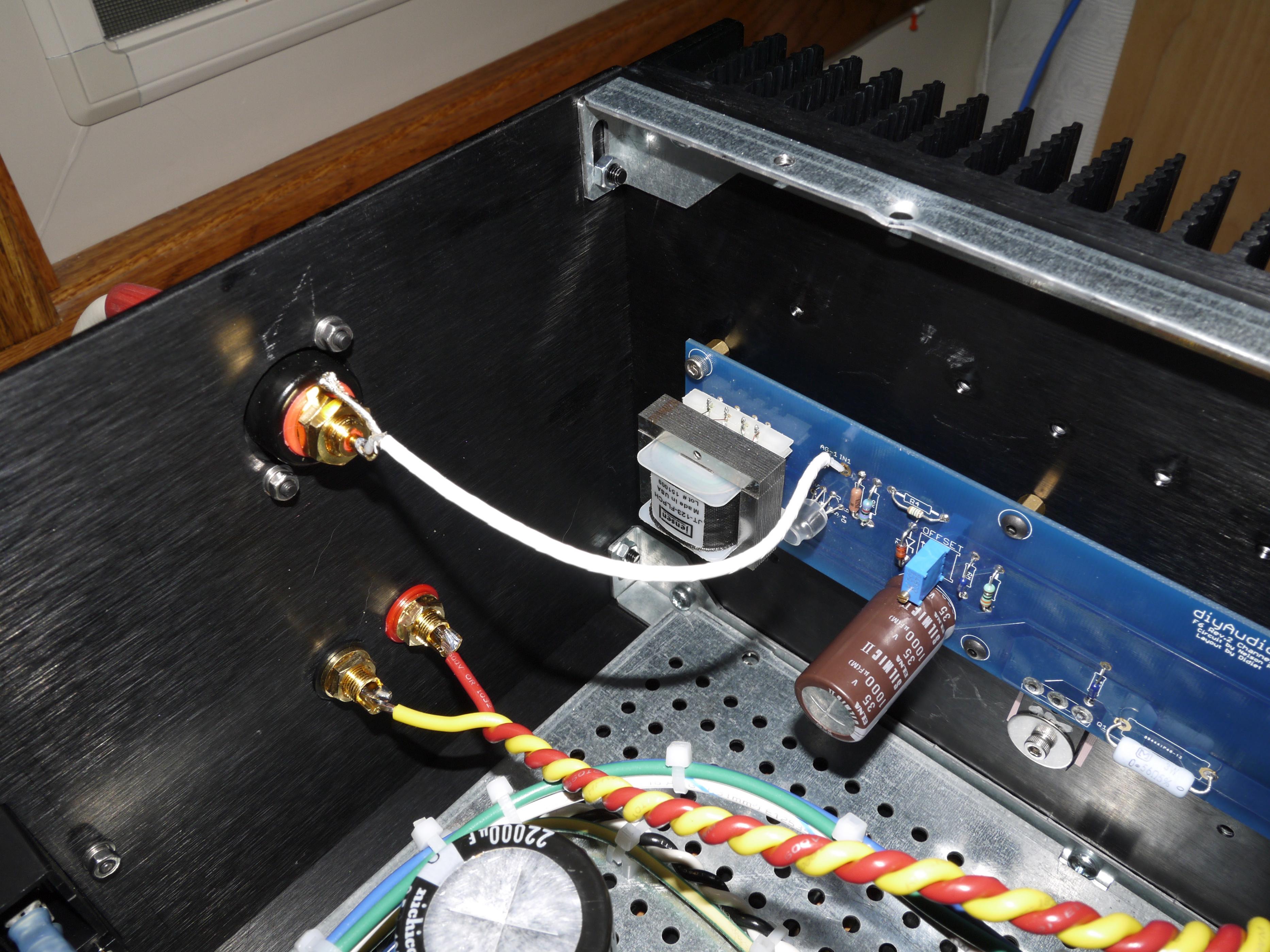

Upon hooking up to my speakers, which have a sensitivity around 94 dB/W, all was silent. But, when I hooked up BOTH RCA inputs I got hum from both channels. If I remove one input the hum goes away. Changing sources from my CD player to tuner does not change the hum. The hum is present in both channels. The hum is not noticeable during playback, only during silence between tracks.
The input wiring is coax from the inputs to the board.
Any ideas where I should look?

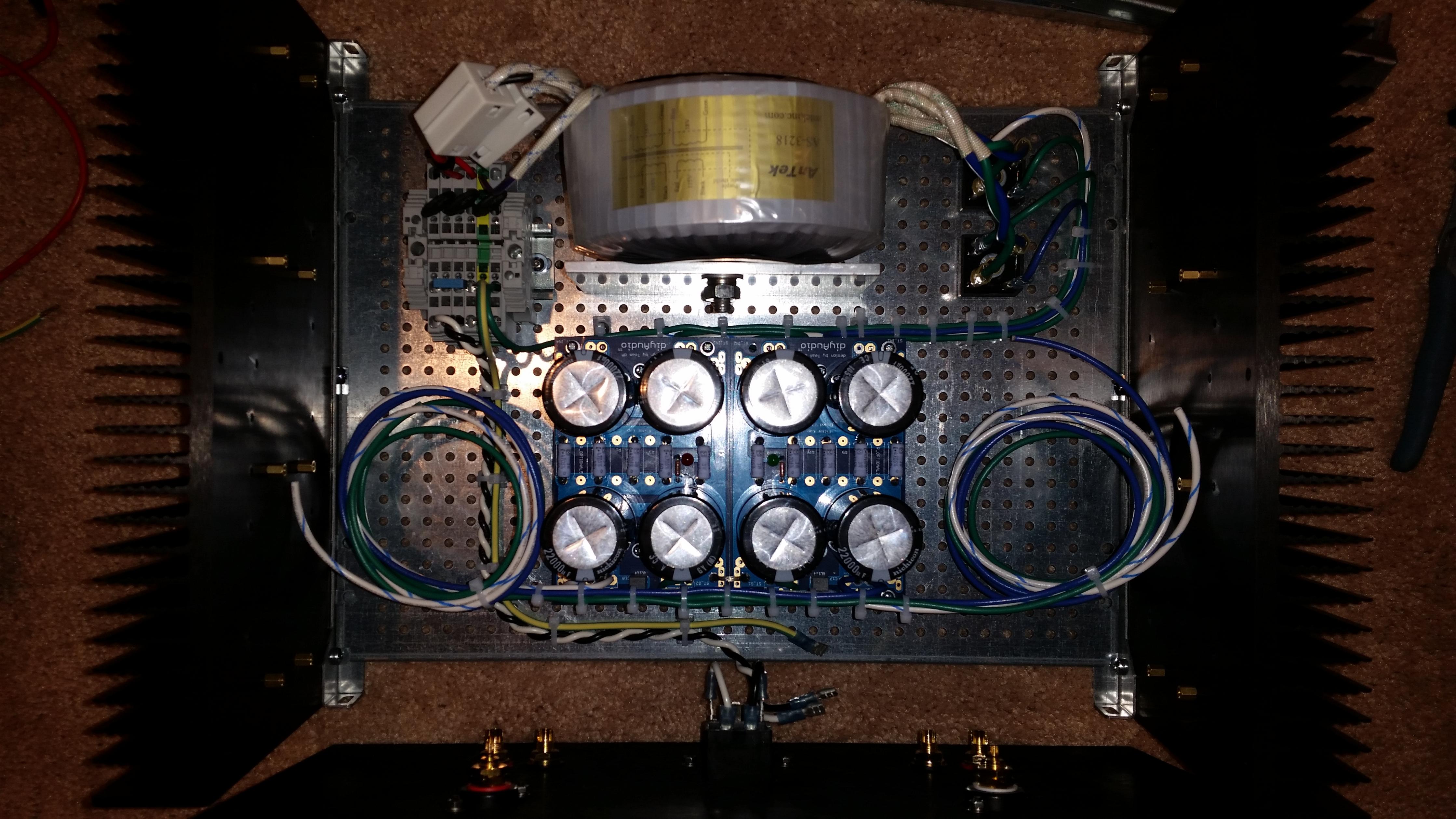

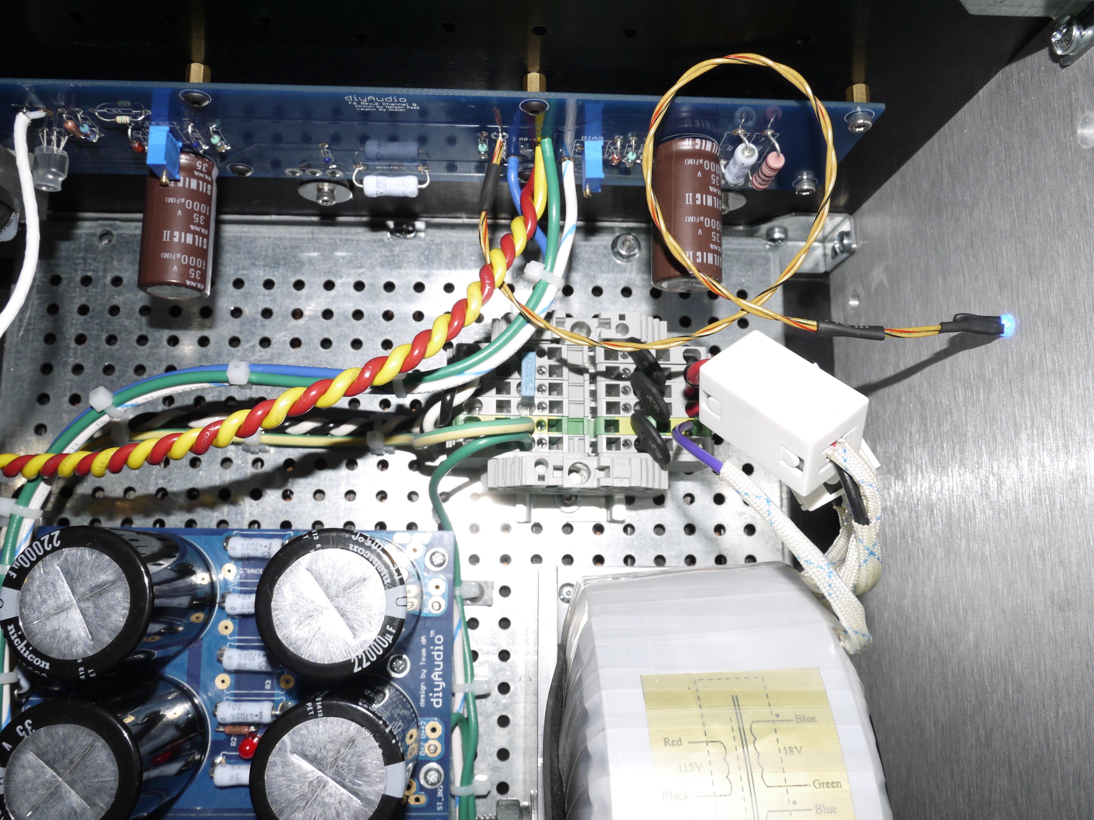

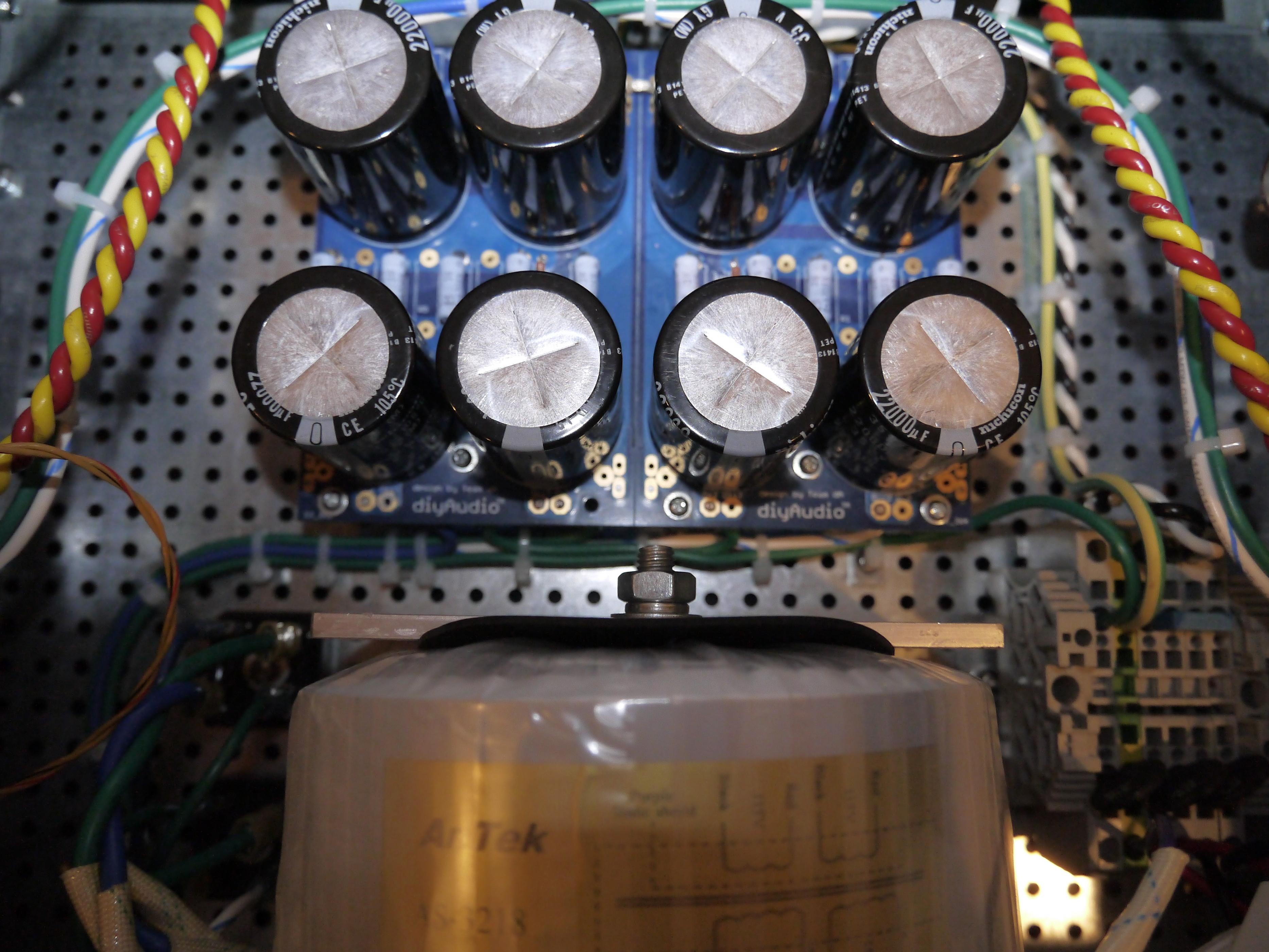

PSU Picture
Here's the PSU. I wired the transformer with industrial terminal blocks. The green/yellow block is bonded to the case. The PSU 0V is tied to it via a thermistor. The static shield from the transformer (purple) is landed directly to ground. I have a ferrite on each of the primary windings.
The PSU measures +/- 24.3 VDC.
I'll work on getting a closeup pic of the input wiring, once I'm done listening to this track. Despite the hum during silence, this thing is amazing!😀
You have a ground loop. That's why it's silent except when both RCA's are attached.
Looking at your photos the first thing I see is you have just one wire link between the 2 sides of the power supply PCB. There's holes for 6, use them all.
That, by itself, won't fix it, but it will help.
Next thing to try is attaching all the PSU grounds (Both PSU zero volt lines, both speaker negatives, and the CL-60 ground lift) into the same set of pads on the PSU. This should help the problem a lot. You have very nice looking wiring and it's a shame to cut into it, but you need to.
Do that and report back.

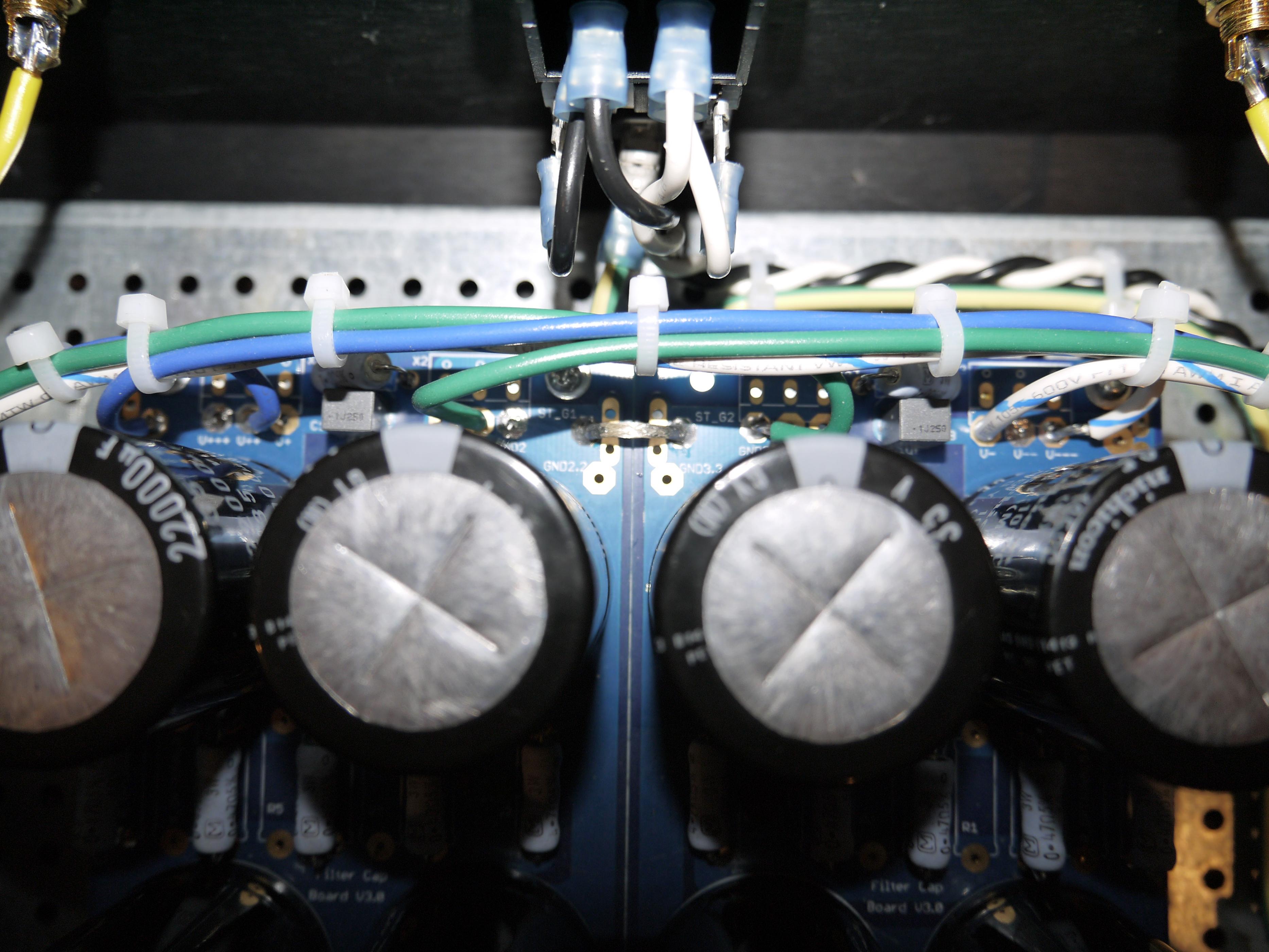

alvinlim: I lifted the static shield and found no change. I then landed it onto the thermistor lifted ground and found no change. The static shield is now back on the chassis ground.
6L6 : I was worried about that. I've attached some more pictures of my PSU. Do you think it will be necessary to move the 0V lines (green) in by one pad, or do you think they will they be okay where they are. If I have to move them in, I'll save a spot for them, otherwise I'll just use the spot for another 0V jumper.
