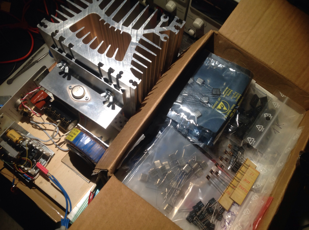

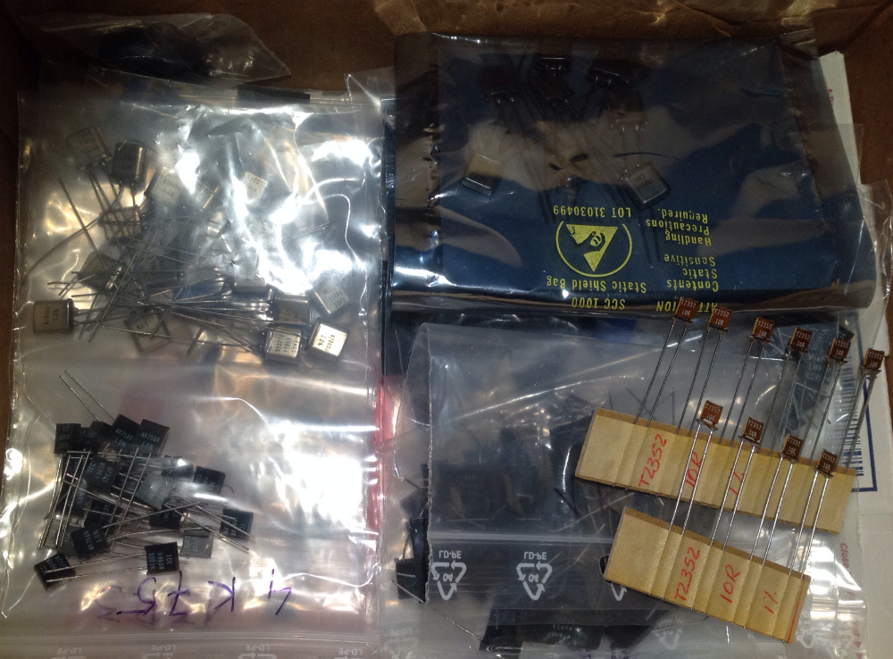

@ ilikeit
I do keep Papa 3 watts power or one Mills MRA05 wirewound at this node position ( price new ~ 5$ pcs.)
Single-ended Zen style amplifiers are most transparent in experiments
about passives and his infuence on audio reproduction.
All Z - foil is not garantie of extraordinary sound.
Mix with non inductive Ayrton Perry wirewound technology and metal Dale
can bring some more equilibre, but again you must try this in real situation.
Solder long pieces of wire " anntenas" to F6 pcb and that way you don't damage by soldering
or desolder heat many times for sound tests.
Resistors data sheet is not all....
Excellent 0.47R source resistor MPC74 cost ~ 1$.
Most of my resistor collection is from second hand market at 30 % max of initial price i find on web auctions.
Crazy good quality stuff for "only
Relax , non stress and joy & pleasure in mind make diy build amplifiers sound fabulous imho. Have fun
