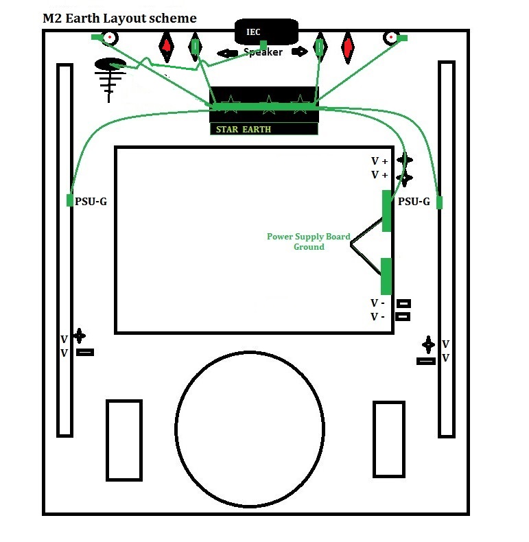

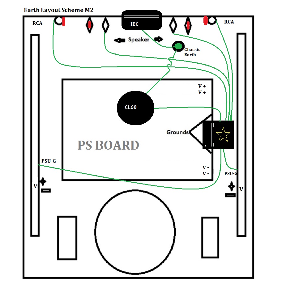

After organising the earth to a star earth configuration, this resulted in a slight reduction in hum
This was suggested to me as a logical next step, and that was to romove the toroidal out of the chassis and hook it up via long wires
Doing this was a successful test as the hum vanished
So I ordered a different brand toroidal with an RF shield band an installed it
Now I have silence - a church mouse is louder
Then star earth is your next step
I started off with the drawing on the left first
The drawing on the right is the star earth scheme that I use now
Hope it helps

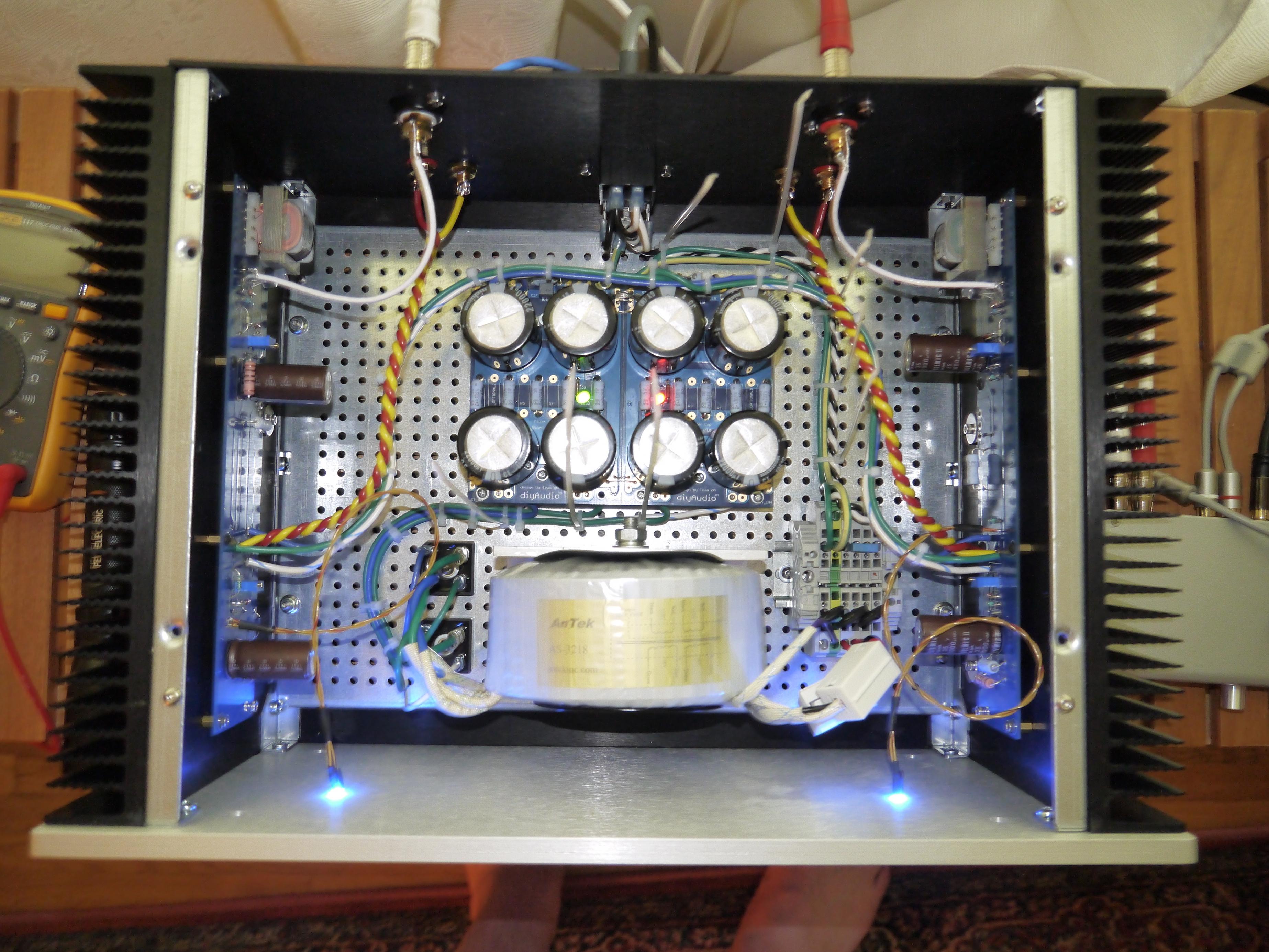

Jim - I tied all the center pads together and moved the right channel ground and the thermistor lifted ground to the pads next to the leftt channel ground. I powered up and the hum is gone! I think I'll leave the input shields as is.
Thanks to everyone for all your help, time to listen to the music!😀
Thanks Nelson for sharing with and supporting the community.

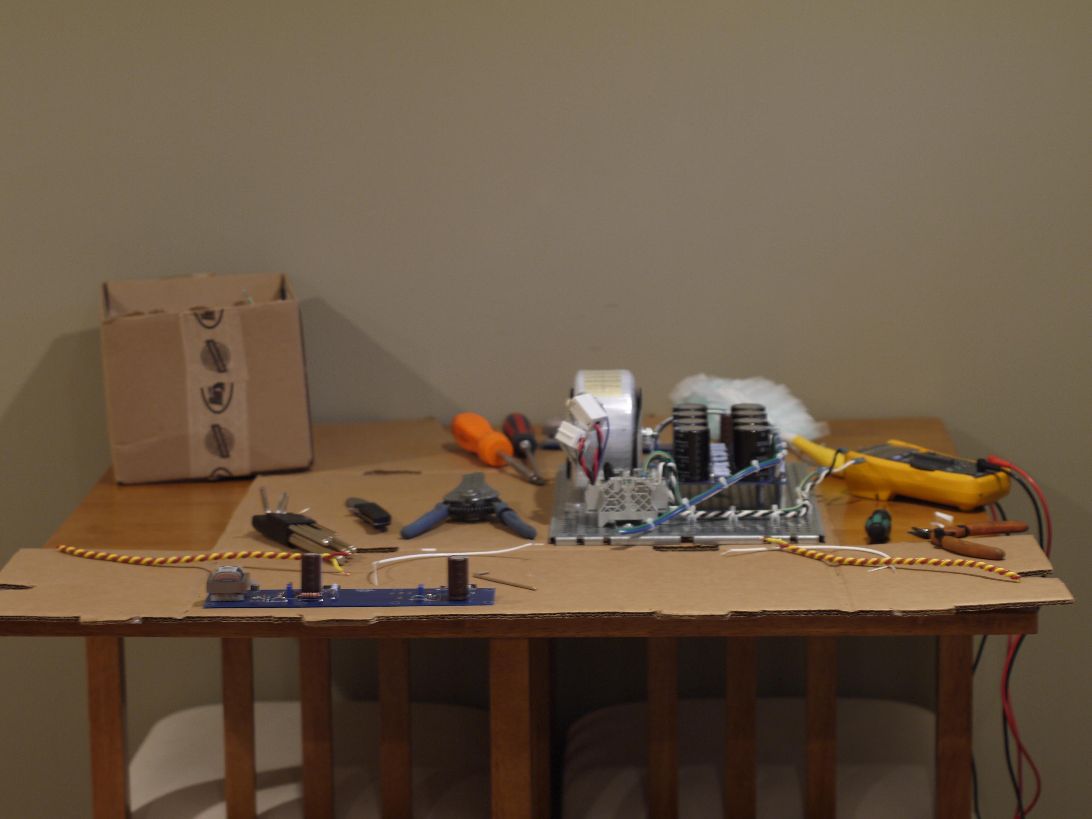

I've also attached a picture of where I started at yesterday morning. It's amazing what one can finish in a weekend when the wife is gone...
